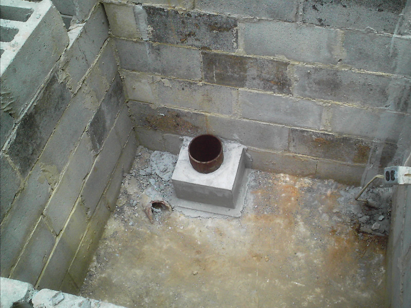

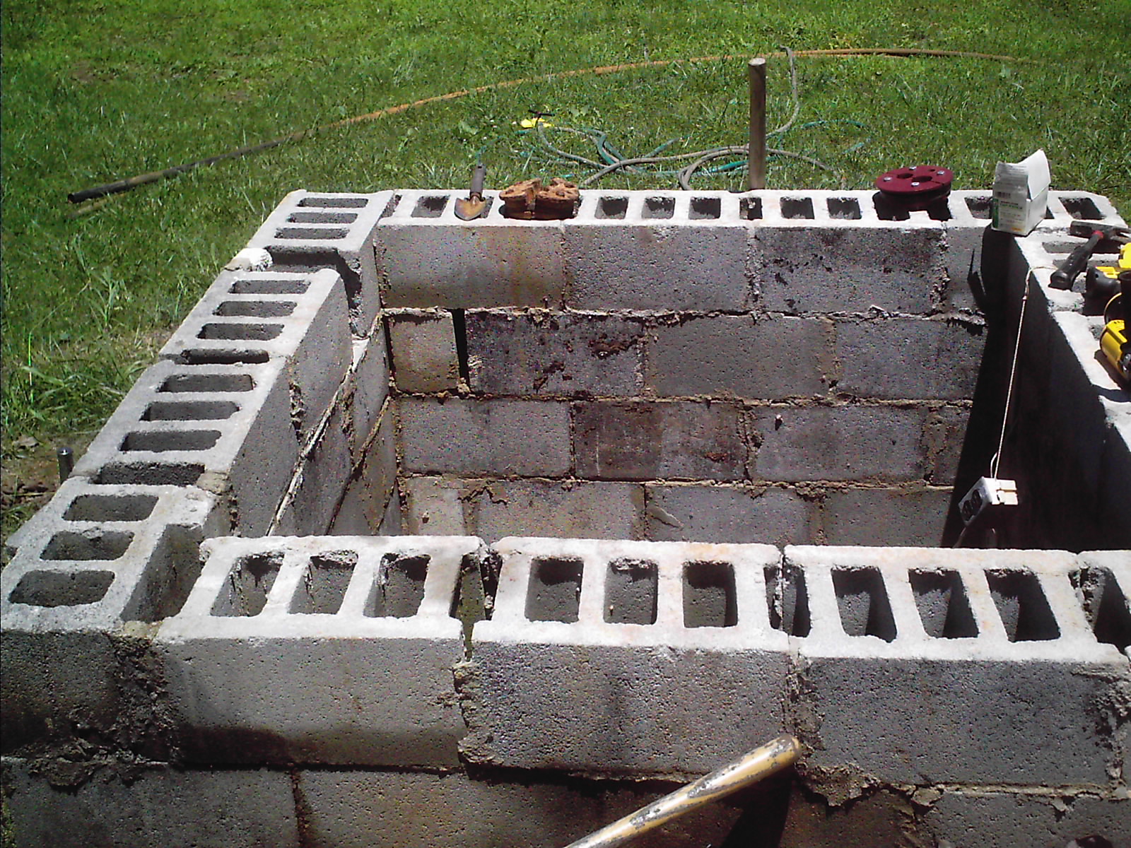

Hanni came up with what I feel is the best idea, and that is that we will make it look like a wishing well, but first, as with so many other things around my house, I have to make it work first. And as with so many other things around my house as well, it is not how it appears when I first look at it.

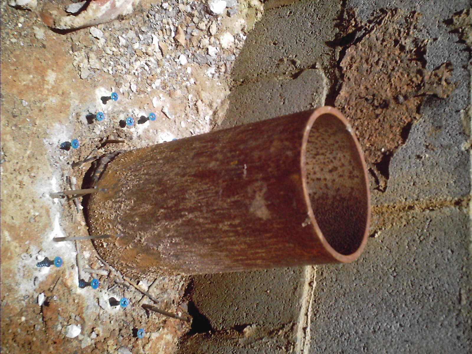

I did not get the "before" shots I should have, but I thought my pump was sitting on a mud floor and that the well head pipe was cut off lower then the mud of the well house floor. The top seal was crooked and did not fit in place and the well casing was cut on about a 20 degree angle.
Initial plan was to remove pump, pull up lines, remove well pipes, dig out bottom to below well casing, cut casing square, fill bottom with rock, reset pump on clean gravel / rock, fill in cinder blocks with concrete etc.
So, real world is cut out pump and remove and go to start digging out bottom only to realize that bottom of hole is concrete. :confused:
Then realize that bottom of lowest part of angled well casing is below concrete surface :mad:
Measure pipe, yep, 6" no problem. Get a 12" peice of 6" pipe and add too it..... Well get a peice of 6" pipe and realize that it is bigger then what is in the ground (slightly) then wonder which is correct for the well cap seal. Fortunately, what I have is correct and fortunately I have a welder :D
So, chip out concrete around pipe enough to lay in hole and weld, then weld new pipe in reaching down through pipe to weld and laying upside down in hole to weld the base................... No pics, not a happy guy.

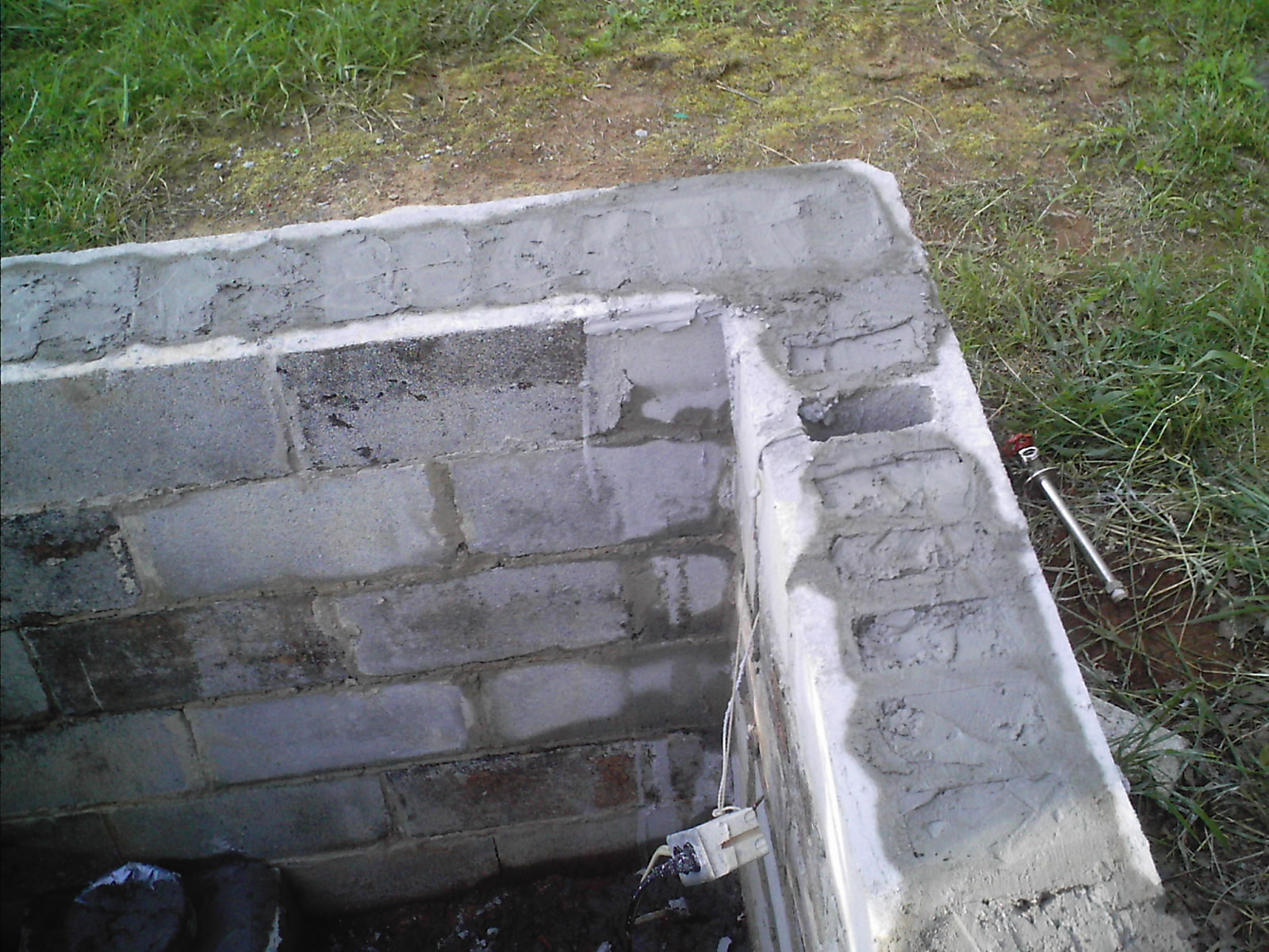

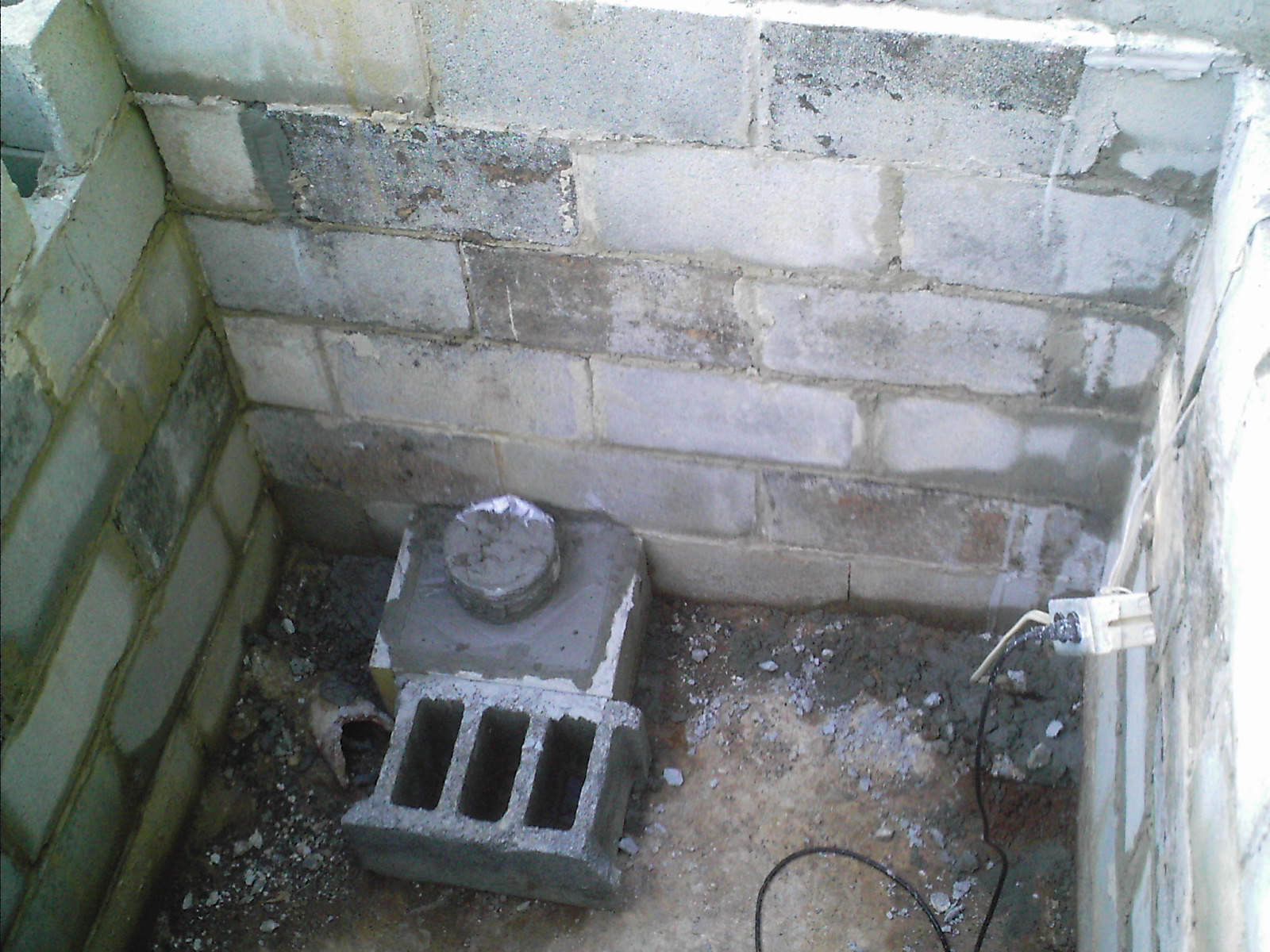

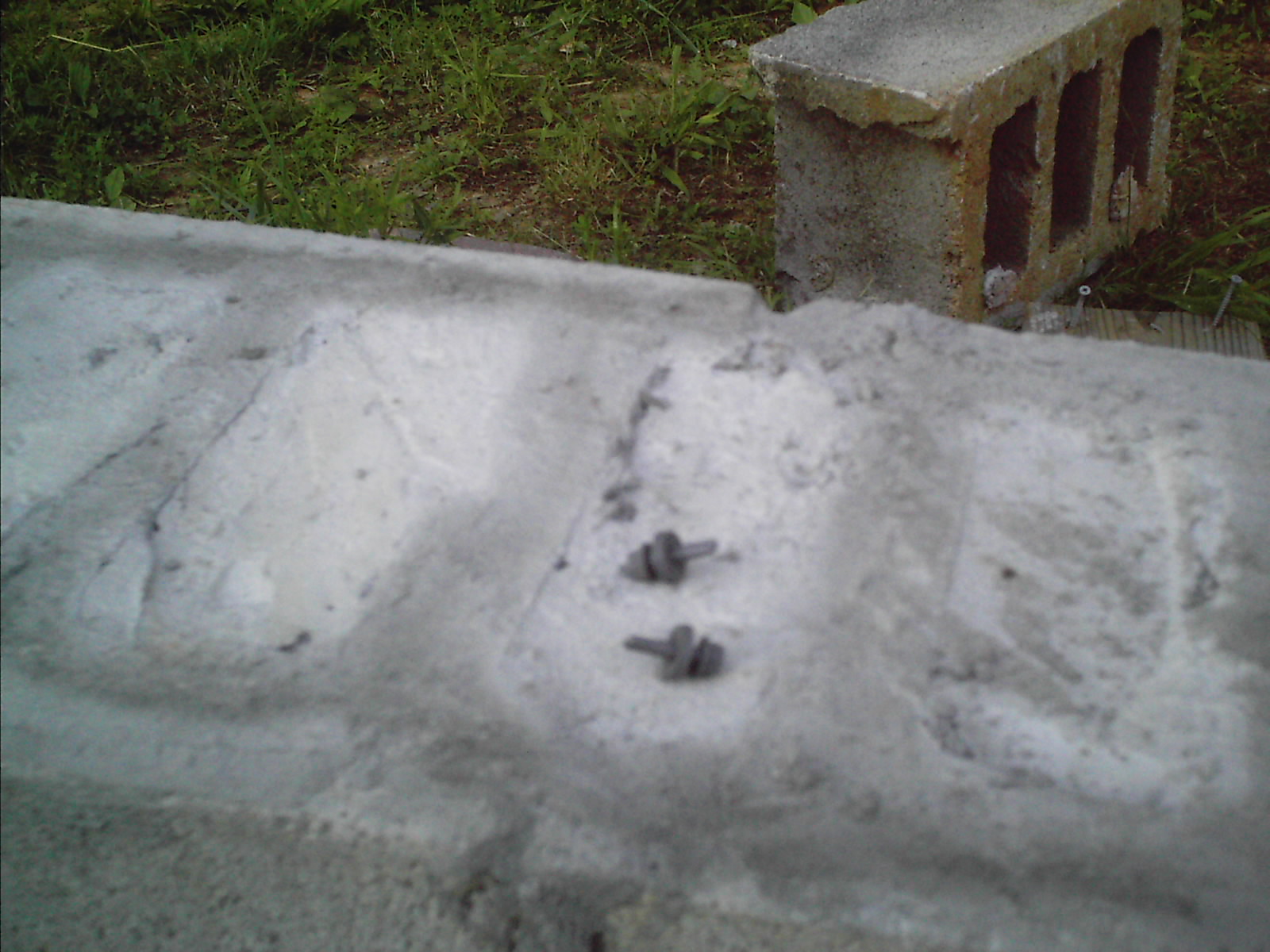

Then put in some tapcons around base, and form a little raised area to keep groundwater away from well head.
Then form up a little pour and pour and then fill up cinder block walls so snakes are not quite so welcome.
Use the extra mortar mix laying around the house from when SWMBO does landscaping jobs, just add gravel as filler.
Tractor was used to haul the concrete back and forth from the mixer location to the well house. :D

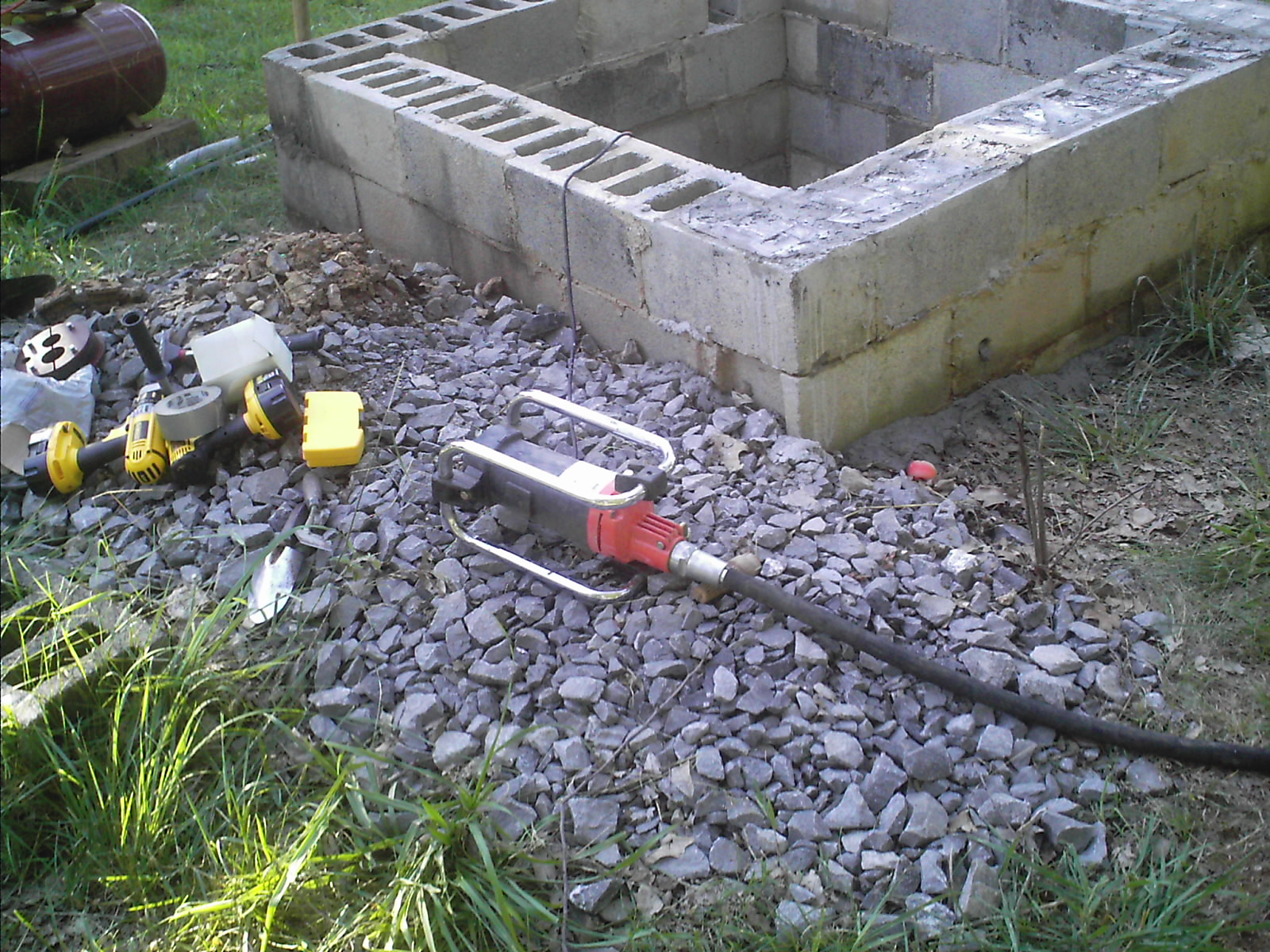

Oh, and also in my "house that China Built" theme of things, man, this concrete vibrator is just hard to beat when it comes to doing work like this.

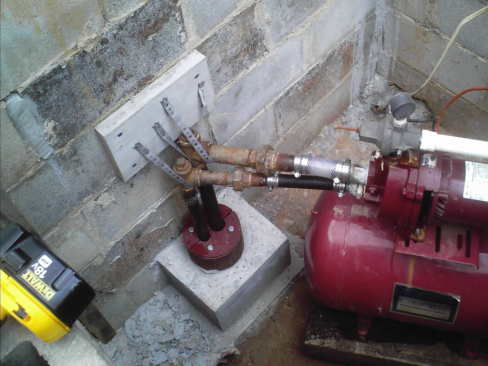

Well, going along in the standard vein of Alan Works on his house, everything must be done at lease twice.
Lets see,

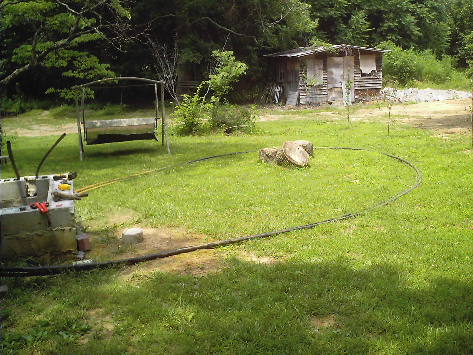

Nice picture of the cleaned up hole, and the extended well casing pipe and concrete reinforcement so the top of my well is not under muck.........
A nice picture of my drop pipe, laid out. Went ahead and put a new foot on it while I was there.
Nice picture of little man Dean helping Dad out using Lil.

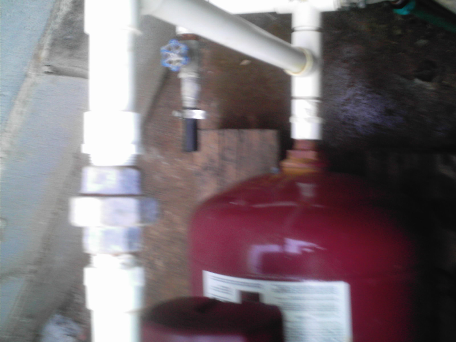

The pump in, everything hooked, little chunk of wood to mount the plumbing strap too to hold everything up etc.
So you get it all hooked up, only to find that the 1 1/4 line that someone had sawcut before me, that I thought I could get away with re-using because it was not leaking, when you cleaned everything up, and pulled the mung off from it, now leaks :(
Oh, and now when everything is pretty dry in the hole, and you can look a little closer, you find that the back of the tank is wet :confused: and look, there is a little spot of rust there where it looks wet,,,,,,, Then you scratch it with your fingernail and the water starts shooting out the little pinhole rust spot leak. :mad:
You conjur on it for a minute then remember that when I moved the carport, I had to buy some little self tappers with neoprene washers, so install a washered tapper in the hole, Little silver head near the end bell of the tank. :rolleyes: Certainly not a permanent repair, but for now, on this one, it will just have to do.
I am finding LOTS of little leaks throughout the pump system, and as this is supposed to be for irrigation only, I will probably just replace the entire unit with an irrigation style pump, but for now, that will wait.
