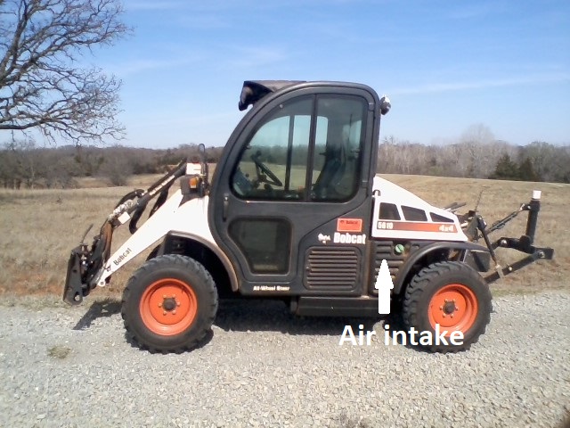

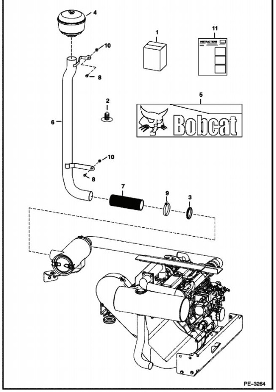

Rolando hasn't been on here since 2013, But I saved this picture of this Toolcat 5610 because I thought I might need a pre-cleaner some day:
And a drawing:

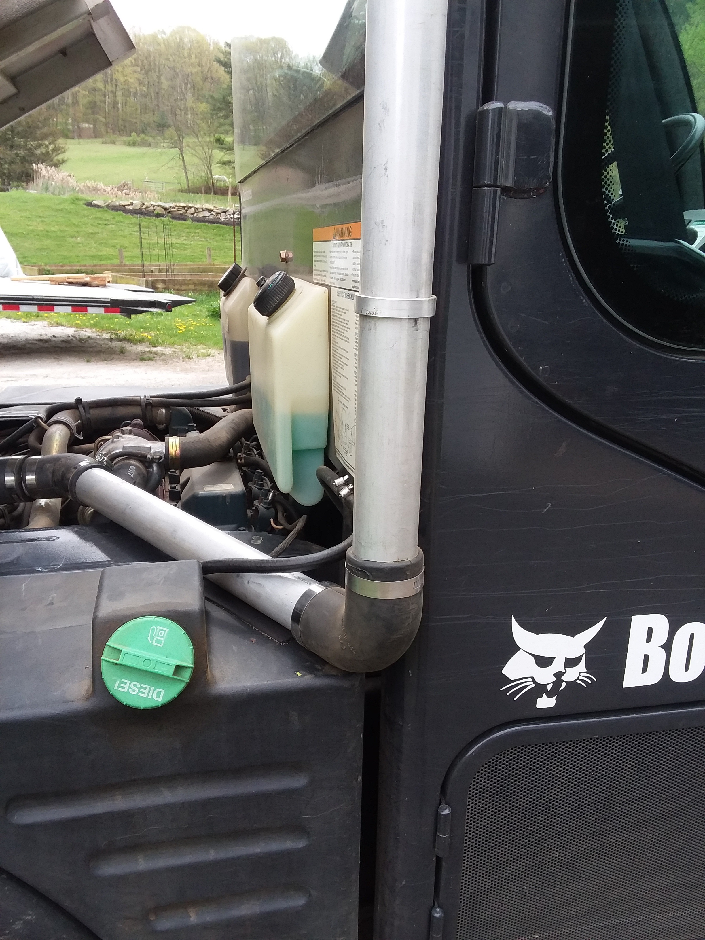

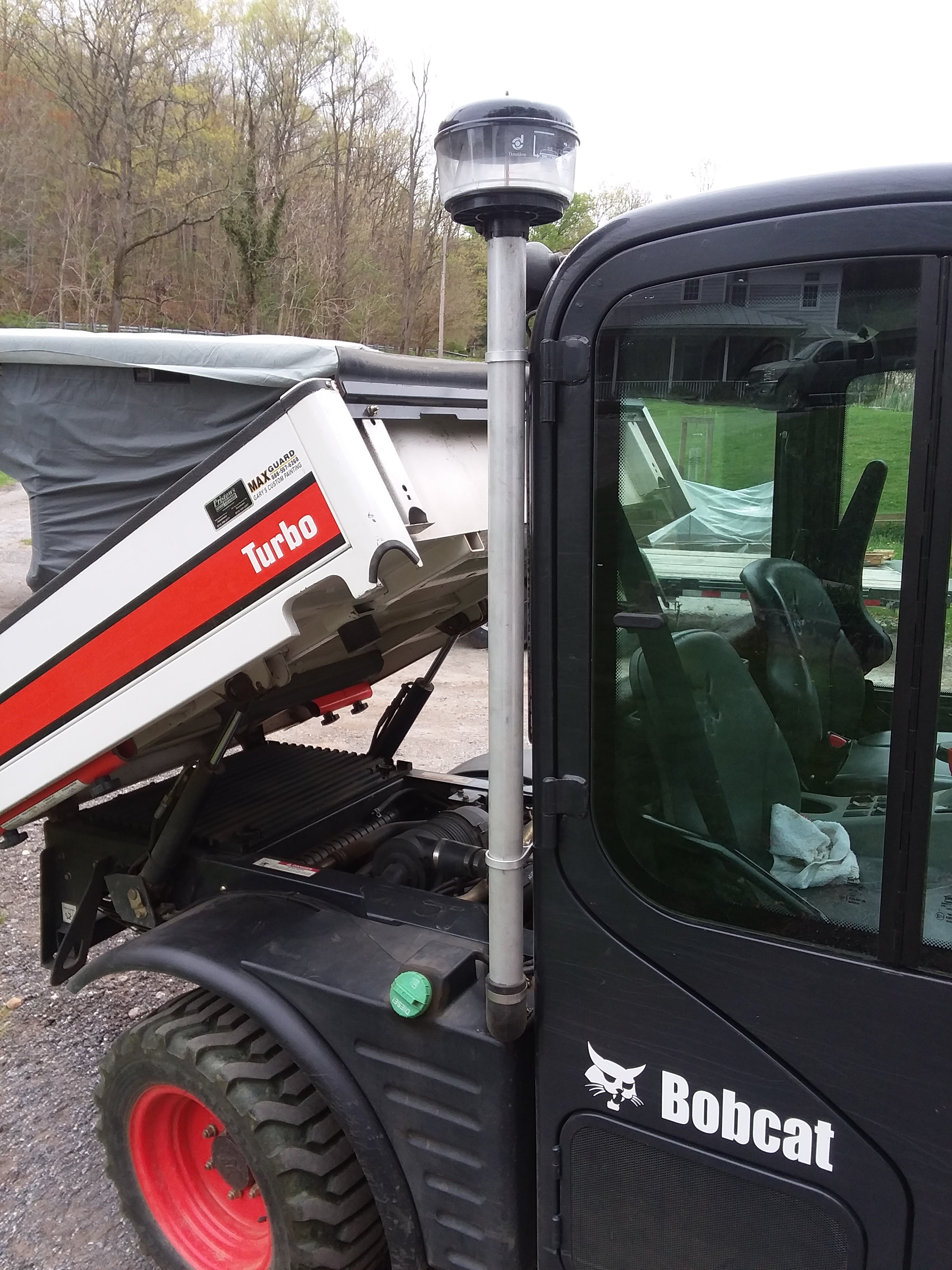

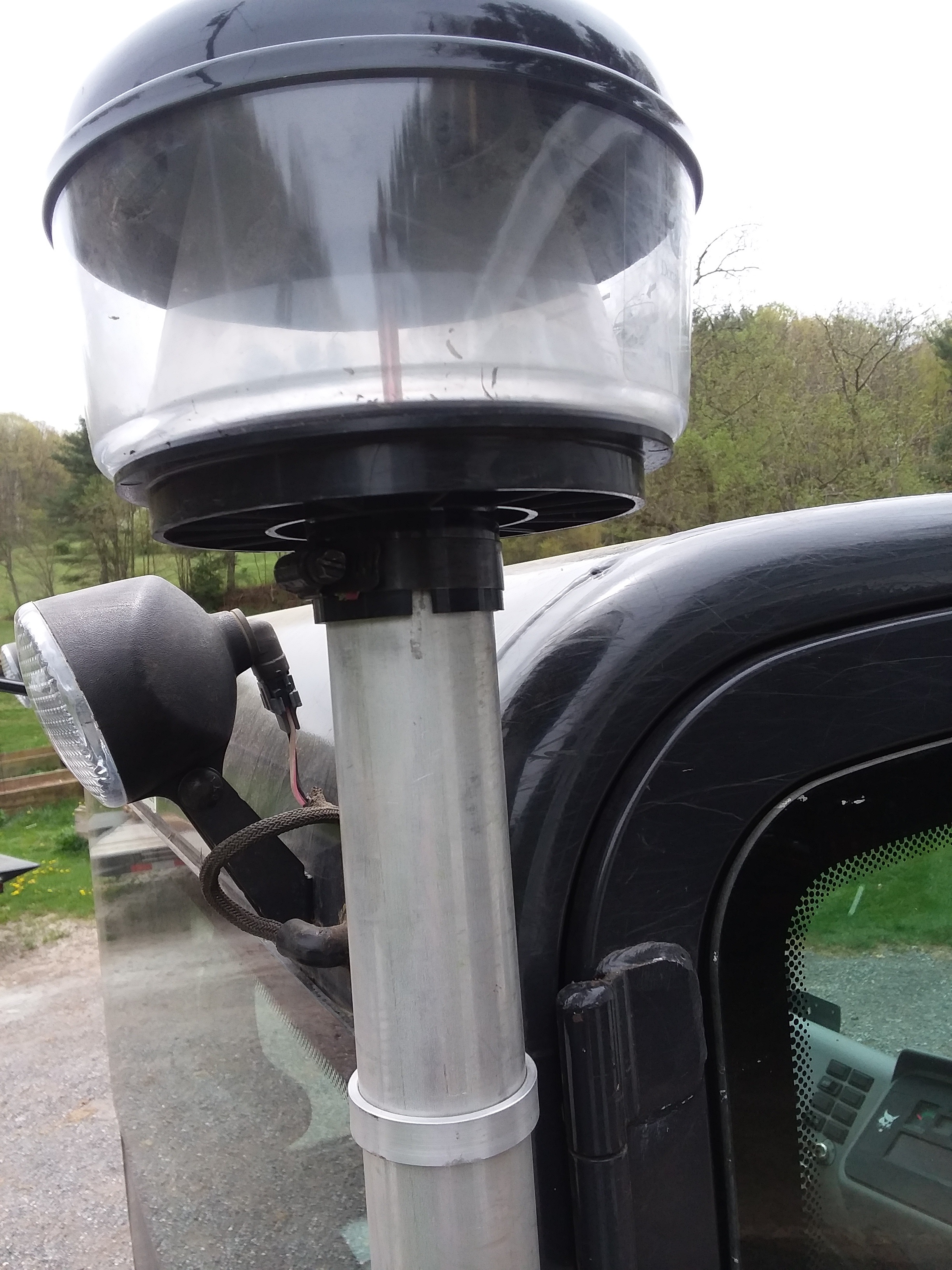

thanks for the help but I got it figured out. thought there was some special tube to get from the cleaner to the outside of the frame but not needed. 2-1/2" aluminum tube fit right between the frame rail and the bed along with a couple rubber elbows. my older machine will not work with the kit above as that is a 5610 and I have a 5600. my cleaner is now mounted on the passenger side of the machine. I have $110 in the whole deal and $80 of that is the pre-cleaner. been running for a week now with the set up and it is working like a top. if your interested I can shoot some pictures. Mike

CAT 1.jpgCAT4.jpgHere are a few pictures. one adder I did have to cut the corner of the dump bed. used a 3" hole saw and got a nice round cut. put some molding on it to protect. enjoy. CAT2.jpg
/ air intake pre-cleaner #12
Nice. I do a lot of mowing with my 5610 and have been thinking about a pre-cleaner for it. I really dislike the factory pre-cleaner coming out and going up the side of the cab. I've thought about doing something similar and going up the back corner of the cab just right of my rear work light. It would require notching a hole in the top of my rear hood and maybe moving the hood handle on that side. You've given me some ideas.
/ air intake pre-cleaner #13
was really not that tough. have no clue why some of the old threads show bobcat taking 4 hours to install. don't think it took me that long from scratch. next is a headache rack for the bed. would not enjoy paying for a new rear window.

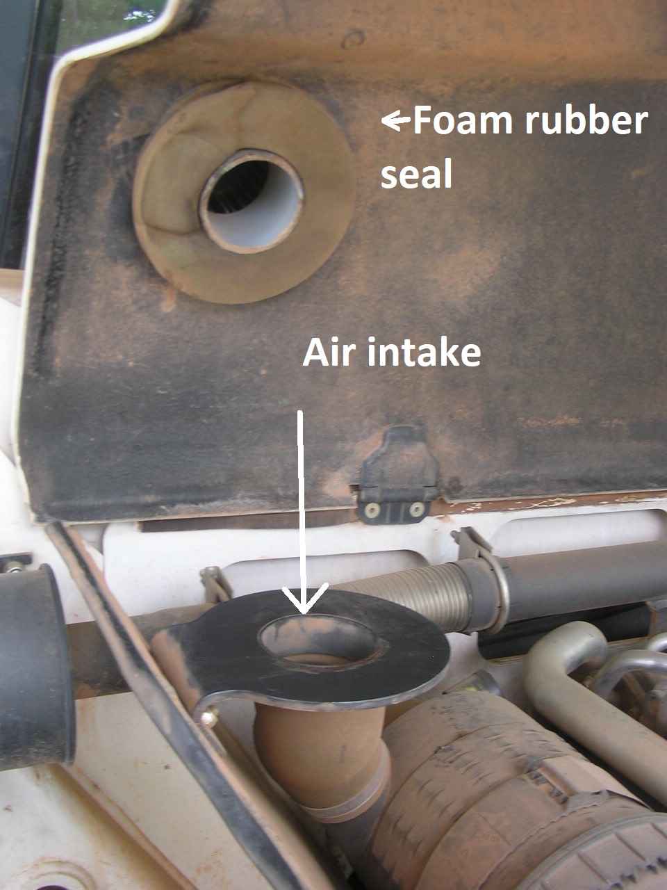

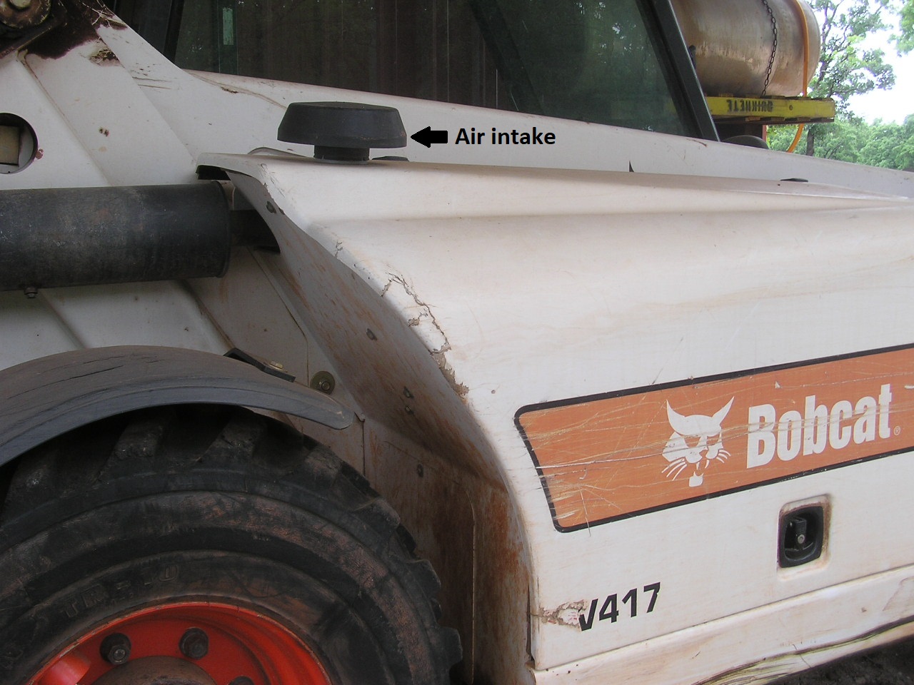

Here is another idea for your pre-cleaner.
This is the V417 air intake on the hood:
With the hood open:
This is the Toolcat 5610 air intake louvers on the left side above the battery:
The idea would be to put the two piece air intake into the the storage well in the 5610 hood. :thumbsup:

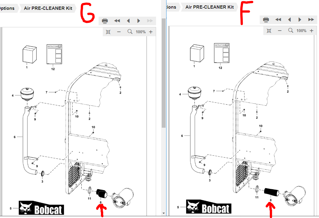

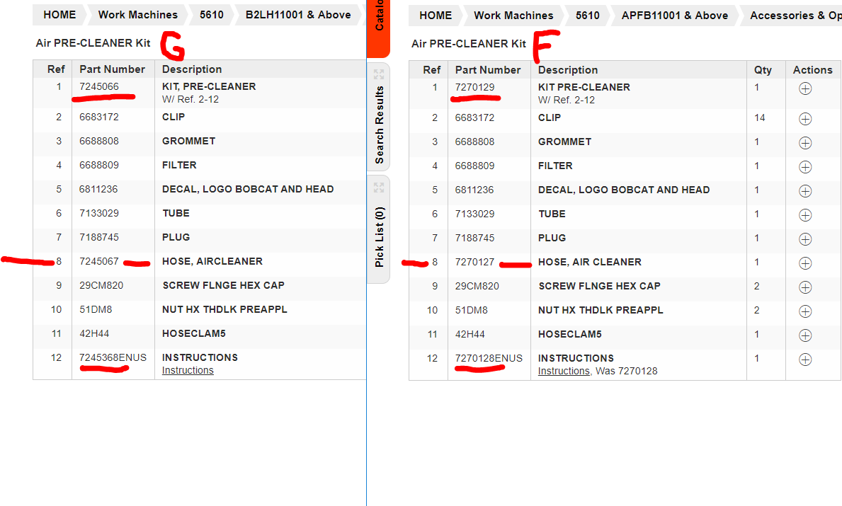

G series pre-cleaner # 7245066
/ air intake pre-cleaner #16
Thanks for the part number. Looks like the hose is different for the G Series:
Right click these to open bigger in a new Tab .
/ air intake pre-cleaner #17
Thanks for the eXtra info X. If I'm doing a bunch of mowing in dusty conditions, it might be worth getting one of these. By the looks of it, I'm just worried a branch will take it right off or bend those brackets. I just wonder how tough it is. I do know I'll be busy trimming up the trees because this is taller than the Boomer was.
