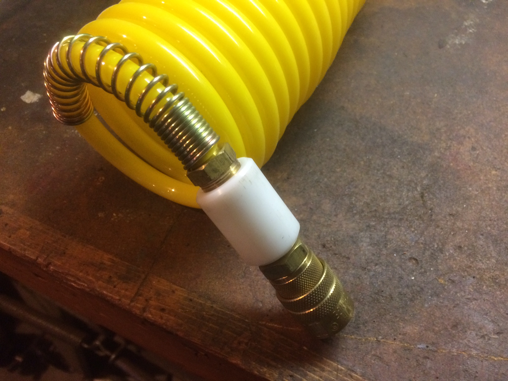

Have had this coiled hose around for several years but haven't used it because the end fittings are 3/8" MPT which don't play well with 1/4" quick couplers. So I made an adapter out of 1" delrin but wondering about safety.
The OD of the 3/8" internal pipe thread is about 0.700" so that leaves about 0.150" wall thickness with the 1" OD delrin. I understand and appreciate all the caveats about using PVC for compressed air lines but wondering about the worst possible scenario with regard to the delrin adapter fitting.
I realize that metal adapters are available but just trying to minimize the weight at the ends of the hose.

npalen, I'm sorry I sort of took this off track from your question. It looks like you did a nice job making that fitting. If it were on mine, I wouldn't be worried about it. I would expect any failure would be a crack and leak, which wouldn't be a safety concern. I'll bet that outlasts your hose though. :thumbsup:

I'll go with the homemade adapters and agree that they will probably outlast the hose. I figured someone was going to say that plastic fittings were a death warrant on air lines.
   / Air Hose Fitting--Plastic OK? #10
I worked in a big factory using brand name air hoses and very good couplings. Over the years I saw or fixed a few hundred of them that either were ripped off, flew off, knocked off etc and hoses just started flying around. Nobody ever got hurt, not that it couldn't happen.
I don't think I would use that system for anything over a hundred psi though. If you got a heavy duty high PSI compressor I would be really careful with that setup.
