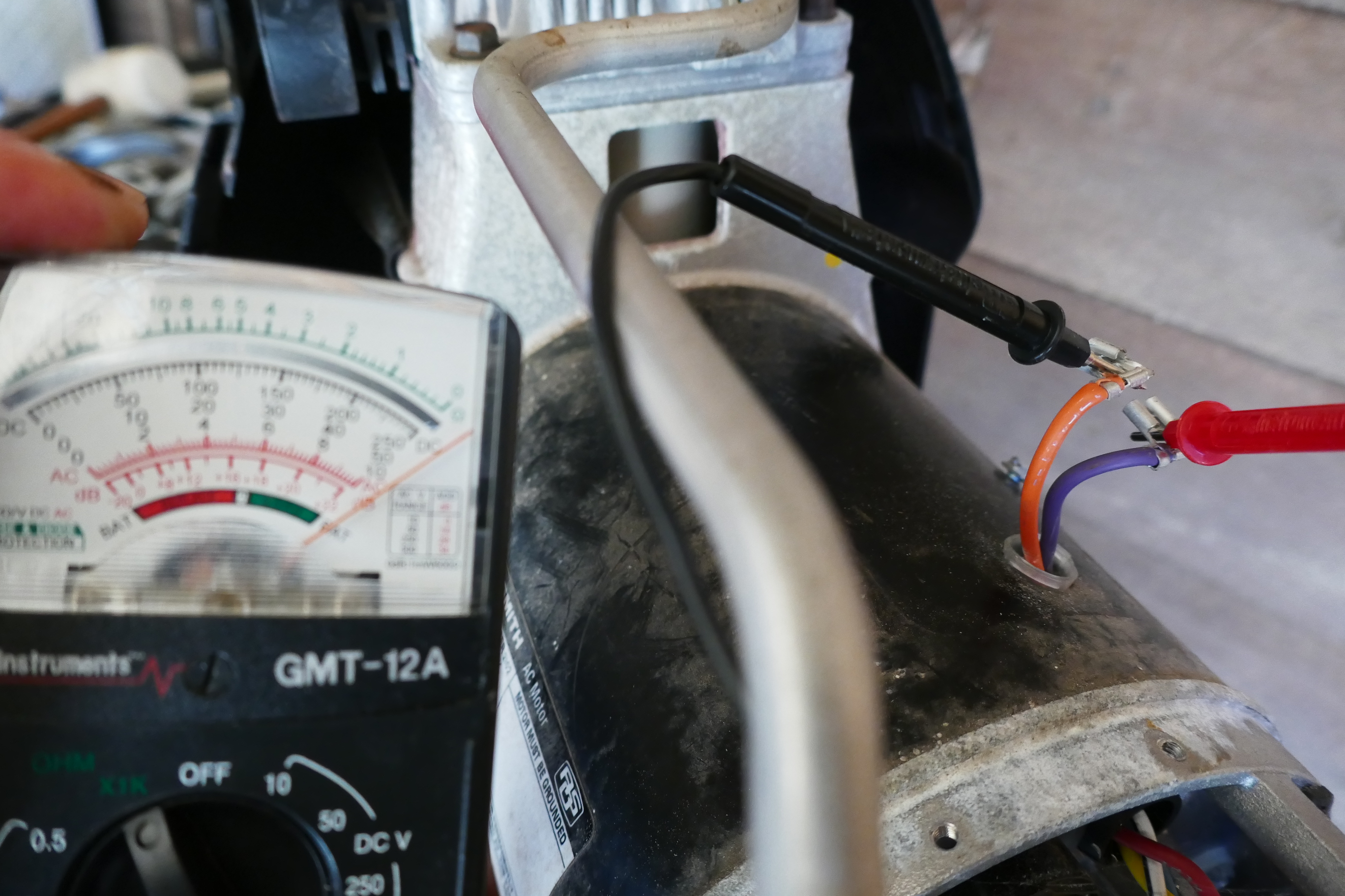

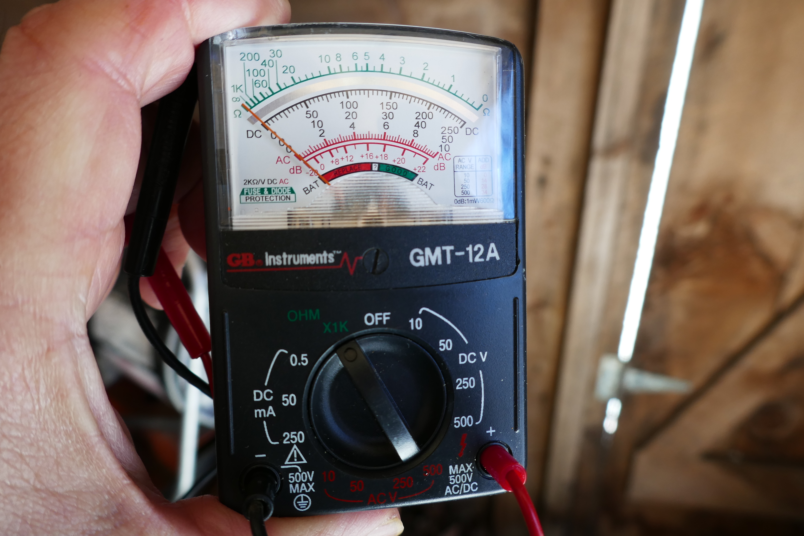

The winding should measure high resistance against the green wire. If it is not the case then the motor is shot (unless you see some wire insulation rubbed off and the conductor touching the body of the motor). You need to describe what wires you put your meter leads on, what function and range you used and what the meter show. Otherwise it is hard to figure what you are doing.

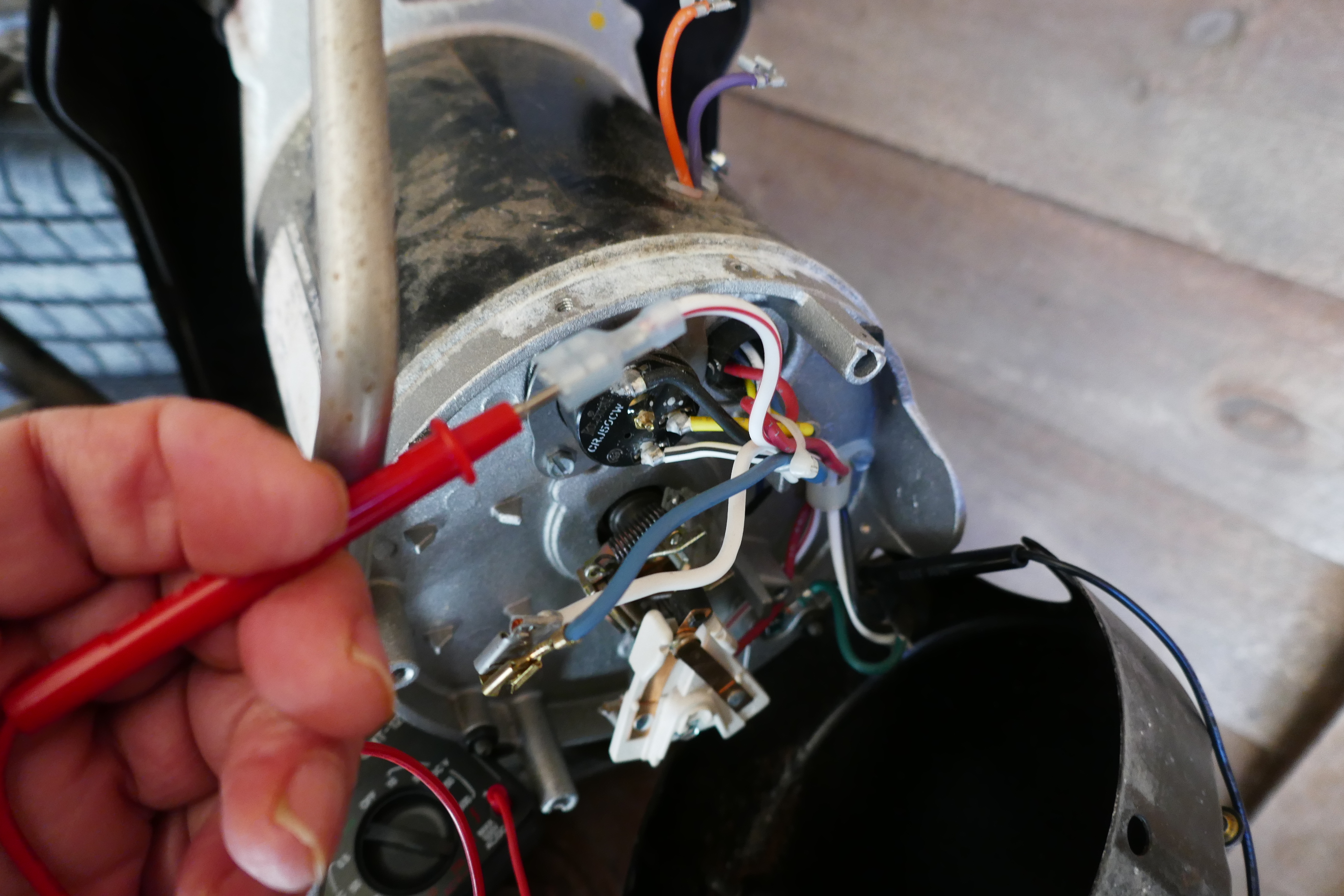

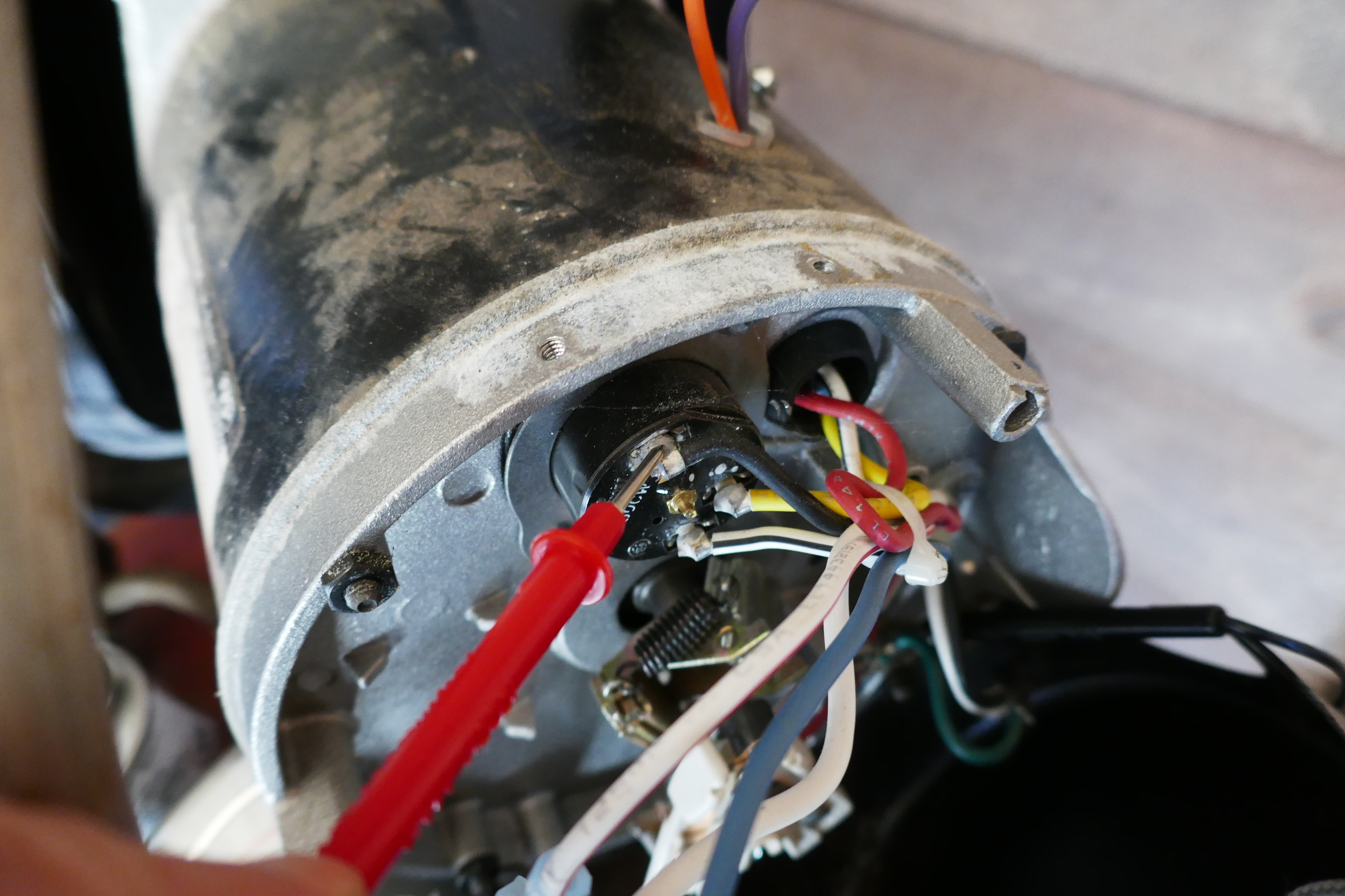

Here are some pics: First the meter as set on Ohms. I grounded the black lead to the green wire in the motor first. I then touched the output wire from the start capacitor. Nothing or no needle movement. I then touched the black wire with the red meter lead while meter was grounded. Nothing. I then touched each run capacitor wire while meter was grounded. Nothing. I then touched the two run capacitor wires and the needle went to zero. I then touched the green wire and the motor casing: the needle went to zero. All other touches needle stayed on infinity.

If its blowing breakers, that's an overload. Bad caps would probably just cause it to sit there and hum the motor, not trip the breaker in 3 seconds.

Then the motor is suspect and probably has an internal short.
Pull the motor and take it to a local motor repair shop and ask them to bench test it if it doesn't cost too much for peace of mind.

Then the motor is suspect and probably has an internal short....ok
