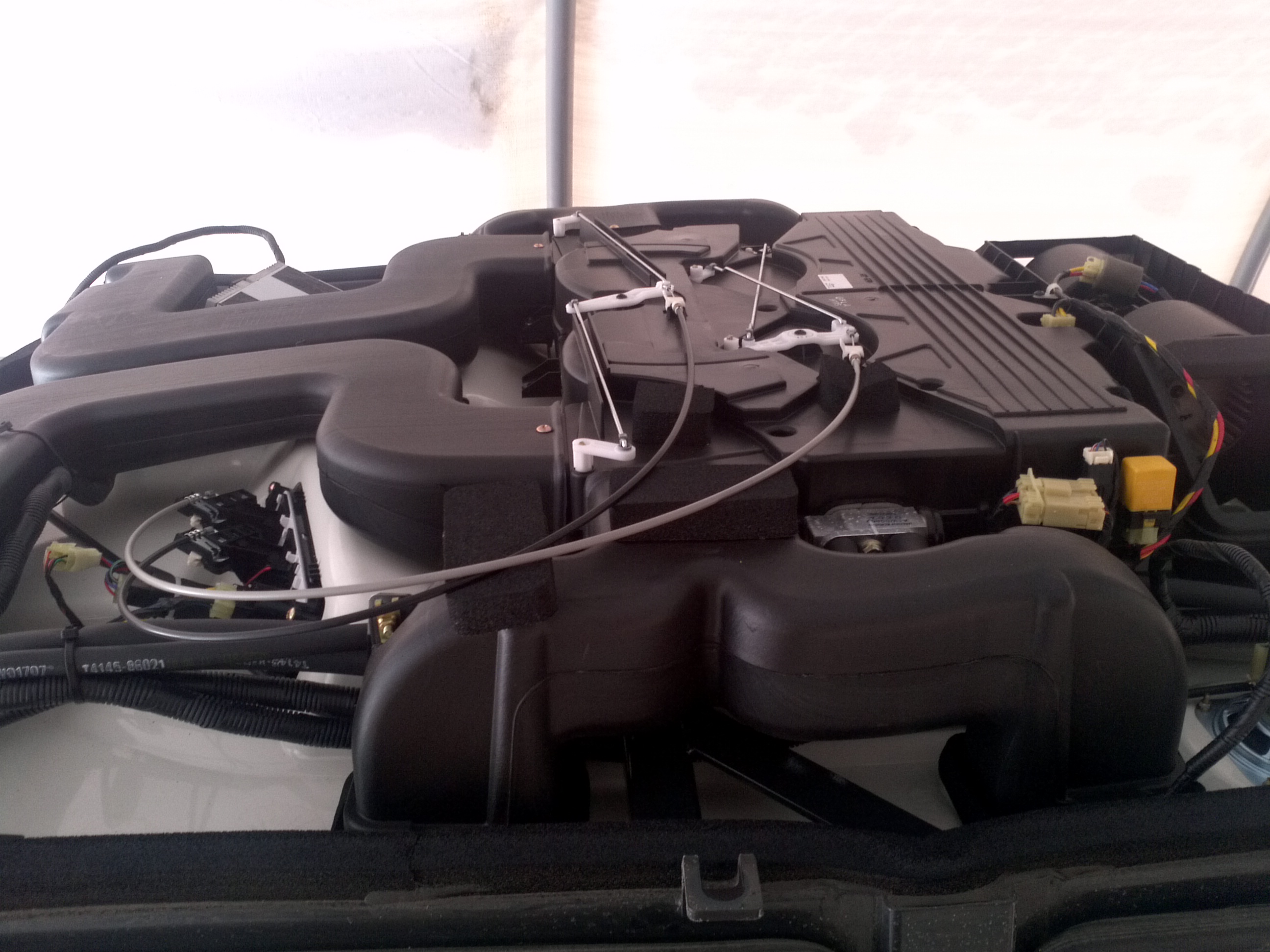

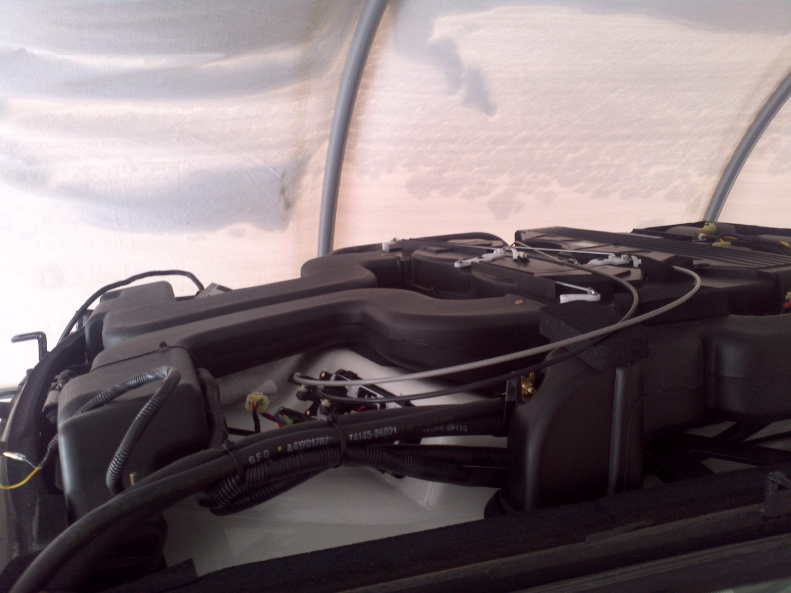

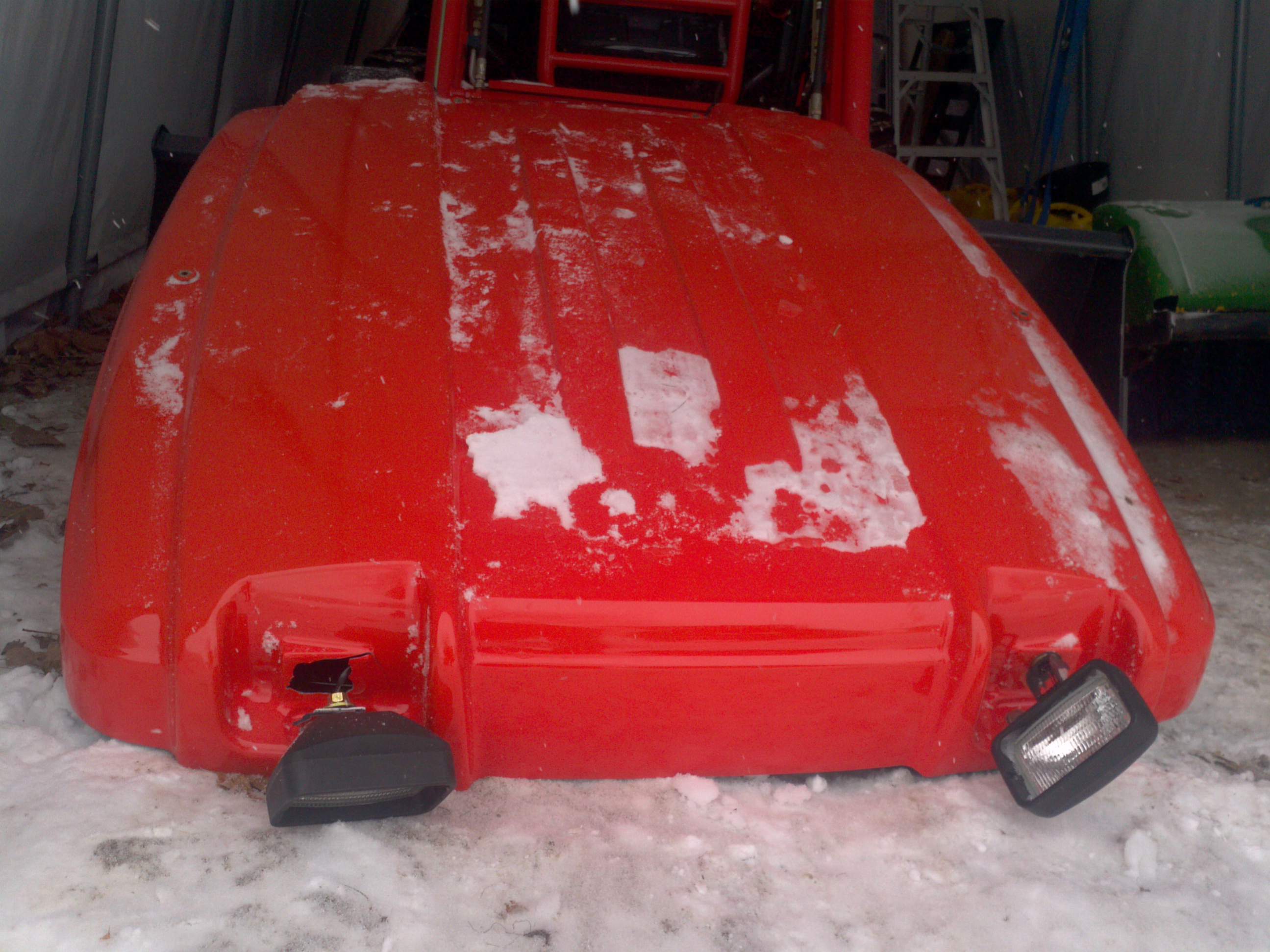

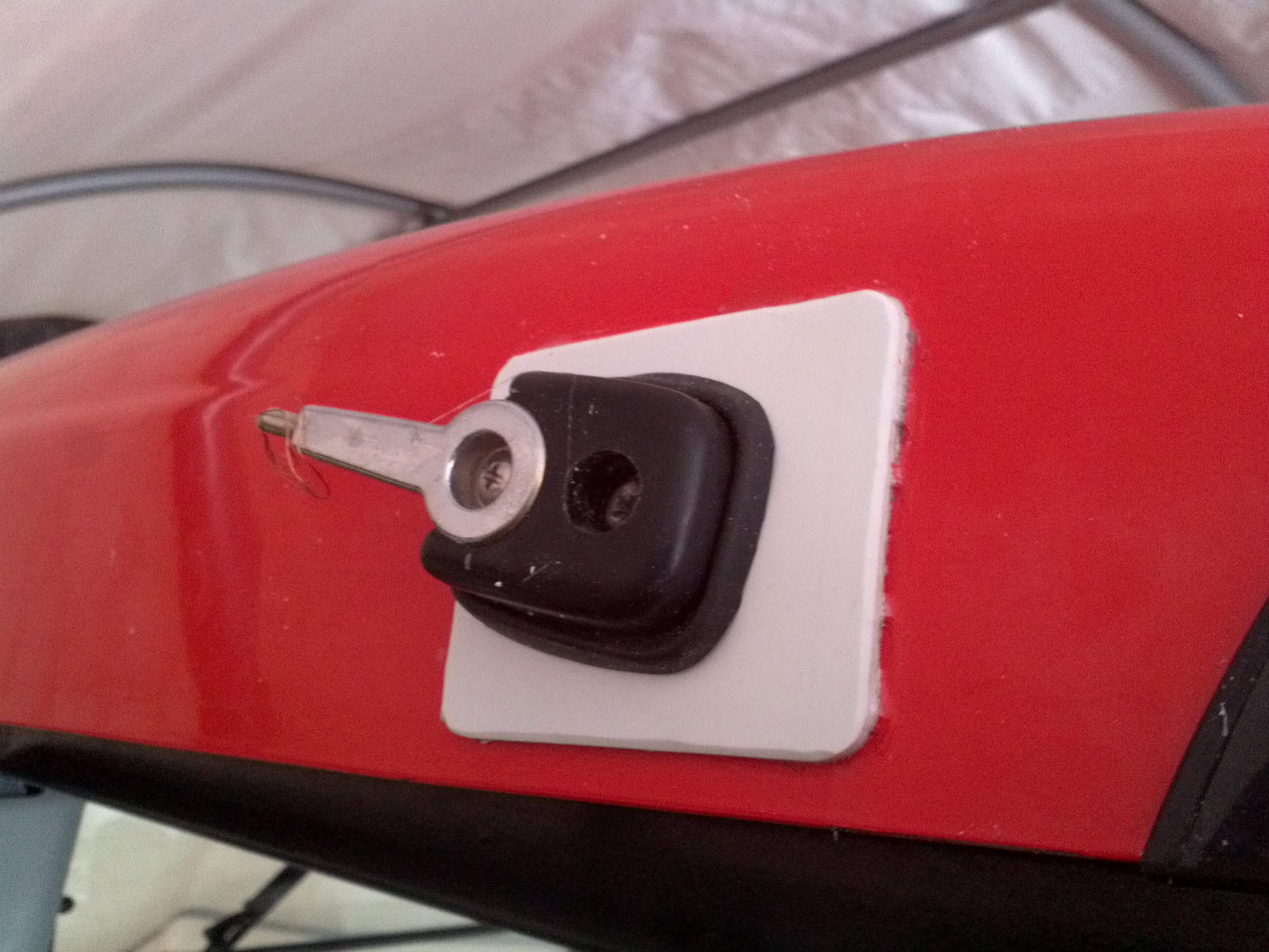

OK, I picked it back up this afternoon and stuck it back on top of the tractor. Here's some pics of the results. I really do resent the way Kioti designed the lid, you have to remove 8 bolts to take the grey trim piece that holds the front work lights off in order to access the 2 bolts that allow the roof to open on the back hinges. There must have been a better way.
Here's another picture of the damage, this time with the roof removed.
Here's what's up there in case anybodies interested.

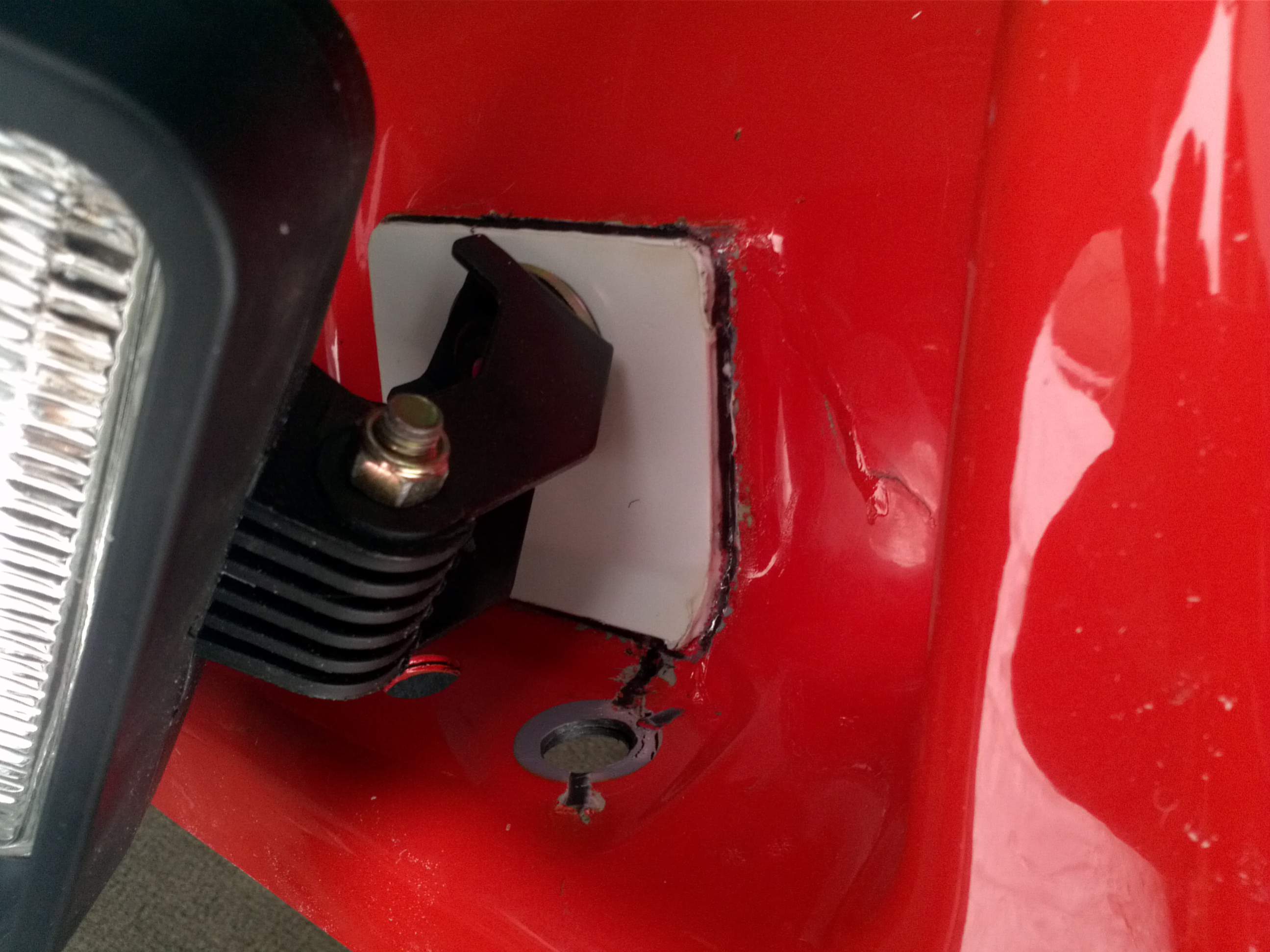

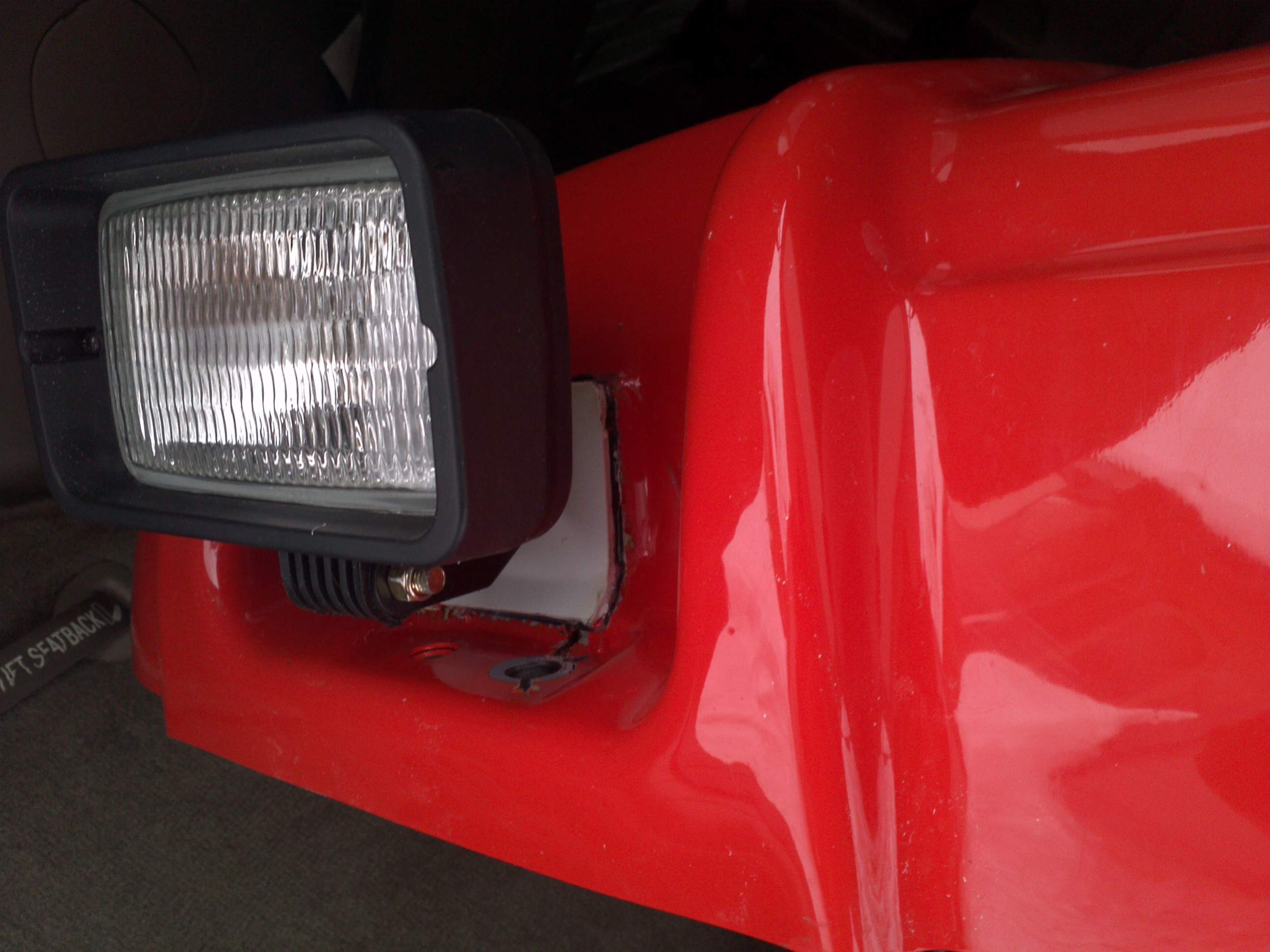

So, I'm generally pleased with the repair of the back light. I knew there would be a patch required to give it the strength needed. Also a few little pieces shattered off and where missing, so there had to be something to cover the hole.
I was a little disappointed when I saw the repair for the antenna, especially since it's in such a visible location. They told me they could easily weld that area and the break was almost completely covered by the antenna housing (which is why I never even noticed it before). They instead decided to add a patch for strength. I guess that's OK if it really needed the strength (I don't think it does since I'll never replace the antenna, I prefer it broken), but it sure would have been nice if they at least used black to blend in a little more.

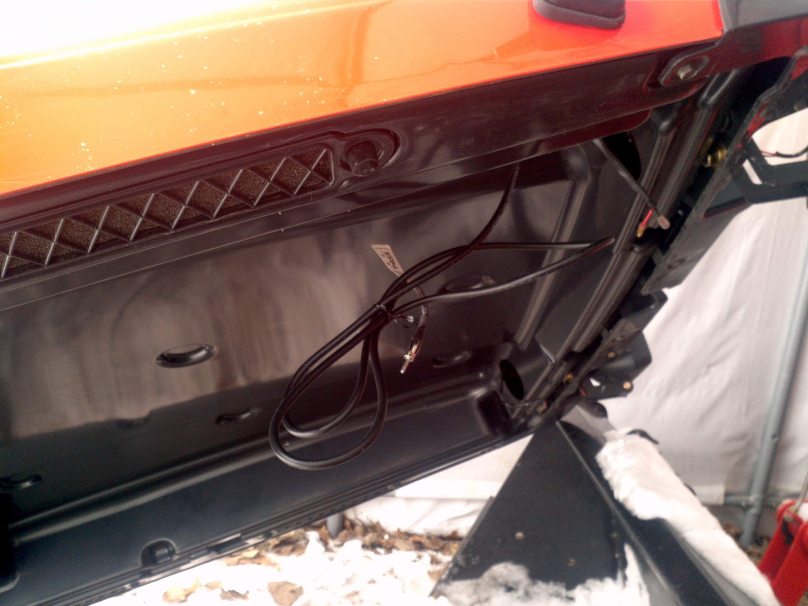

OH ya, here's the underside of the lid. It's a double walled lid with ducting, insulation and wiring inside. It's also the reason they want $1400 for a new one and why it's so difficult to repair. I had no idea I'd this is what I'd find so I though I'd post a quick pic of it for others to see.

Very interesting, they've changed the roof up completely, you can no longer access a crack from the inside. They are now made from ABS (according to the plastics guys I used) instead of fiberglass. You should go back and post a pic of your finished work, it might be useful to others in the future.

Ken get a can of Krylon Fusion paint in orange, it's designed to bond with plastic. Clean heavily with Windex, then apply a real light coat followed by a few light coats. It holds up very well. Regular paint will not stick to ABS or whatever plastic it is made of very well.
