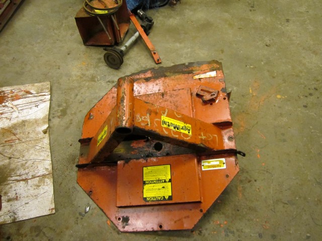

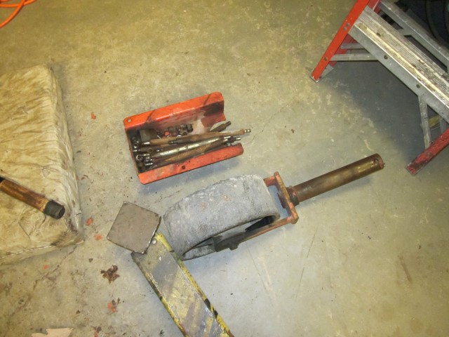

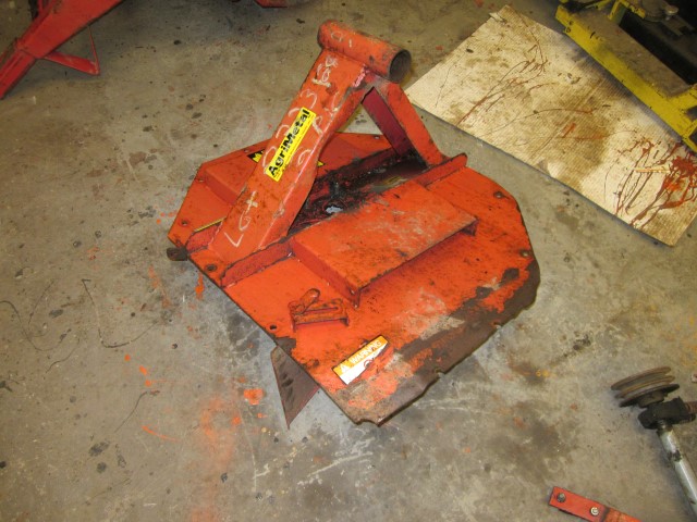

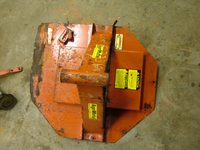

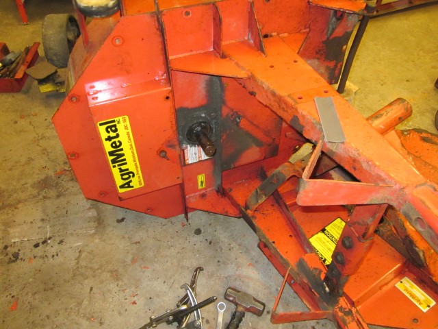

I started on the conversion from a front mounted to a rear PTO powered blower. Here's a few pictures :

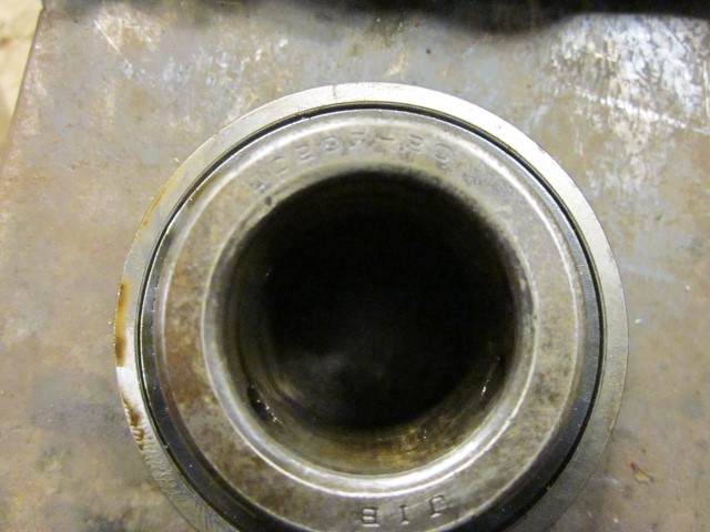

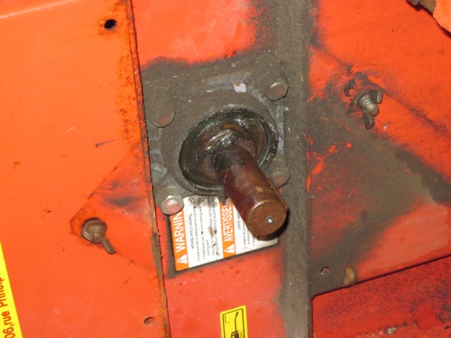

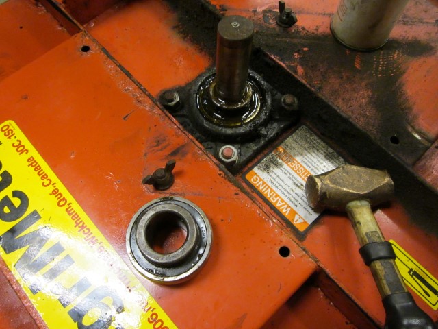

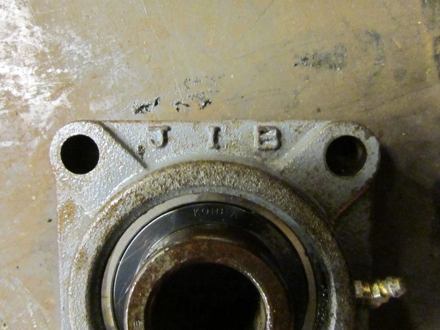

I am having a lot of trouble getting the front bearing off the fan assembly. I tried PB blaster. Any ideas? IMG_0470.JPGIMG_0482.JPGIMG_0483.JPG
/ Agri Metal Leaf Blower Conversion #3
Here is what I would do. I don't know if your trying to save the bearing or not but to me it's cheap so it's not worth my time to save it. Take the seals out and remove the cage around the balls. With a punch move all the balls so that they are touching each other. This should give you enough room to move the shaft to one side and remove the ball bearings. Once that is done then you can easily pull the shaft out of the bearing housing. Quick and dirty way to remove the bearing center from the shaft is to lay it on an anvil and beat on the bearing center with the largest hammer you have. (NB wear eye protection and for the same reason you don't want an audience) If you do it right the center will crack and then it's easy to remove. If that seems to be a bit to brutal then just take a grinder and grind a grove through the bearing center until it's weak enough to remove. If everything goes good I can have a bearing like this apart in less than 5 minutes. You could also use a cutting torch and cut the balls out with that but I like to save the torch to use as a last resort.

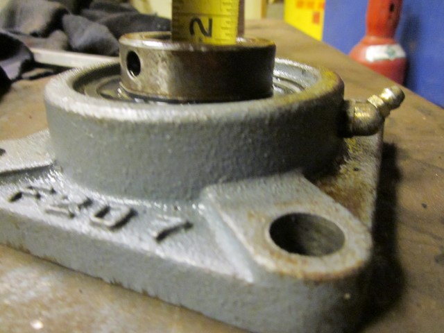

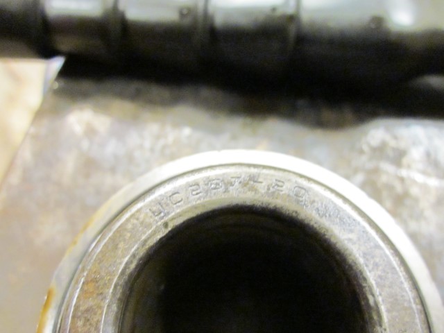

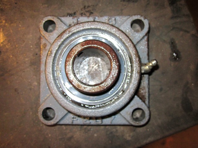

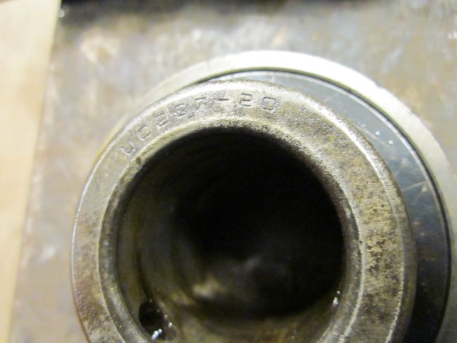

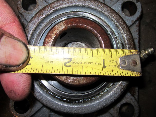

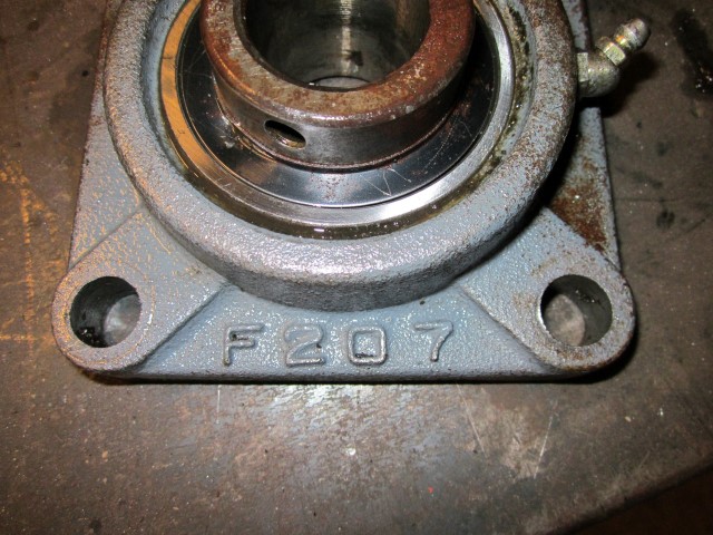

I'll try that. The other side took a little time but I finally got it loosened up. I plan on replacing both bearings during the reassembly. Is there a good place to buy them?
Bearing (1).JPGBearing (9).JPGBearing (8).JPGBearing (7).JPGBearing (6).JPGBearing (5).JPGBearing (4).JPGBearing (3).JPGBearing (2).JPGBearing (10).JPGBearing (12).JPGBearing (11).JPGBearing (13).JPG
/ Agri Metal Leaf Blower Conversion #5
I know of a few good local suppliers but we live about 2400 miles apart so that's not going to do you much good. Take the number off the good bearing and start phoning local businesses out of the yellow pages. Try googling the number. I've found the cheapest prices for bearings on the internet.

I don't know much about the blower yet. I'm still trying to straighten out the metal housing and get the bearings replace. I hope to have it put back together this weekend. Then I have to figure out how to convert it to PTO powered.
I know someone on the forum has done it on an Olathe blower so I'll use his posts to point me in the right direction.
http://www.tractorbynet.com/forums/attachments/185378-converting-front-mount-olathe-leaf.html
I got the blower for $50 and a two hour drive. Figured I couldn't go wrong for that kind of investment. I get too involved and forget to take pics as I go. Once I get it straightened out, my next step is making the 3 point hitch hookup.

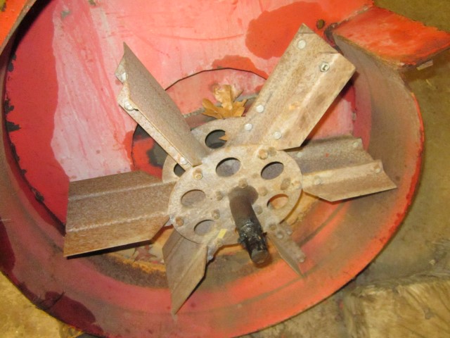

Here are some pictures of my old tired blower..its in need of an entire rebuild except for the impeller because i just replaced it ..this design is terrible, do not use it unless you modify the lower shaft bearing setup and the adjustment system, its terrible...I paid 600 for this blower 20yrs ago used ,it doesn't owe me anytime, but the impellers snap clean off on them due to a poor design.
/ Agri Metal Leaf Blower Conversion #12
Here is the last impeller that snapped off on me 2 years ago...the main shaft was too small for the size of the belts and tension spring.You couldn't fit a larger mainshaft without larger bearings,but the design limited the bearing size,so Agrimetal milled down 2 sides of a larger ID series bearing and it works now,hopefully this will be the last impeller for a while.

Several question come to mind. It almost sounds like you have a real vibration problem if the set screws are coming loose that fast. Secondly are you tightening the lock collars opposite the direction of rotation. That way the bearings will self tighten. Hopefully your are using bearings with lock collars as bearings with just set screws on the inner race will never stay tight in this application. Thirdly is your pto shaft binding in any way? Is the pto shaft well lubricated so that it can easily slip longer and shorter under load?

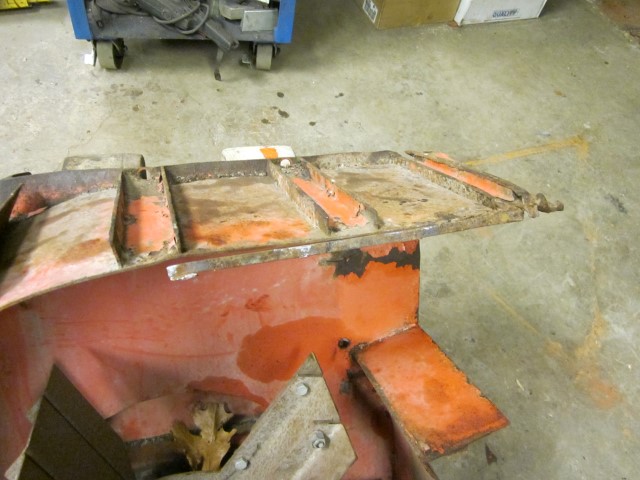

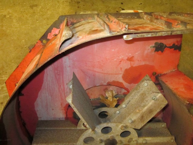

I straightened out some of the metal and reinforced some of the welds. I added some reinforcement to the bottom of the frame and reassembled it for fit-up. I'm waiting for the replacement bearings then I can put it back together and work on the pulley setup. I welded on the mounts for the front guide wheels.
