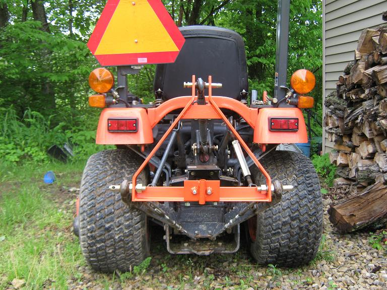

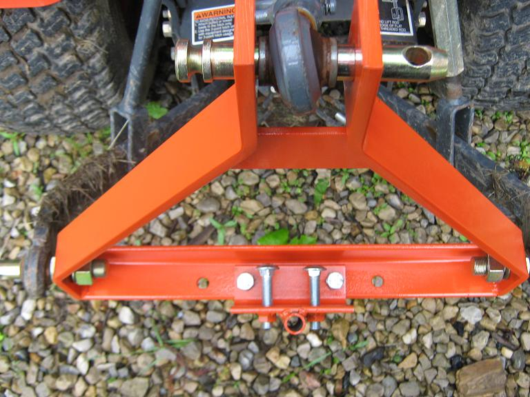

   / Agri Fab Sleeve Hitch Rock Rake conversion #3
I'd buy a cross drawbar for 30-40 at my local TSC or similar and probably a U-bolt with a chain for the top link if I wanted it working in 20 minutes. Looks like you already have a place to bolt the bar to or drop a pin in it.

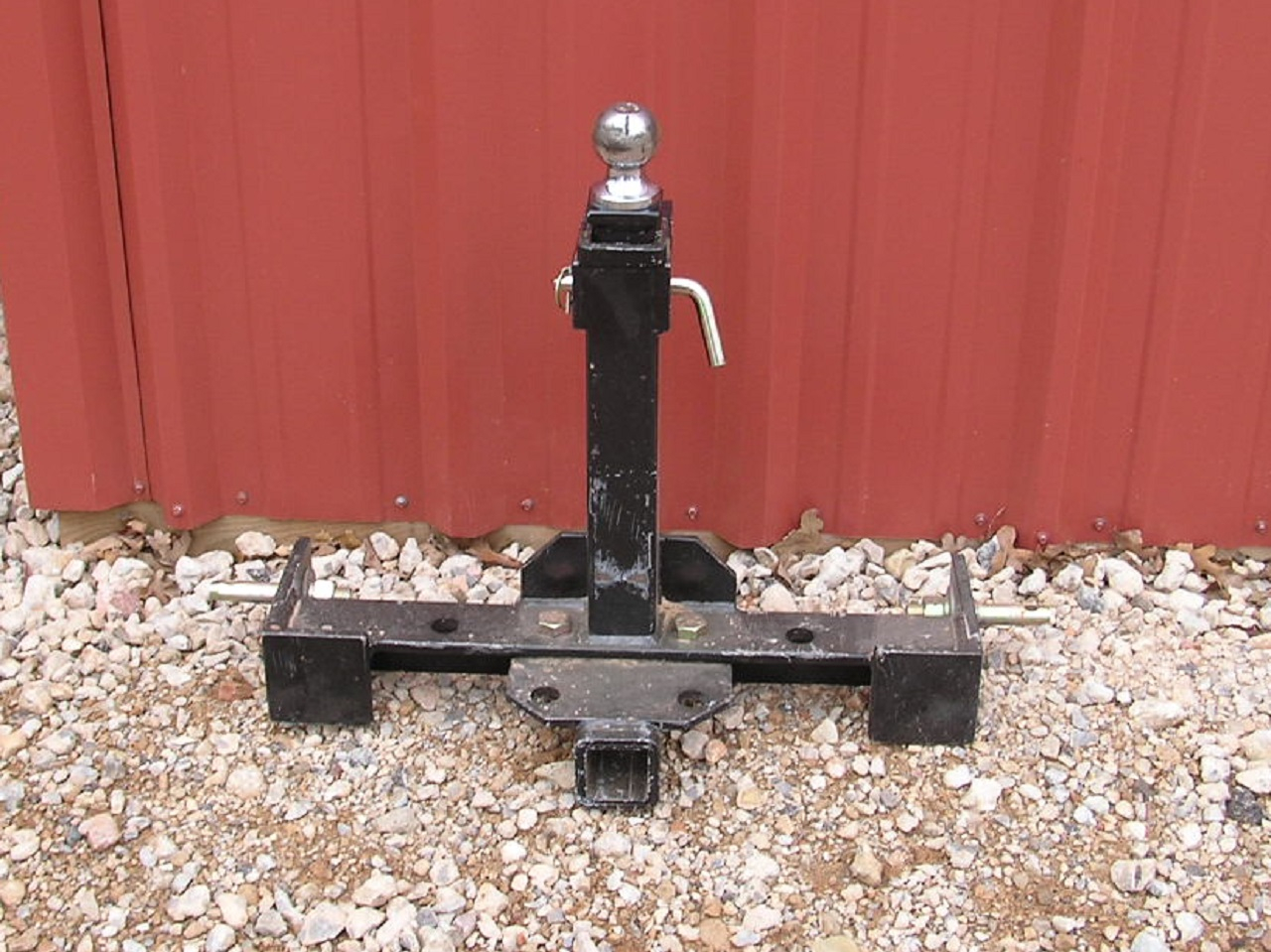

   / Agri Fab Sleeve Hitch Rock Rake conversion #4
If it is a 2 inch square tube, cut off the sleeve hitch, drill for pin and use it on a 3 point receiver hitch like mine:

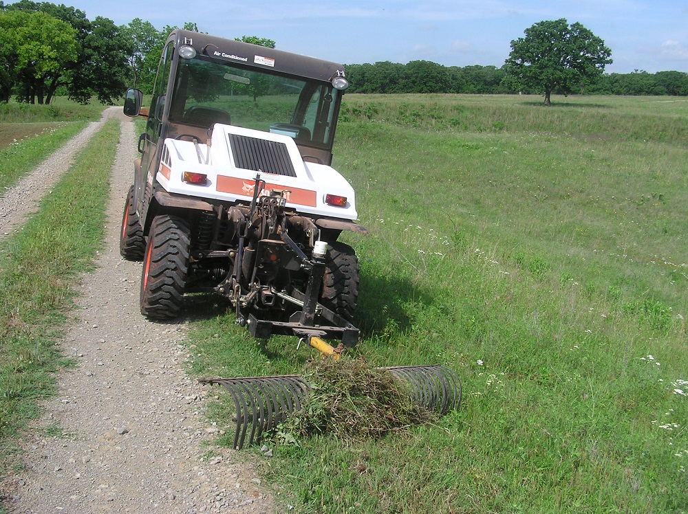

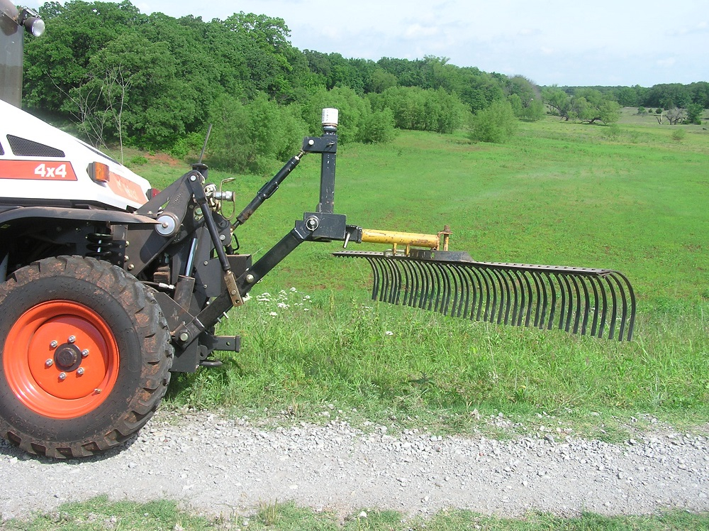

   / Agri Fab Sleeve Hitch Rock Rake conversion #5
How would a rake on a sleeve hitch even work? It seems that it would just catch something and turn sideways or angle.
   / Agri Fab Sleeve Hitch Rock Rake conversion #6
Sleeve hitches don't pivot.

fishman29
If you don't have a 3 point receiver hitch this would work: Ballard Fabrication

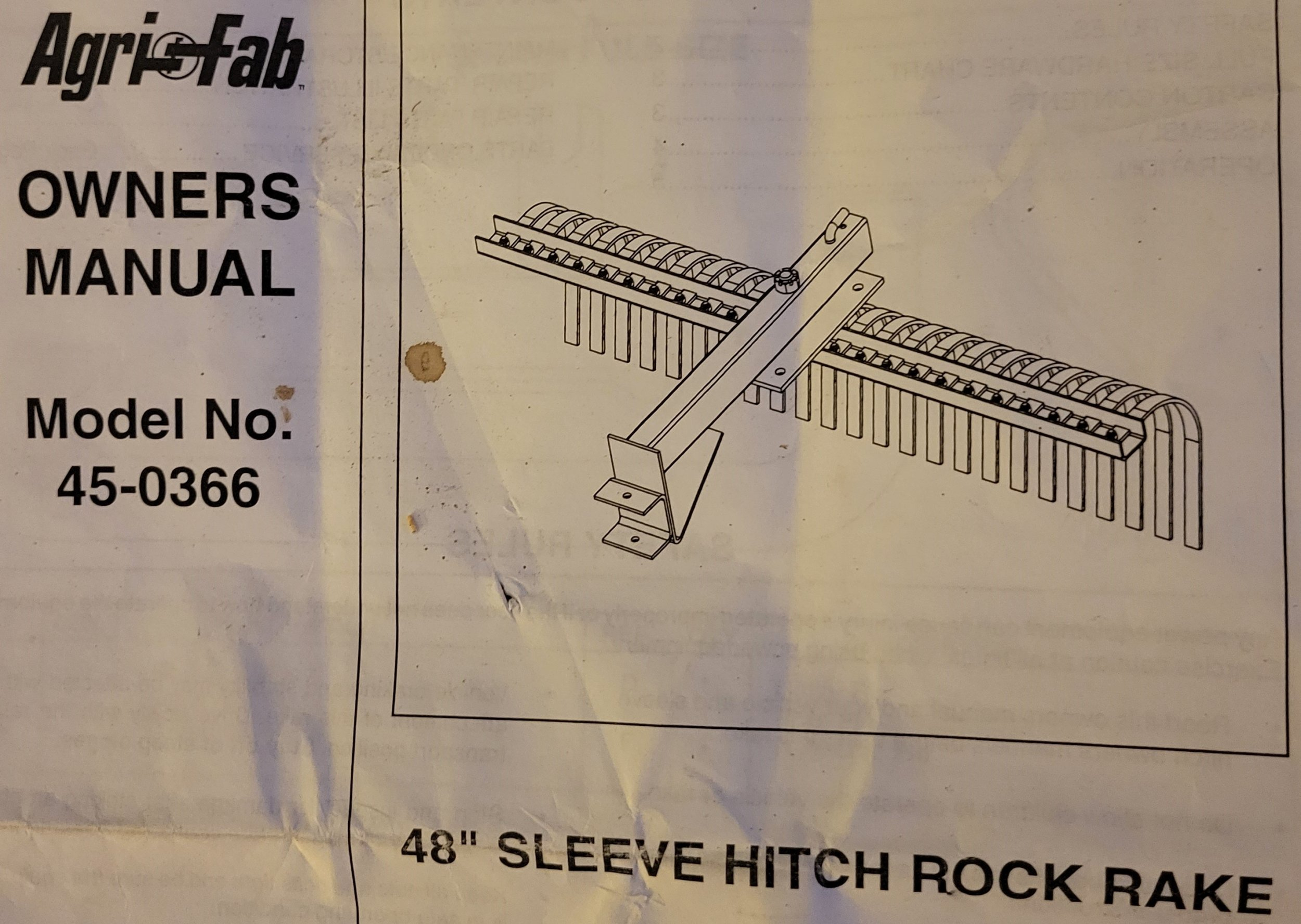

   / Agri Fab Sleeve Hitch Rock Rake conversion #7
It sure looks like the one in the OP manual does.
