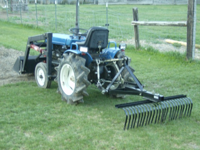

I finally got back out to use the rake tonight so that I could get some pics and post some review.
The attached pic shows the rake attached to the tractor. You can see that it easily covers the tracks of the tractor.

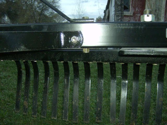

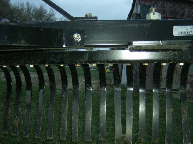

One thing to note about assembly. The bolt that attaches the mast support to the mast needs to be oriented with the nut up. Otherwise the rake won't pivot. The first picture shows this.
I pulled the bolt and turned it back right side up. The second picture shows how the rake can pivot now.

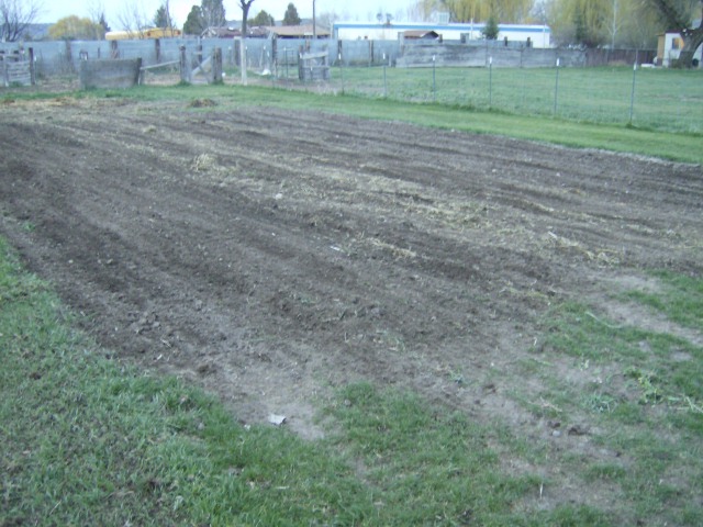

After fixing my botched assembly of the rake, I used it for a little to clear out the old hay stack place and then to smooth out the garden in preparation for planting. I've attached a picture of the garden after I went over it.
Someone here on TBN suggested going over ground with the rake turned backwards to smooth out ground. It seems to have worked fairly well.
One additional note about this rake on this tractor. It seems like I need a longer top link. I'd like to get more tilt on the rake so that I can use it better to "scoop up" loose hay, twigs, etc. This may be something I can simply fix with more weight on the rake.
