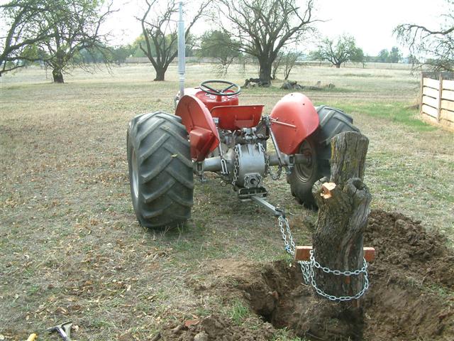

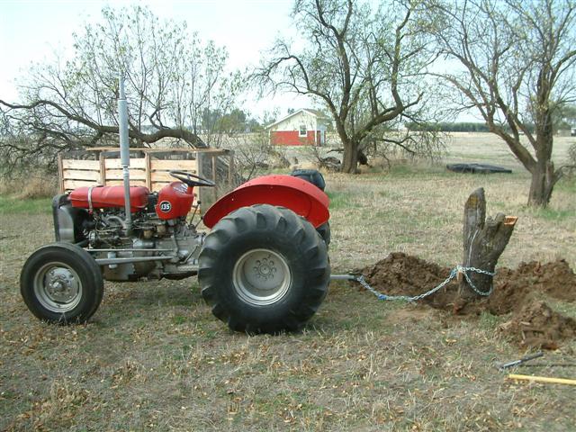

You're right. Dave has set up Mahindra's and Branson's for work on steep slopes. Dave sold me a new 2008 Mahindra 5525 in standard configuration with large ag rear wheels. However, my 1965 Massey Ferguson 135 diesel is rigged up for use in the local olive orchards and on slopes.
The rears are 18" wide with 16" diameter rims. The front spindles have been shortened to keep the tractor level. Case makes a line of Straddle tractors that are similar to that 135, which is also a straddle tractor.
View attachment 632734View attachment 632735

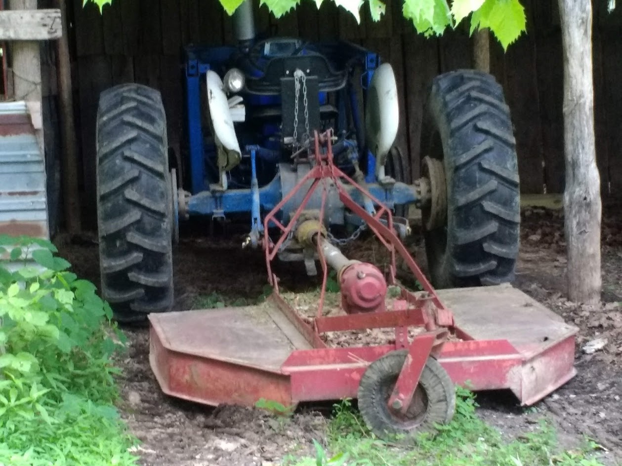

Width is definitely your friend when it comes to slopes. I mow some really steep stuff with the old Ford. For reference, that is a 6 foot cutter.
