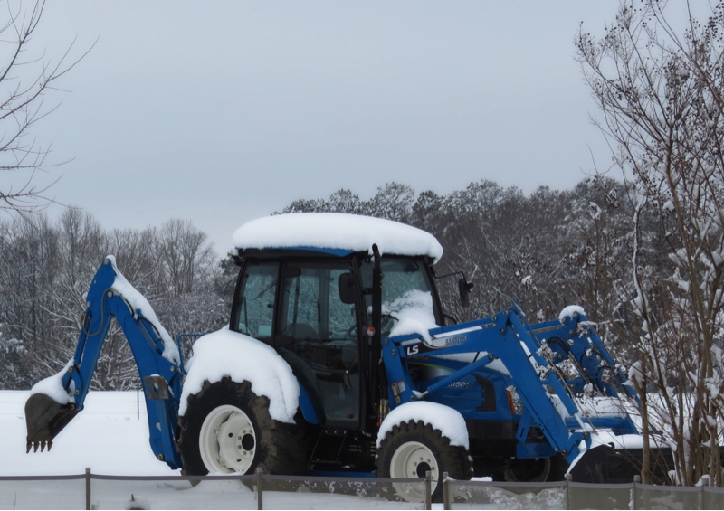

Real pleased with the R4s on my XU. I also have the LS backhoe, and appreciate the wider tire profile for stability when using it and the front loader. They don't tear up the yard too badly, and handle the occasional 3 mile trip over blacktop to the in-law's better than R1s likely would. Have done bush hogging and finish mowing in sloping terrain with no need for 4WD. Insofar as ice and snow, well, it stayed like this until all the white stuff melted... I usually avoid slick and muddy situations unless absolutely necessary, and that may be why R4s work just fine for me.

I didn't think Roll Tide country ever saw white stuff!
