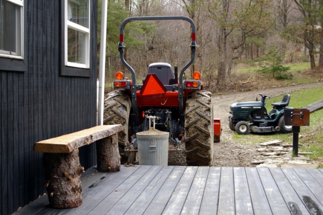

   / Ag - Industrial - Turf - Which ones? #7
:)If the ground is hard and you're not in 4wd they Ags will be fine on your lawn.
