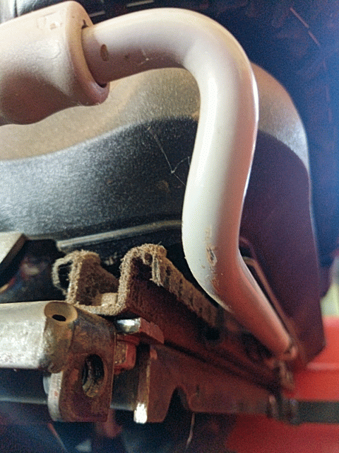

I ended up getting a seat from. Nick at toughseats.com who gave me a great deal on seat. I took the old one off and put new suspension seat on top of old suspension. The seat is a Grammer MSG65. It barely mounted on the old suspension but it did and is very comfortable. Burst_Cover_GIF_Action_20170613164943.gif
   / Aftermarket seat for M9540?
I ended up getting a seat from. Nick at toughseats.comwho gave me a great deal on seat. I took the old one off and put new suspension seat on top of old suspension. The seat is a Grammer MSG65. It barely mounted on the old suspension but it did and is very comfortable. View attachment 515825IMG_20170613_164854.jpg
Having problems posting pics but here is one more.
