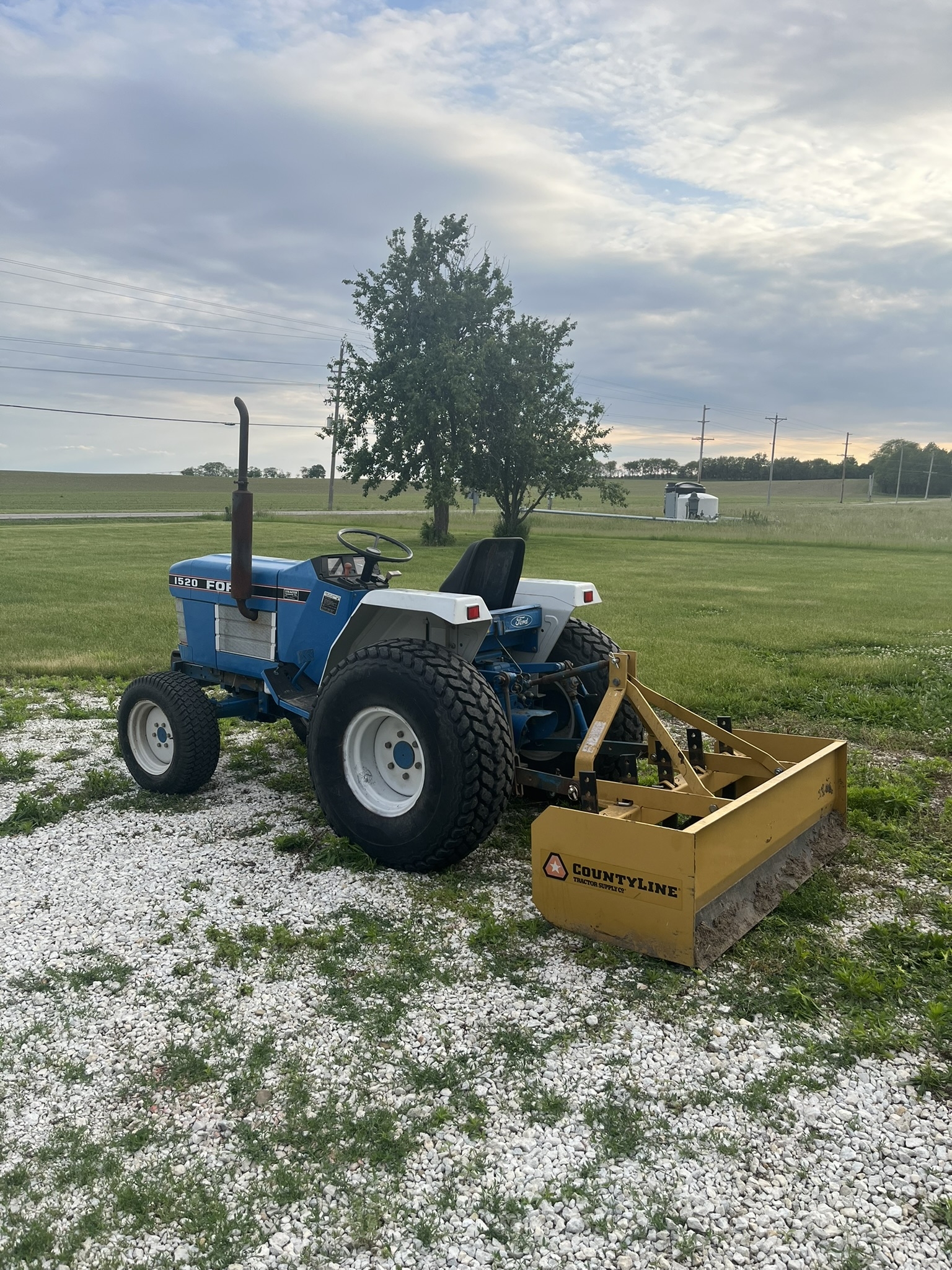

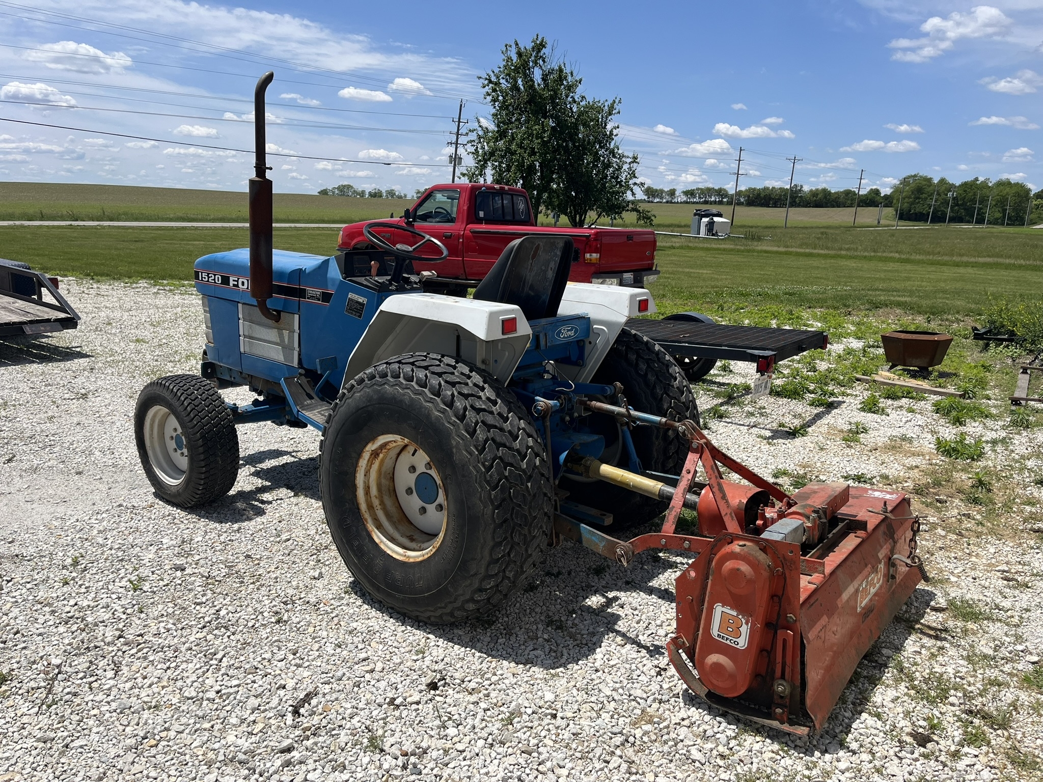

Missed out on the loader this weekend. Sold it to someone else while I was waiting for a time/place to pick it up. Strange how that happens.
The tractor has been great though. Came with a tiller and a 5' brush hog. Pic was just after pulling it off of the trailer.

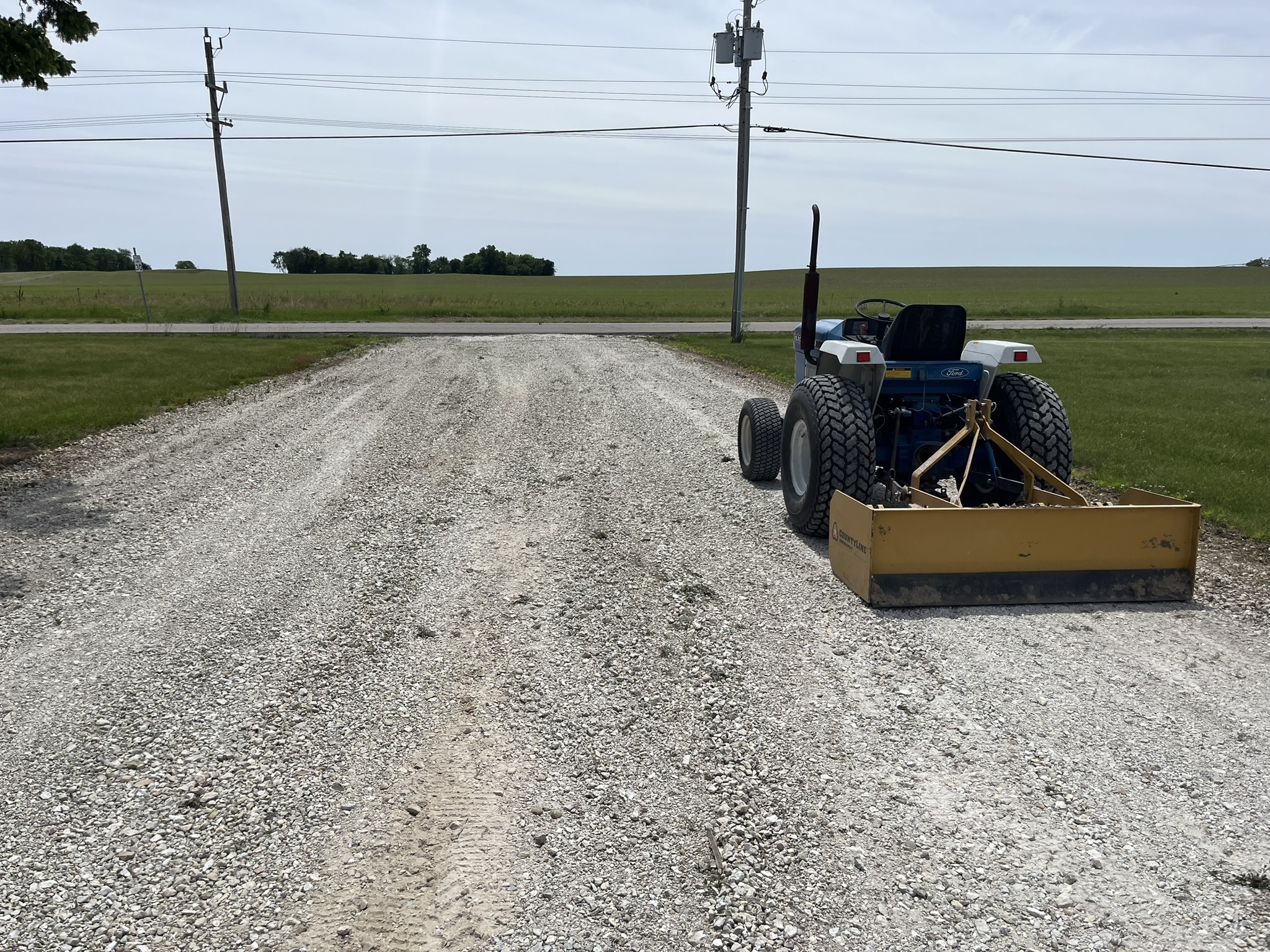

I did find a box blade over the weekend. I've been cursing these weeds. Feels great to have a way to properly maintain things around here.
I'd like a loader eventually, but now my gears are turning for home made implements that will let me lift things with the 3pt. I could do a lot of work with a primitive set of forks.
