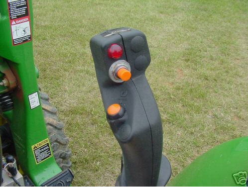

Does anyone have any websites that show/sell aftermarket joysticks with thumb controls?:confused:
I am asking because the JD 4720 I want only has the normal up/down/curl joystick and I want a 4n1, but want to use the open/close with my thumb rather a separate lever [3rd lever].
Here's one I found on a tractor on ebay......:D

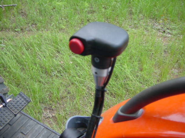

check these guys out, I got one of the tractor grips with the big red button.

Red Rocker, where did you get the OTTO handle, I talked to OTTO directly and they make the handle but not the aluminum adapter below and were unable to identify where it came from.
/ Aftermarket Joysticks #6
I made the adapter, one of the perks of being a machinist I guess.

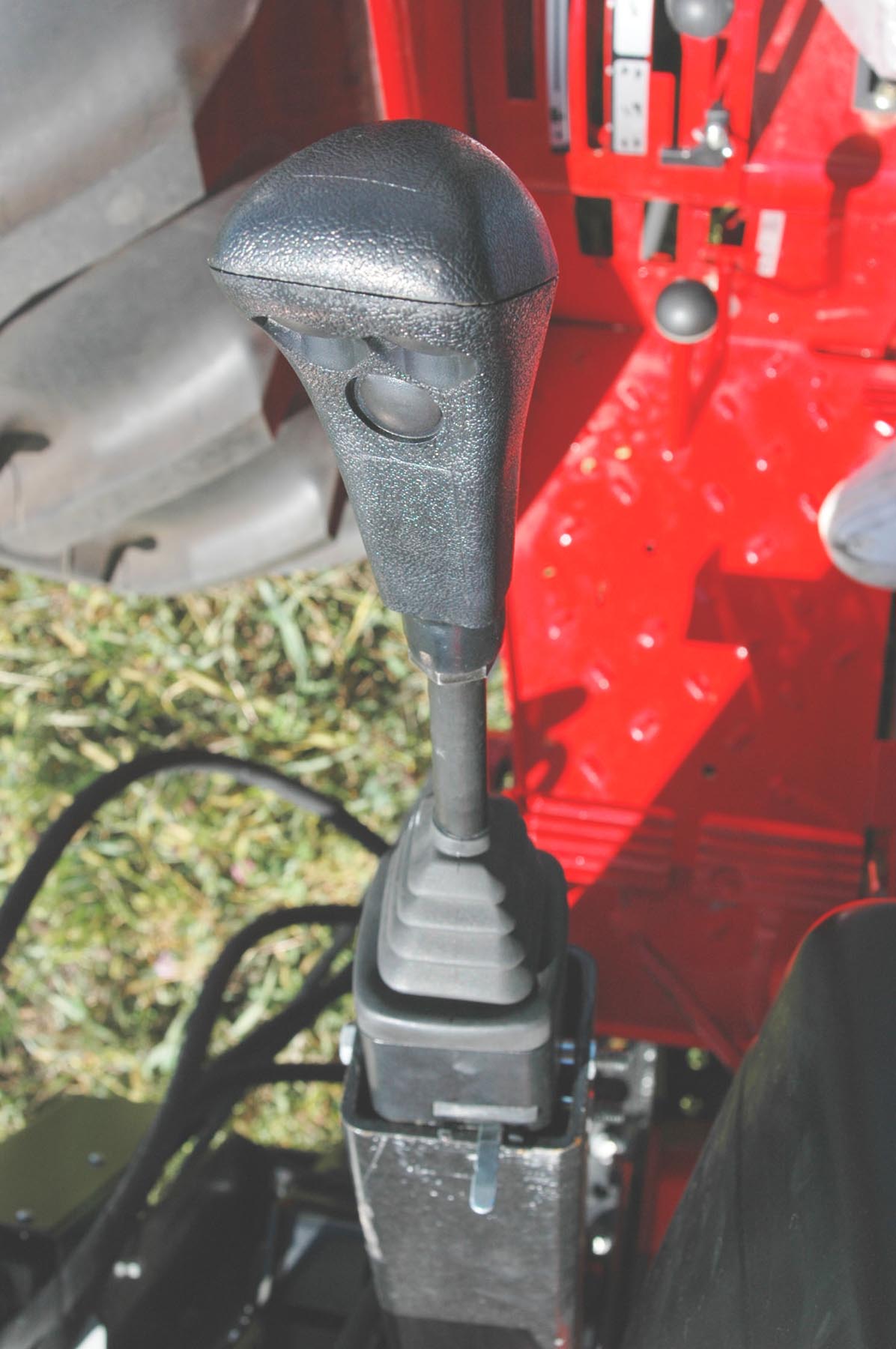

We don't have these on our website yet, Is this what you are looking for? This is our precision joystick - it's real smooth and button lets you electronically divert to grapple function.
