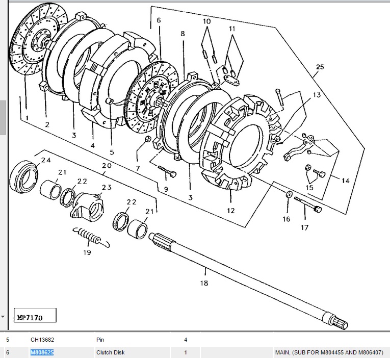

Greetings,
I need to replace the traction clutch disc on my JD 870 tractor.
Can someone who has used an aftermarket clutch disc comment on its quality
and perhaps recommend a source?
Thanks, Jim

   / Aftermarket clutch disc for JD 870 #4
Look the parts up in jdparts.com (free registration) and just enter your model no. (870) and go to 870 compact utility and Clutch under the alphanumeric listing.
Here is a pic of the schematic. It shows the PTO clutch plate and the main clutch disk.
Main is part no. M808625 (item 6)with a reference to the same being LVU801100. You can do a net search on those numbers.
PTO is M804454 (item 1)

Can you please give me the part number for the two pressure/spring plates?
Item no. 3 in the diagram.
Thanks, Jim.
   / Aftermarket clutch disc for JD 870 #6
Yes
3 CH13687 Disk Spring 2 DIAPHRAGM
