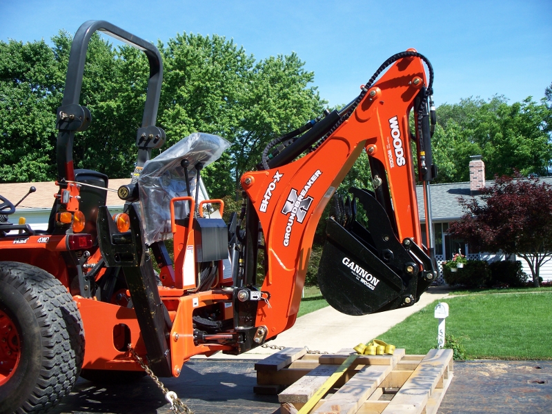

I know that MY B7610 with MY Woods BH70X lifts the front end on a hard root. But I've only used it for about an hour so far for real digging.
As far as cost - the Woods BH70X installed was more than the leftover 3pt hitch B4672. That one uses a beefed up top-link, w/o subframe.
quotes I got, w/ bucket, subframe for the Woods, install -
BH6000 -$5K
B4672 - $6.2K
BH70X - $7K
But I've about an extra foot of reach
