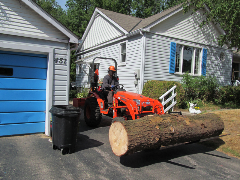

I recently added the Kubota QA and aftermarket forks to my B3200 (they haven't appeared on my credit card statement yet!)
My dealer recommended the aftermarket forks from HLA attachments here in Ontario that are set up for the LA 504 loader pins as they have a 2000lb rating as opposed to I believe 600 for the Kubota forks. I have already lifted over 1000lbs with them.
So the price - $300 for the QA and $800 for the stronger forks. Canadian dollars! I had to add sales tax to these prices, but they were assembled and delivered for that price. I am very happy with them.
Couldn't do this with clamp on forks as the load would be too far from the pivot points.
