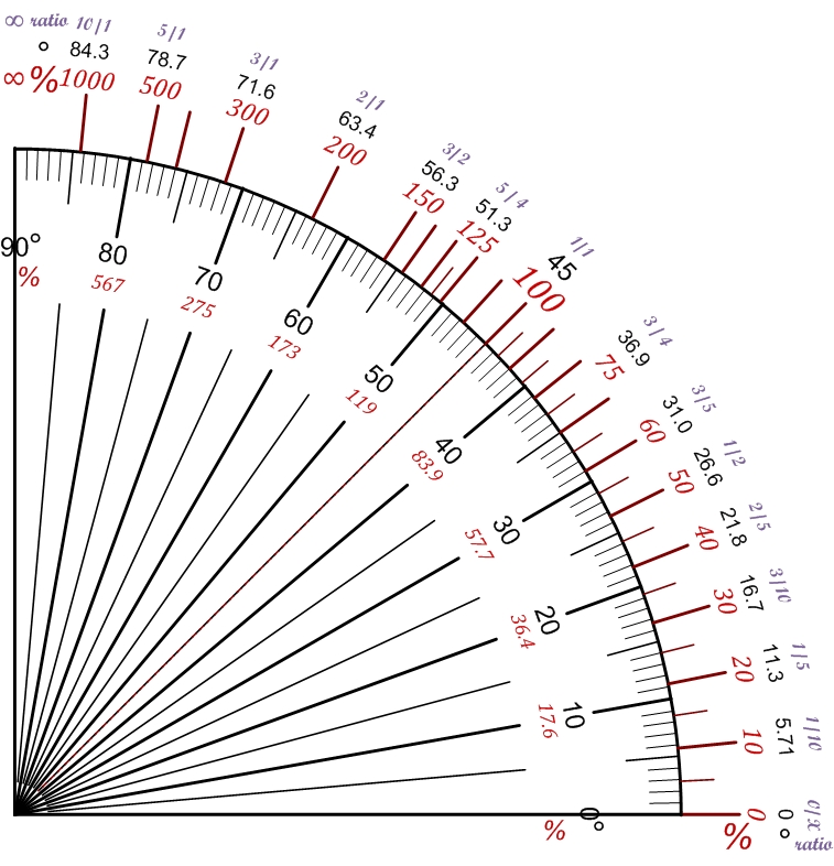

3 foot rise in 12 foot run is what, about 14 degrees?
Here's a handy chart....
503807d1490720454-advice-wisdom-needed-slope-operation-pente-slope_-degres-ratio_v1-jpg
   / Advice/wisdom needed for slope operation problems with my PT 1430.... #9
Or you can just do the math on the arcsin(3/12), i.e. the sin[SUP]-1[/SUP](3/12)= 14.4 degrees.
That's partly why I suggested that it should be well within the capabilities of the 1430.

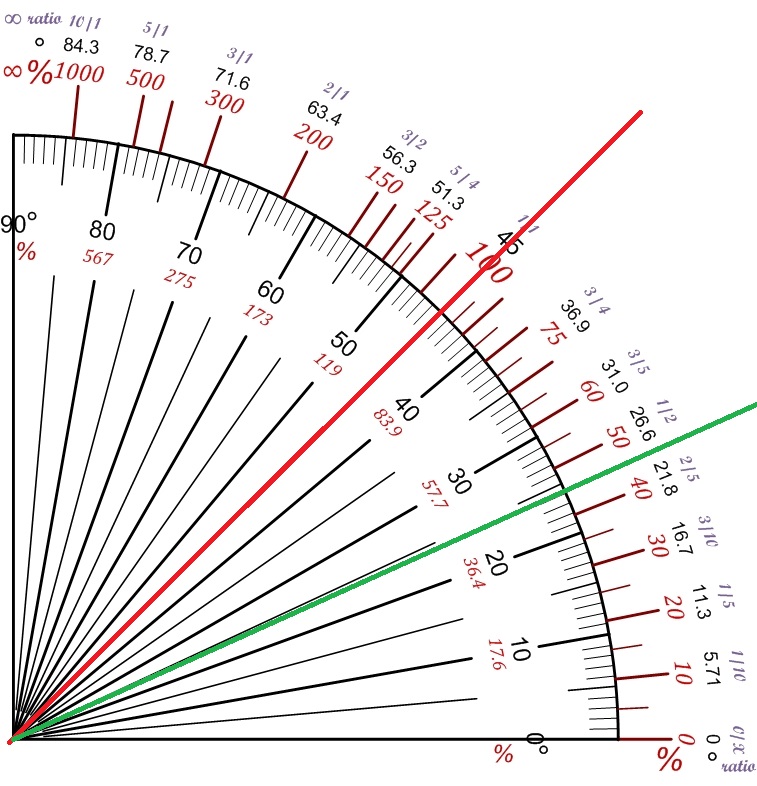

MATH! No one told me there was going to be a test today! AAAAAaaaaaaaaaa!!!!!! :laughing:
Sooo.. have some beers and don't think too hard on this...
The green line represents a 45% GRADE.
The red line represents a 45 DEGREE ANGLE.
Can you drive your tractor across a side slope on that red line?
There's been several discussions on TBN in mowing threads, trailer hauling threads, etc... regarding grade VS angle. I don't think a lot of people comprehend or appreciate that Power Trac make a 45 DEGREE slope mower....
Not 45% GRADE......... 45 DEGREES.
That's insane.... :eek:
