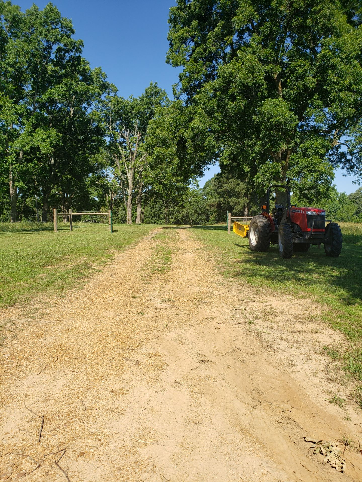

You guys need land planes for your gravel driveways. If it's ever had enough rock a land plane will pull it back up to the surface and lay it back out perfectly smooth. All you have to do is drop it on the ground and drive. No constantly messing with the 3 point or anything like that.

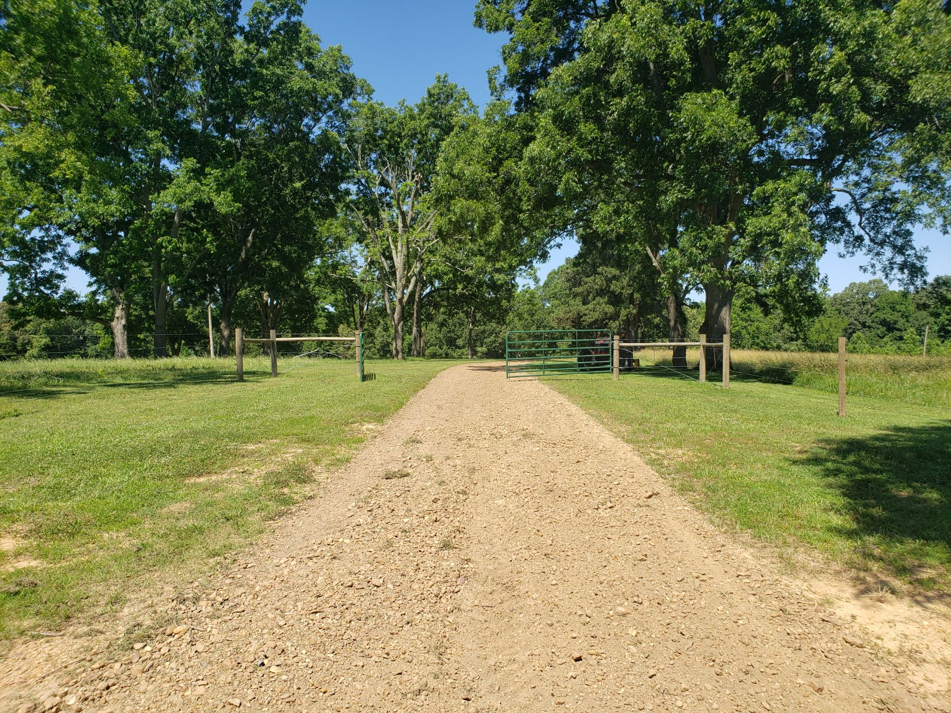

I love my new land plane (bay boy 72" land grader). It does what str8 says, and just puts all the gravel right back on top nice and even. It's crazy good at this task, one or two passes and your road looks like new.
However! I am finding that it does tend to kill the crown in my drive. I need to get it formed with more of an inverted "V" shape, instead of a rounded crown. Then I can drive down each side of it to refresh the gravel without completely flattening it.
