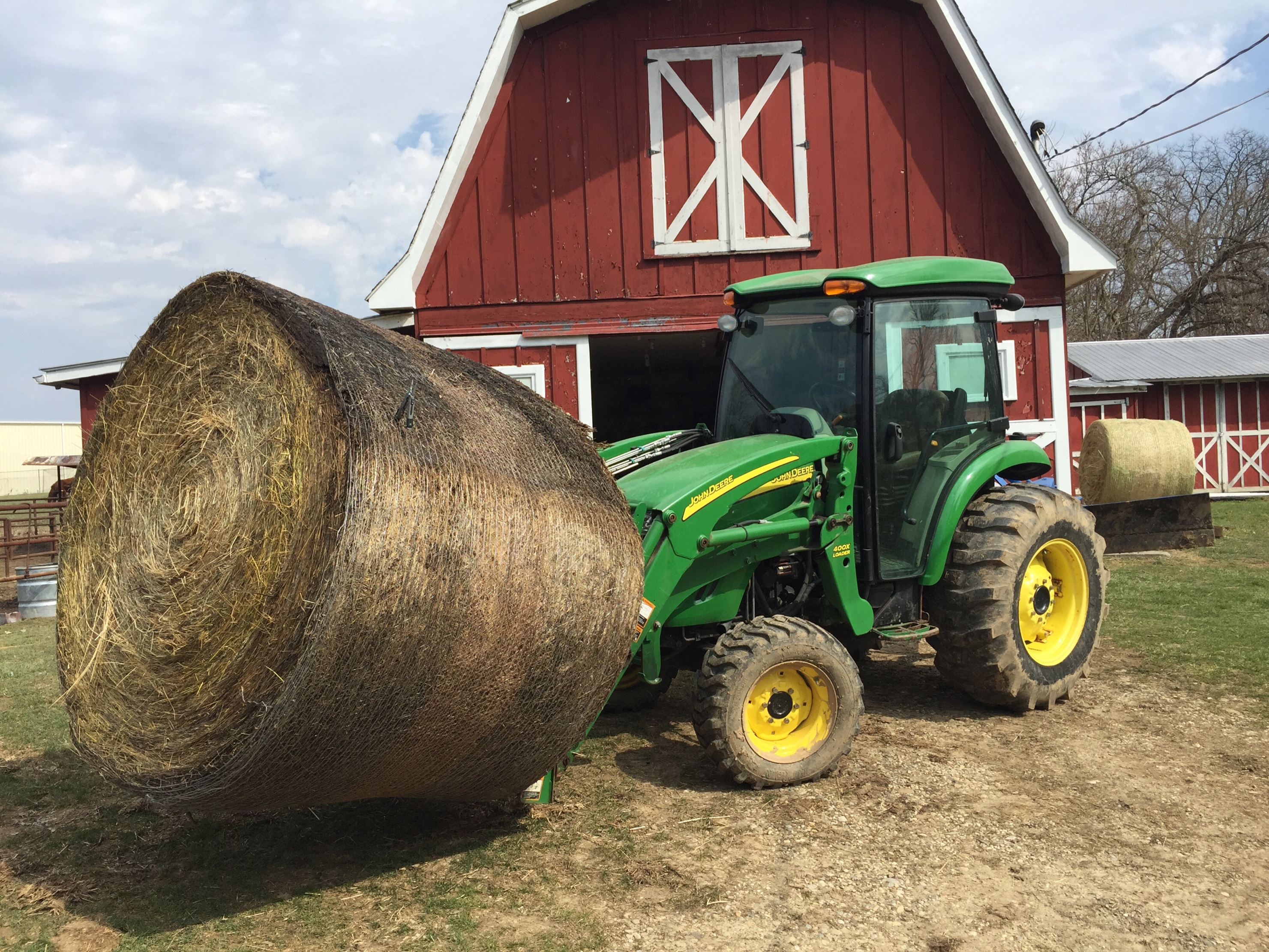

I recently sold my JD 820 tractor (broke down) and am looking for a replacement. I used my tractor to bushhog now 4 acres (fairly flat),push snow with scraper blade, and dig occasional post holes. We have 5 small cows and feed large bales.... looking at getting tractor (leaning Kubota) with a FEL to moves the bales (push), mow with a 5 foot bush hog, clear snow, clean out the cow loafing pen etc....(a loader will be a great upgrade).... any suggestions on size and models or any leads on tractors for sale (I am in SE Pa near Kennett Square).

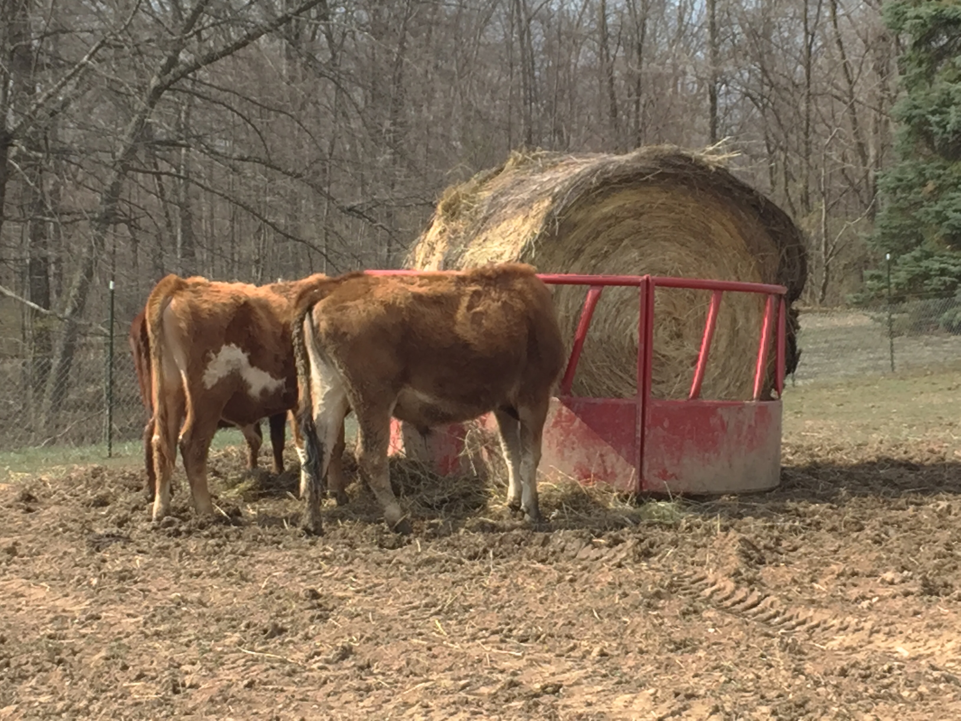

You will have to buy a Grand L Kubota or bigger to move large round bales with the FEL, your smallest tractor will prob be a 1533 Mahindra, my tractor has a lift of 1750lbs to full height, it's never struggled to pick up a large round bale but on 3 diff bales it struggled to curl them. IMG_7251.JPGIMG_7255.JPG
I have fed with 4x6 bales and my tractor (5300lbs) feels light sometimes, weight is a big thing to look for.
