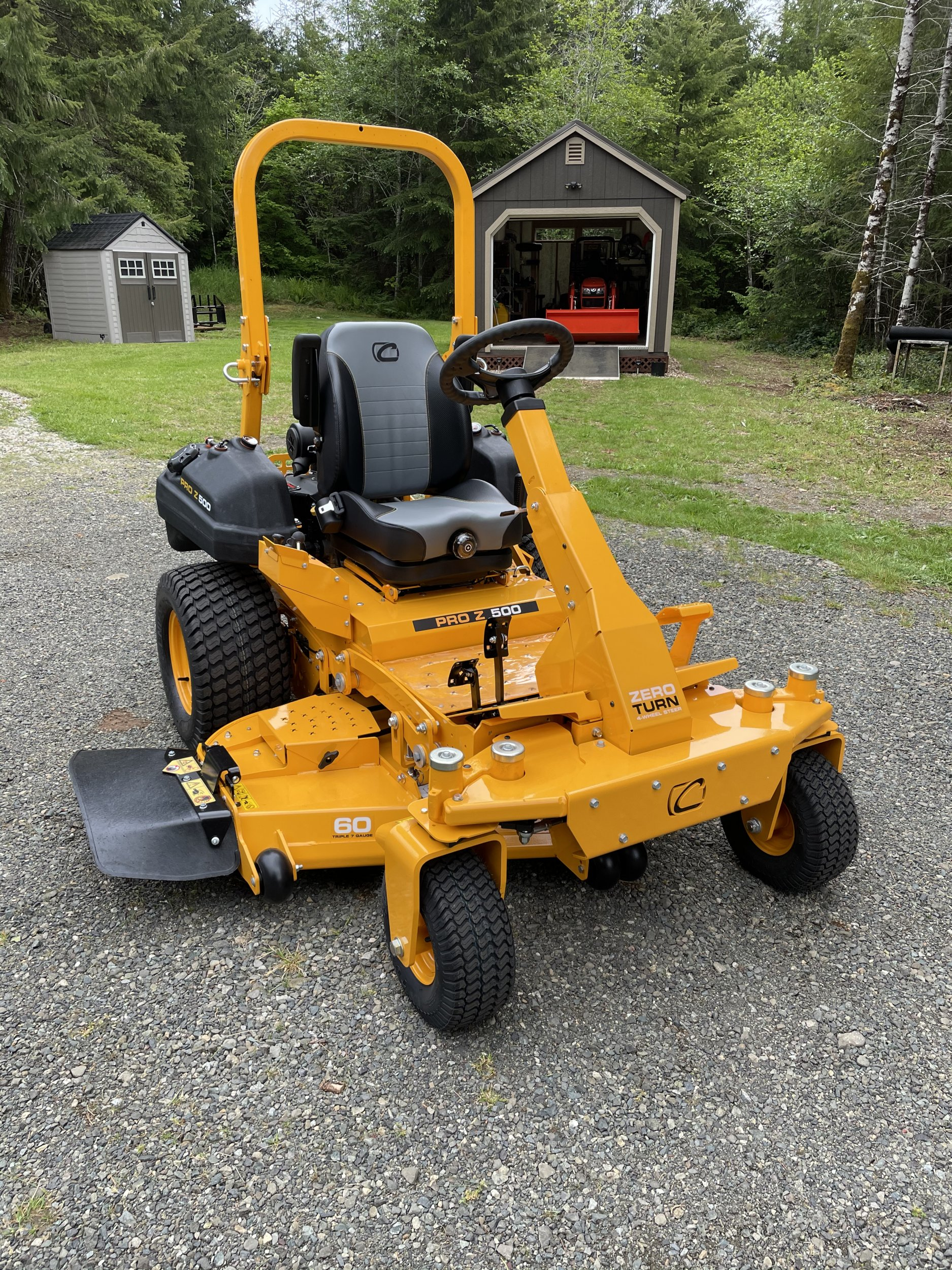

It’s a budget killer but, here’s a ZTR for hills;
It’s a Cub Cadet Pro Z 560 s KW and runs around $12K. It’s built like a tank and mows hills quickly and safely.
