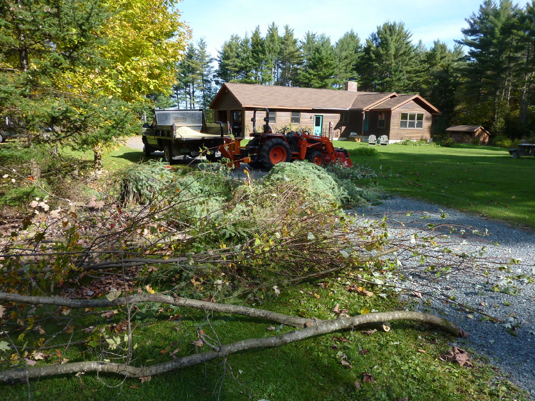

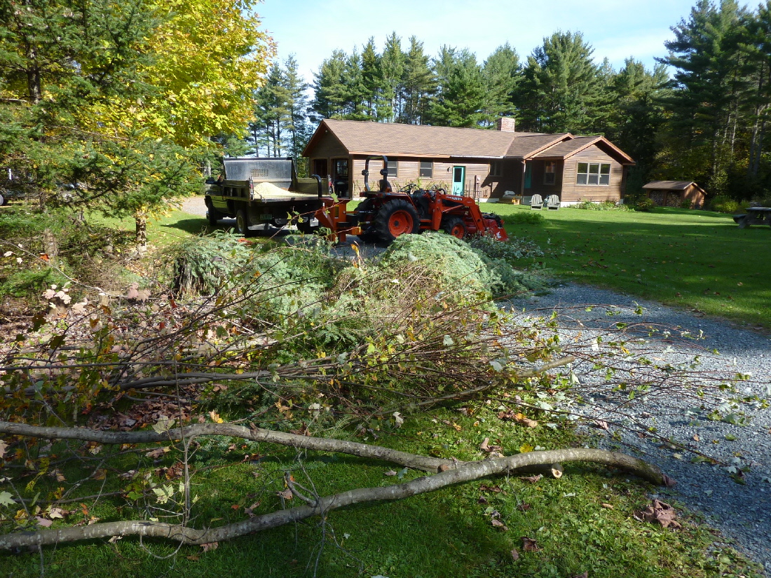

I have a BearCat manual feed 5" chipper shredder. I agree 100% with what TerryR says. And keeping the blades sharp can't be emphasized to much.

I've got the same chipper/shredder you have...just has Woods on it (Bearcat is the manufacturer).
I see you have the blower/chute...mine doesn't and I wish it did. I just can't justify the (almost) thousand dollar price tag to add it...especially since I only paid a grand for it (used) years ago.

I bought mine used also. My neighbor had it. It mostly sat unused. I offered him $1200 - he said no. About a year later he asked if I still wanted it :) Usually deals work the other way for me. It is a good chipper. The blower does take some extra power to run though.
