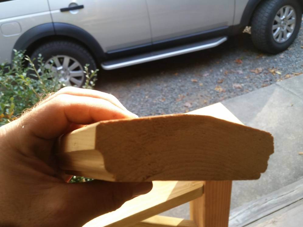

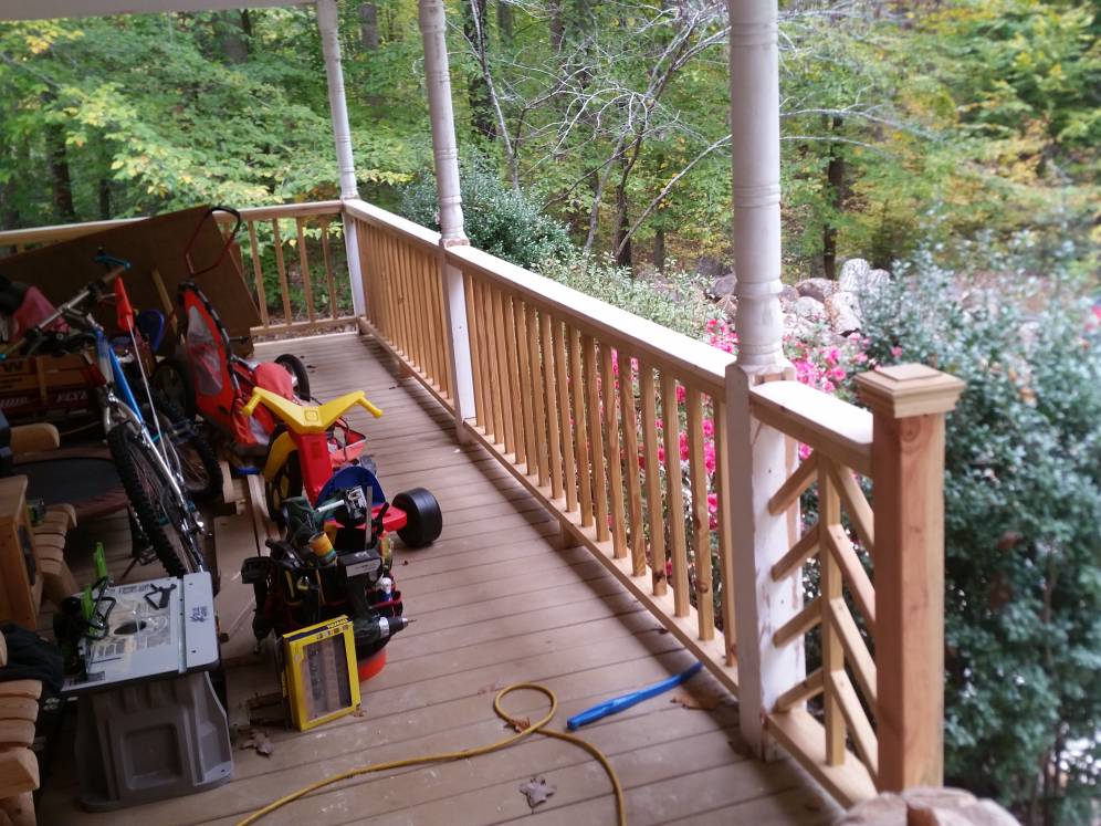

This is how I did my top rail, used a 2x6 and beveled the top on the table saw, then routed a Roman pattern in the bottom.
Really like the look and how it feels. I used a block in the middle with 2x4 bottom and top. Very stable. 1384759538.jpeg1308509652.jpeg

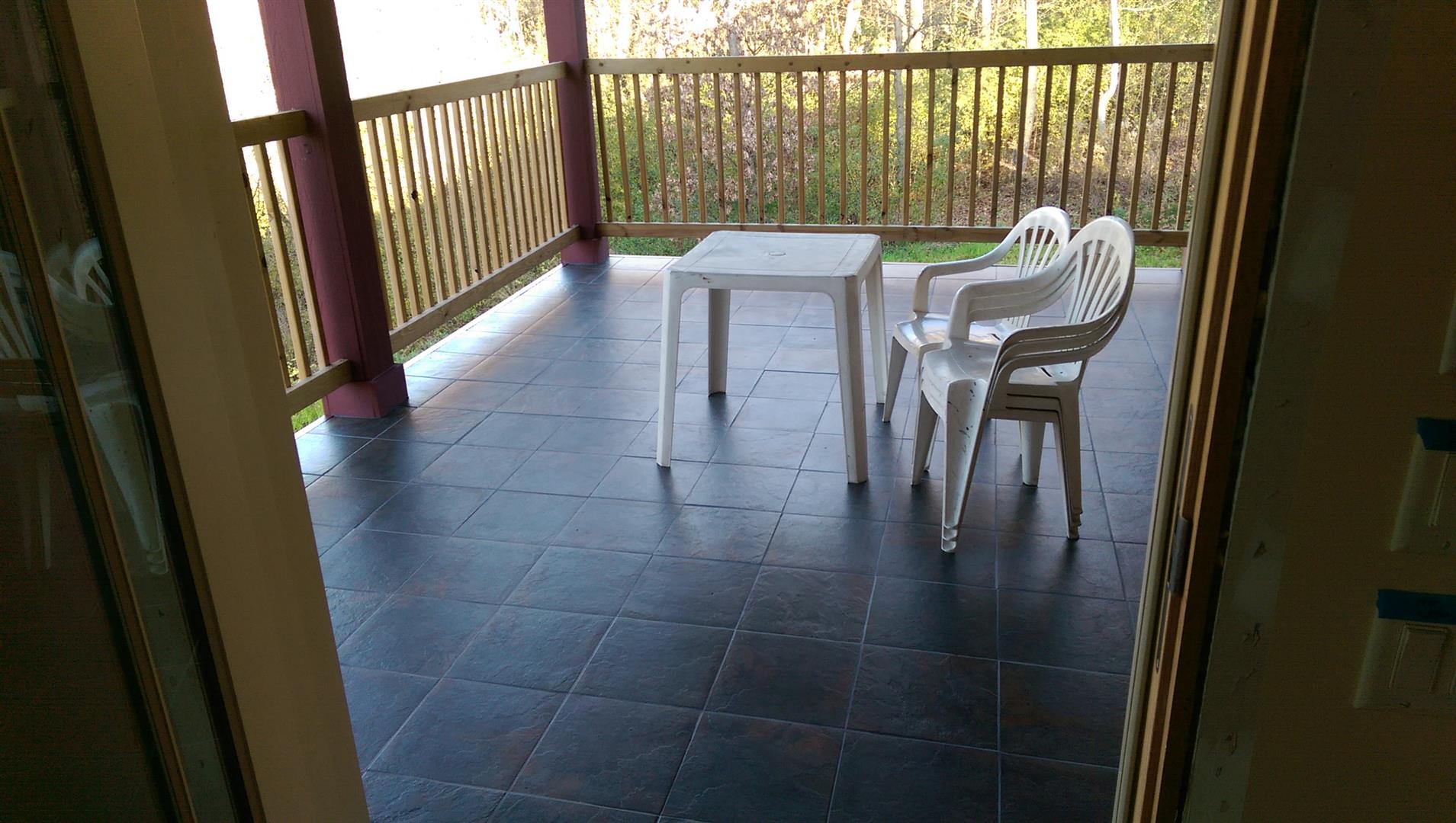

trying to get my head around this . 1x6 on the flat for railing. 2x4 on edge for installment of spindles. How does the aluminum spindles attach to the 2x4's? Whats your climate ? Cermic tile outside ?That wouldn't last a winter here. Cypress I guess your down south how is the Ctpress pretty true? The block in the middle eddy said is fine . Don't bother penetrating tile just anchor to bottom rail.:drink:
Well, the tile on my deck, having been through I think 3 Wisconsin winters now would disagree with you. I did my best to pitch the decks so water would not pool, used a very sturdy substrate of 2 layers of 3/4" treated ply and 3/8" backerboard, plus waterproofing. Of course the tile needs to be rated for freeze-thaw conditions but that is not hard to find with modern porcelain tiles.

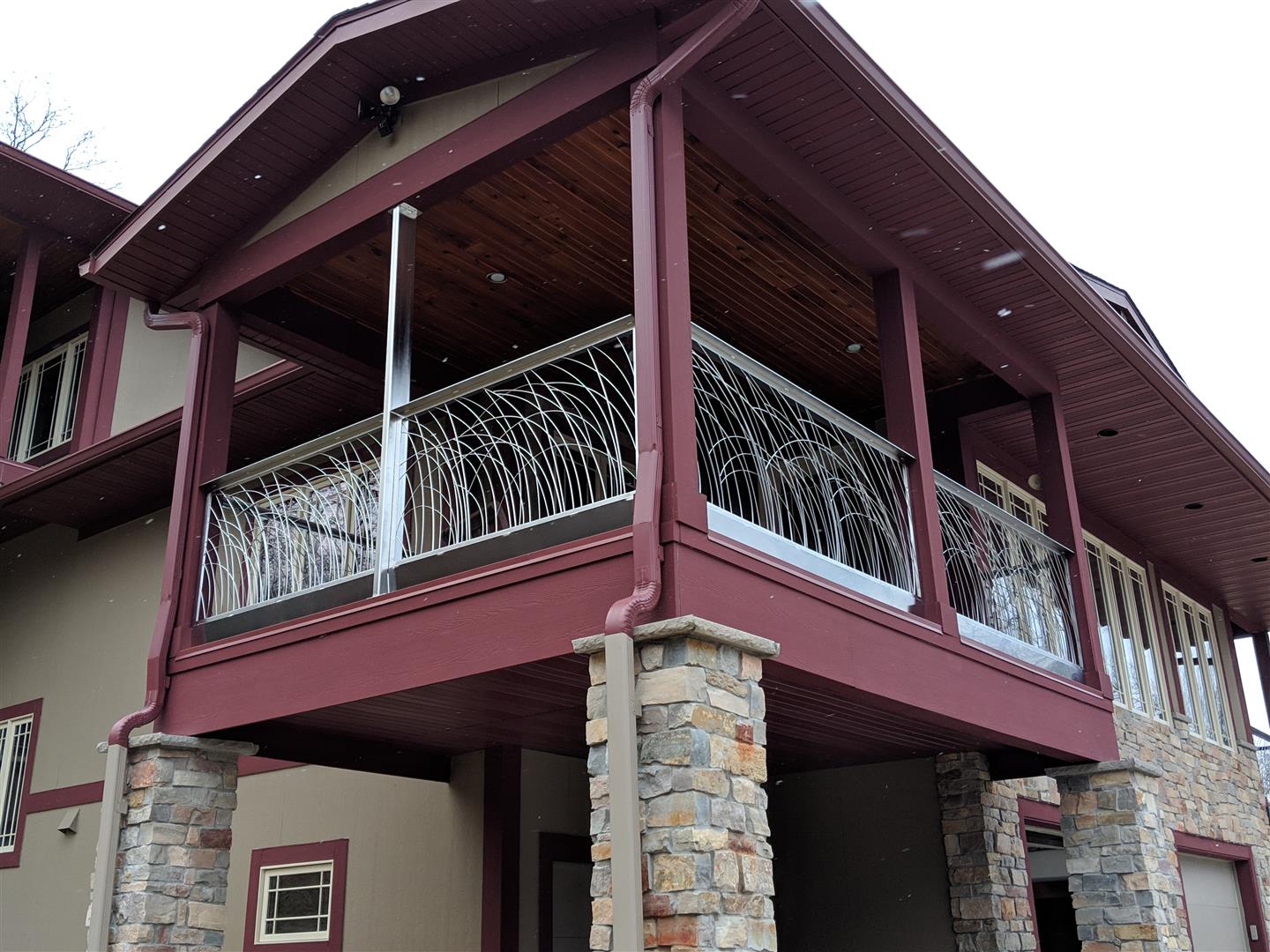

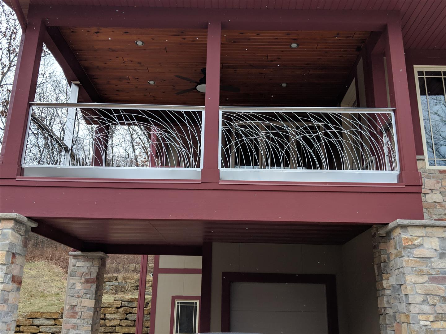

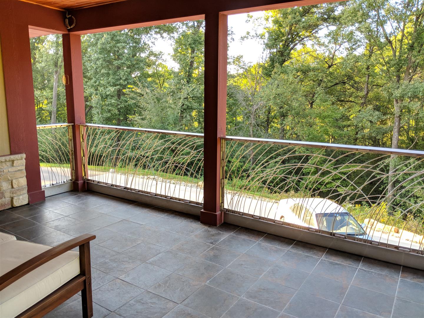

As for railings, you can go with just metal and make it very sturdy. Here is the railings I later completed for that deck. The cap rail is 6"x 1/4" and it is rock solid. Longest span is about 8'. The frames are 1.5" x 1/8" angle. Toe kicks are 14 ga with a 90 deg bend for a leg to sit on the tile. All 304 SS. Eventually this will get screened in.
