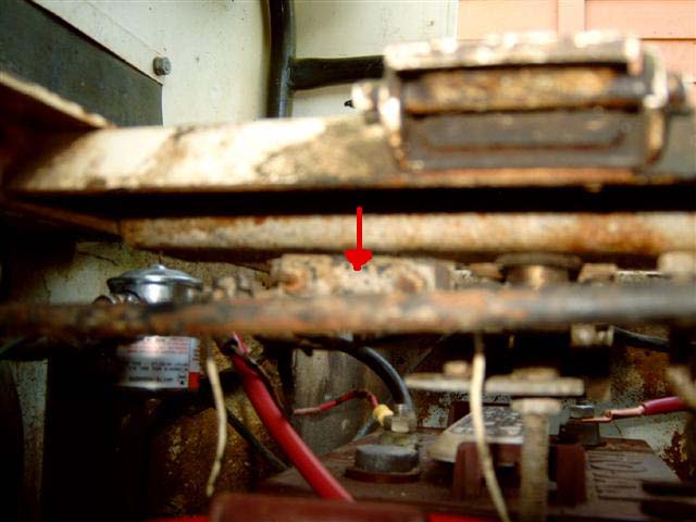

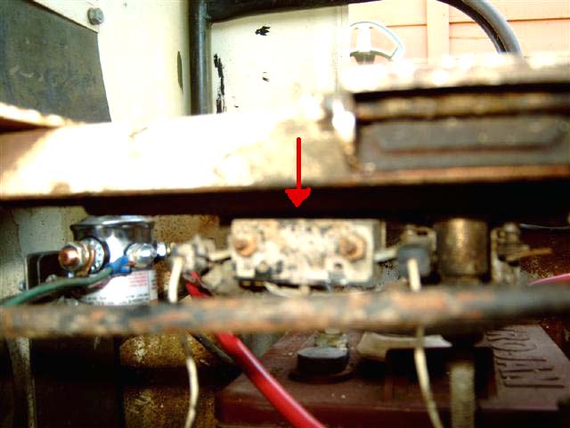

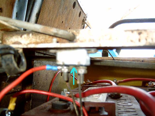

Ok Larry, here it goes with the pictures, the first few are of the items themselves and what I'm guessing they are, the last one is where everything is positioned. If you need more or better pictures let me know and I'll re-take some better ones.
thanks,
Steve

Im not sure what all those components are. Id really have to know the specific cart or be there to see exactly where power comes and goes to figure it out. I imagine they are all overcurrent protection - fuses.
The last picture is most useful. I am having trouble seeing both ends of the string. One is at ~5:00 and is a neg, right? Where is the other end? Hidden?
Larry

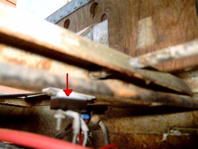

here are a couple more picture that hopefully help, the wire you spotted is actually the postive start of the string. I've taken a picture from the other side. The other picture is of the foot switch(labeled wrong in the picture), solenoid, and the possible overprotection thingamajig. As embarrassing as it is, it was wired up somehow when I got it but I "unwired" a bunch of it and can't remember where that particular thing was wired too as with the other two items. The cart is running great but I've got a feeling that these other items were used for some kind of accessories or something. No accessories were working or completely hooked up when I got it. All it basically had was broken tail light and horn, no front light. I'm trying to figure out why 3 of them and why the different sizes, etc. Let me know if you need more info.
thanks again

oh yeah, the positive start is going to #2 position on the F/R switch and the negative is going to the solenoid if that helps any.
/ Advice on electric golf carts #48
Weird. Black is positive - counter convention on Batt color code hookup.
As good as u are with a camera u gotta remember to take pictures before disconnecting. The item u have circled looks like a Temperature actuated switch. is it attached to something that might get hot? Typically, the way carts work in my experience is that the IGN enables the throttle, the throttle enables the solenloid and the controller. As u push the pedal, the solenoid switch closes, connecting to the motor. as u push further the controller is signaled to feed power thru the solenoid to the motor in proportion to the amt of pedal push. The controller is a solid state device and could warm or even get hot. It is usually attached to a finned heat sink to keep it from overheating as u climb a hill. See if u can find some evidence of this rationale in your setup. - - We dont need to fool with any of this circuitry for the accessories.
First, determine what voltage the accessories u want are meant to operate on. i imagine this will be 12,24, or 36. Im guessing it will say on them somewhere. - - - actually 1st I think u will want V gauges. I got mine from Marlin P Jones. 800-6526733, item#5332ME. They are 2-1/8W x 1-7/8H 15V meters at $7 ea. I got 3 and hooked them up such that each measured the output of 2 of the 6 batts in the string. This is much better that 1 gauge measuring all, but not quite as good as individually measuring each batt. A good compromise if you cant afford room for six gauges-who can? . I recommend this first - then on to accessories. Let me know how u want to proceed.
