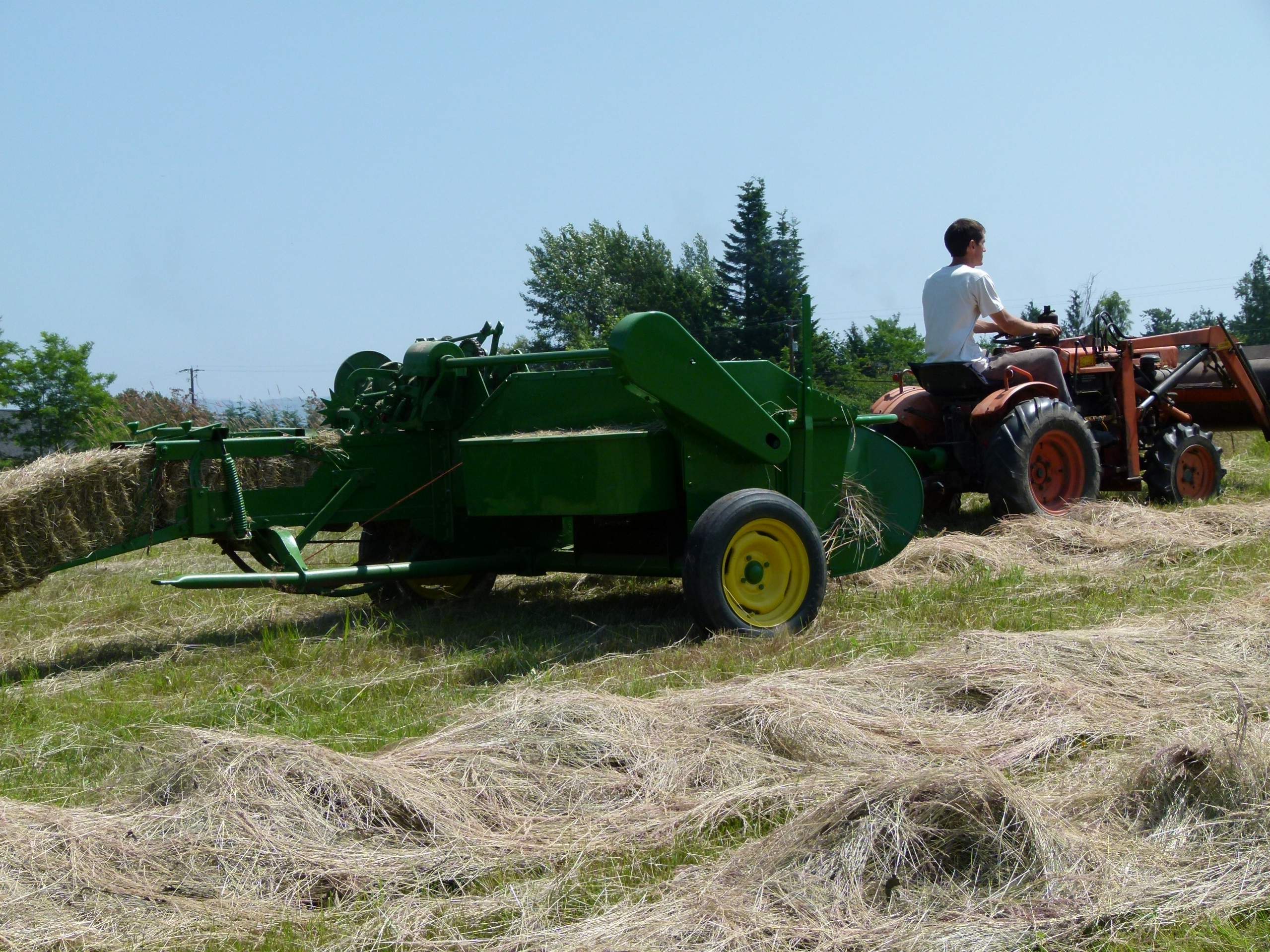

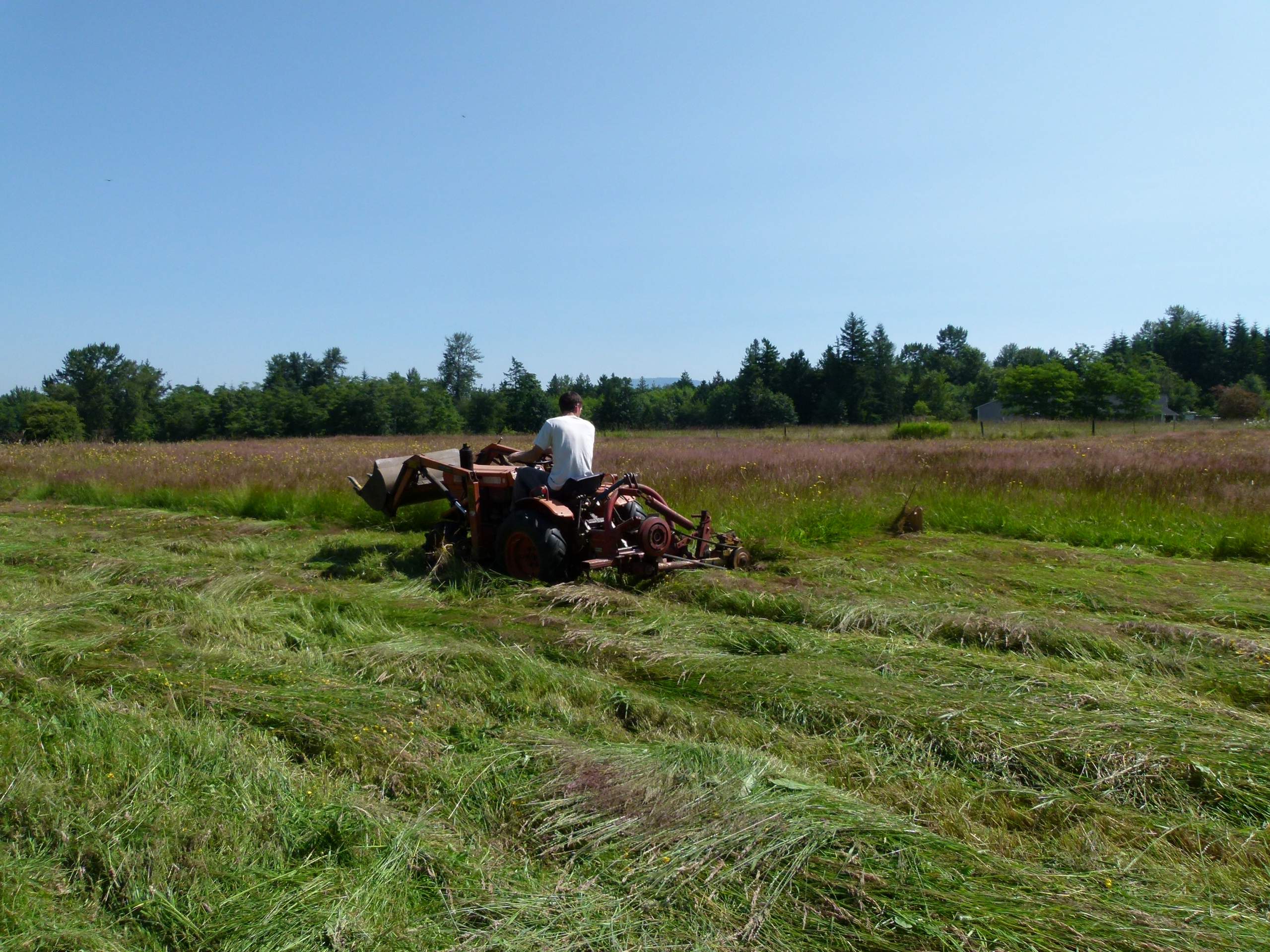

As follow-up on my earlier post: I found some pictures of mowing and baling last summer with my B7100DT (without a live PTO), JD 14T baler and NH 451 7ft sickle. No pics got taken of raking with the Kuhn 2 basket tedder/rake. The tractor pulled a bit to the right with that mower hanging out there, but I could hold a straight line.
My neighbor said he put up 16,000 bales with his 16hp B7100 before buying a bigger tractor. So haying can be done with a compact tractor, but they're not all built the same and some of the lighter-built ones may not be as durable.
With such a light tractor you definitely don't want to go down any hills, but on reasonably flat ground it was no problem. Baling uphill caused it to grunt (and puff) a bit, but plunger strokes didn't surge the tractor much at all... maybe old balers had better flywheels than newer ones to smooth out the plunger strokes.

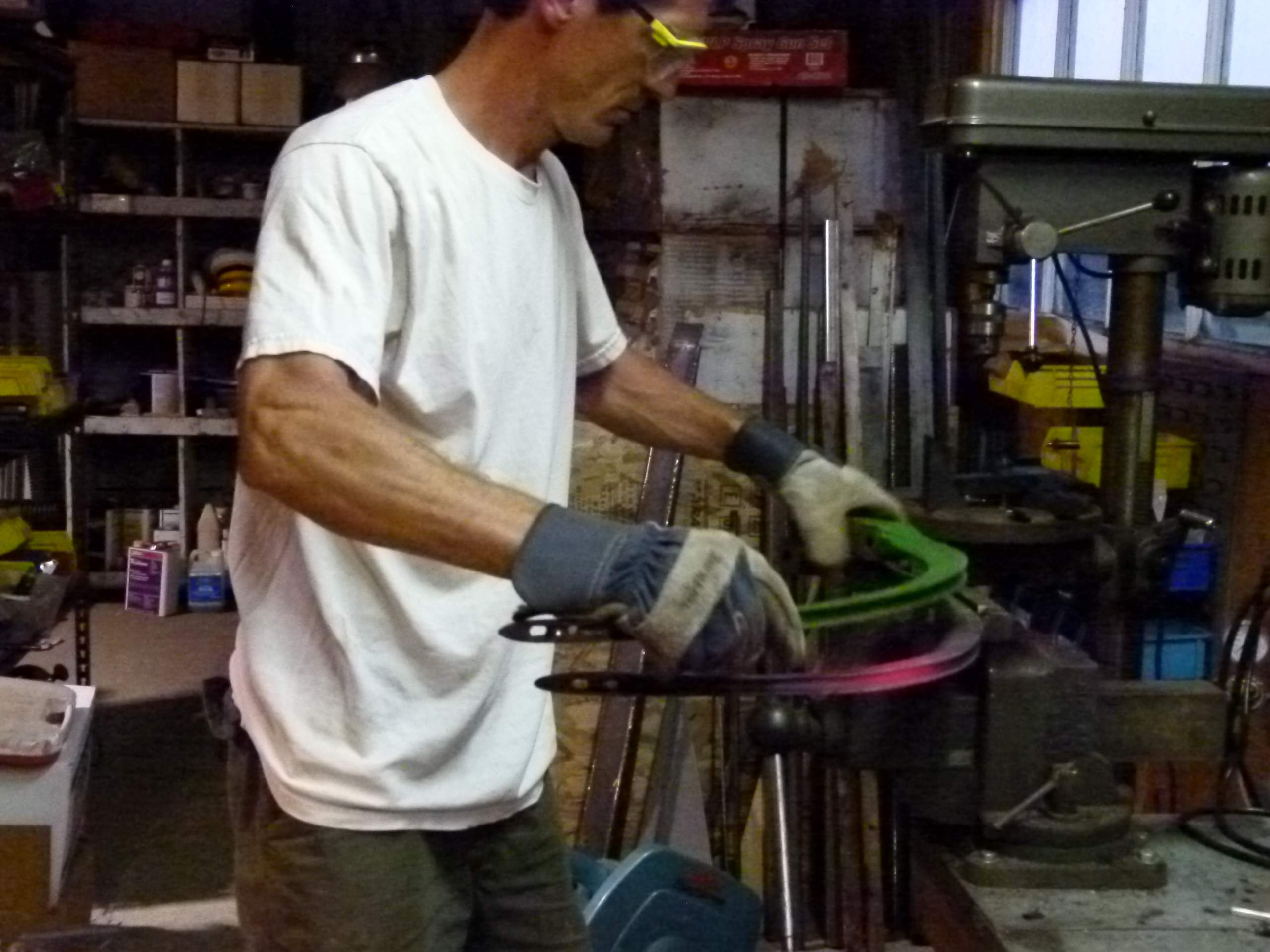

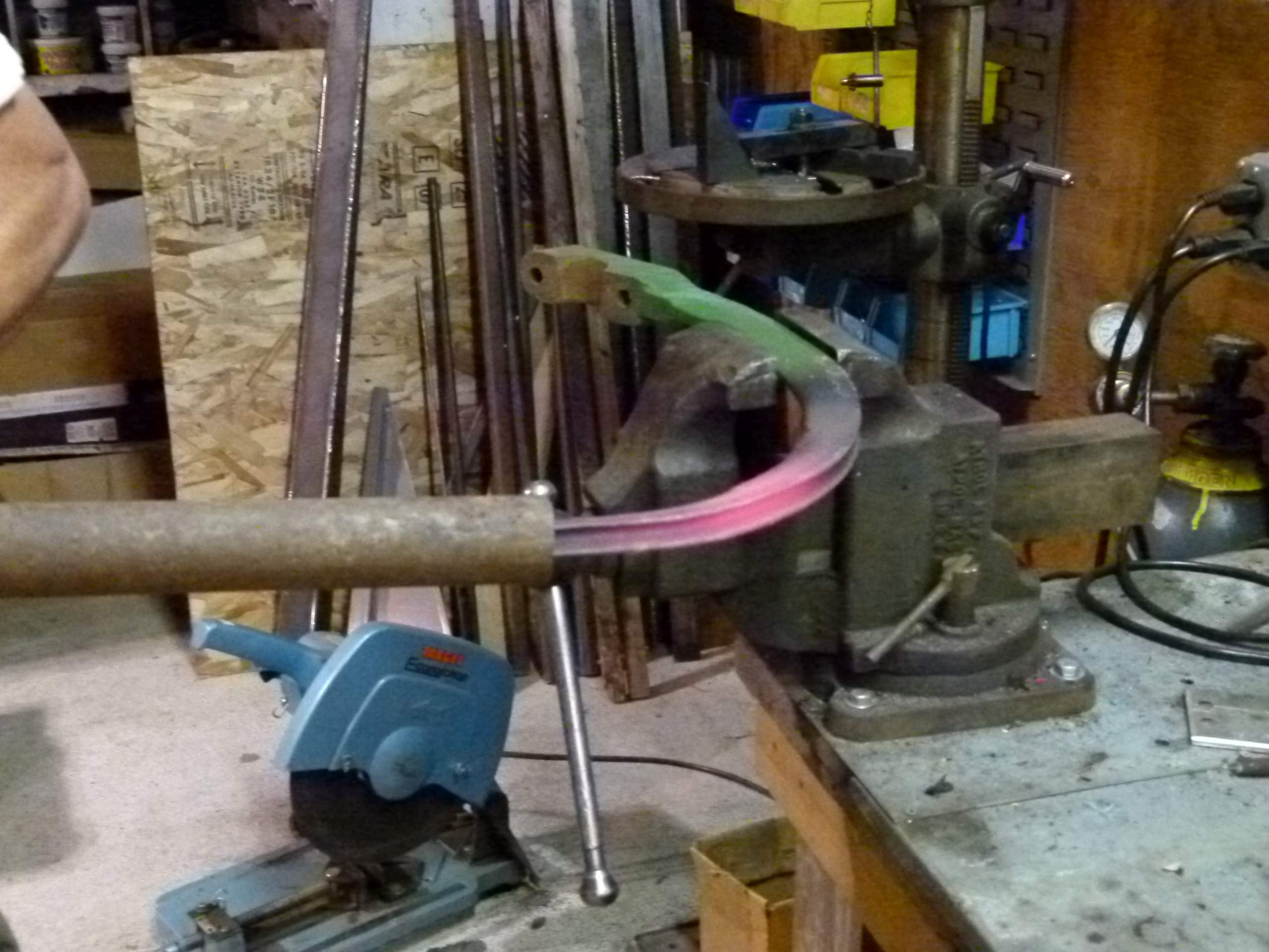

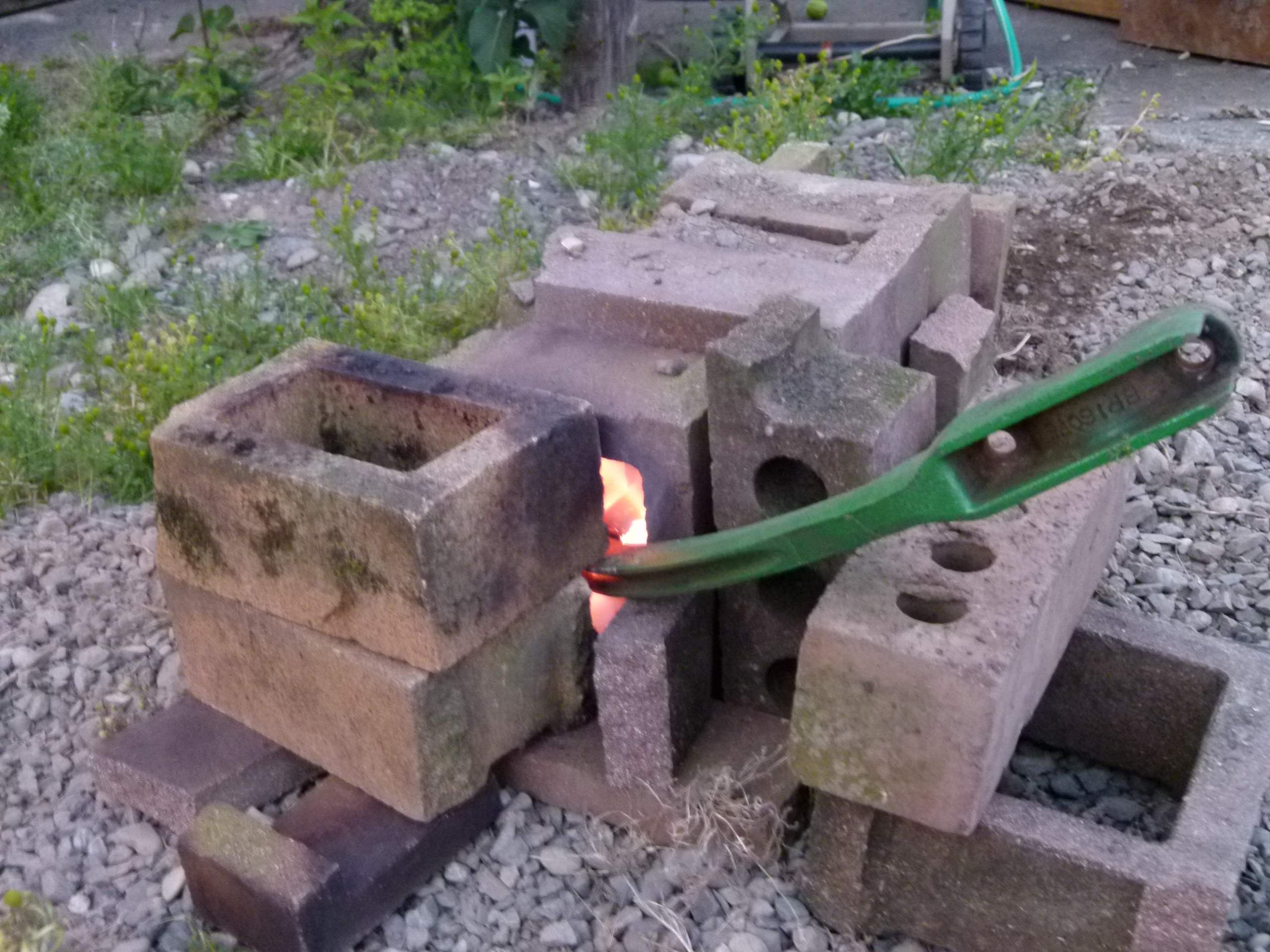

The last couple pics are recovering from the result of a worn clutchring on the knotter and a misadjusted stop dog in the bale chamber. After about 50 bales it folded up 1 needle quite substantially, but thankfully it didn't break. Of course this was early evening on a Saturday and no hope of getting a new one for a couple days, so I threw together a makeshift forge to heat it, then straghtened it back out good as new and got the rest baled and into the barn on Sunday.

Ah hum... Correction needed...you are baling with a "sub-compact" tractor not a "compact" tractor. Impressive and this is coming from a guy who actually bales with a compact tractor for several years now (my tractor is a Kubota L285 compact tractor around 23 hp at 540 rpm on the PTO and pics are on this sight. And I do NOT have live PTO either).
Older balers are generally much more suited for low hp compact tractor applications. Balers of the 1950's and early 1960's were designed to work with the common tractors most farmers had back then and statistically most of those were 30 hp or less in that era. The JD 14T was actually designed to work on the tiny JD 40 2cyl tractor as a minimum power unit. Of course it saw much more action behind JD B's and Farmall h's which were much more common in volume numbers. Rumor has it that the early Deere balers like the 14T had heavier flywheel designs to help compensate for the uneven PTO power pulses of their 2 cylinder tractor engine - which also helps for low hp applications too. As the 1960's evolved tractor horsepower increased dramatically and newer balers from the late 1970's on are typically designed for increased capacity and to still work with common tractor sizes farmers have - remember that it takes a decade or two for trickle down of larger tractors to the small time farmer who is usually buying used stuff. Pretty much all farmers now have much bigger tractors now so 50hp-60 hp or even more may be needed with a newer baler if it is a high capacity one.
Impressive makeshift forge and implementing an excellent repair. What is the heat source? Charcoal?
