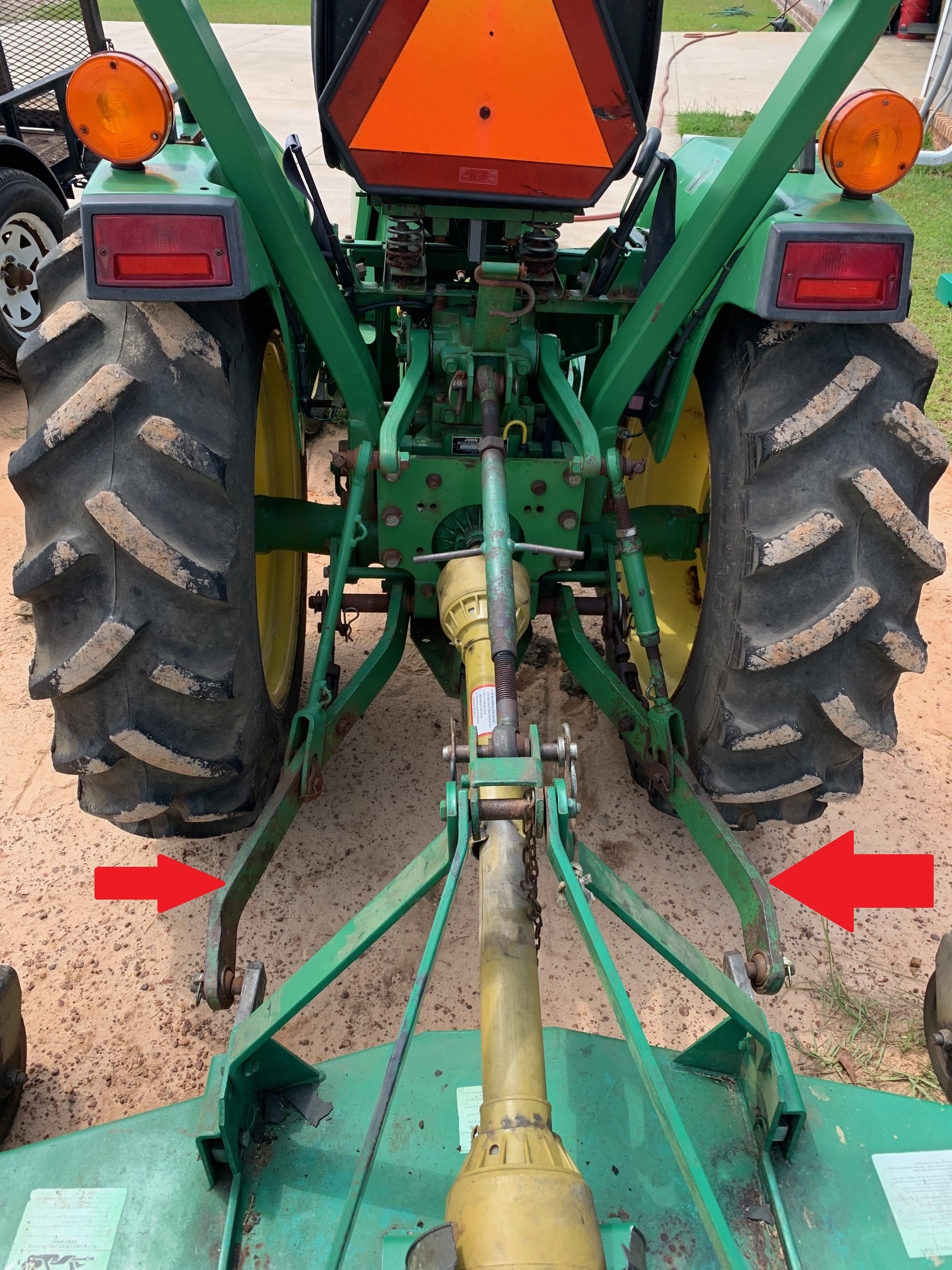

Good Evening everyone. I am a new tractor owner and looking for advice on a sway issue I've been having. I recently purchased a 6' finishing mower and hooked it to the 3-point hitch. However, when I take turns, the lower hitch arms hit the edge of the tires.....how do i fix this?

Tighten up your sway links and set your tires to the widest possible position.

If you don’t want or need to adjust the tires out, you could just flip the lift pins of the mower over. Then the arms would attach on the inside of the mower lift frame instead of the outside. That should give you plenty of clearance. Then tighten the sway arms as mentioned above.
/ Advice on 2000 John Deere 790 sway issue #6

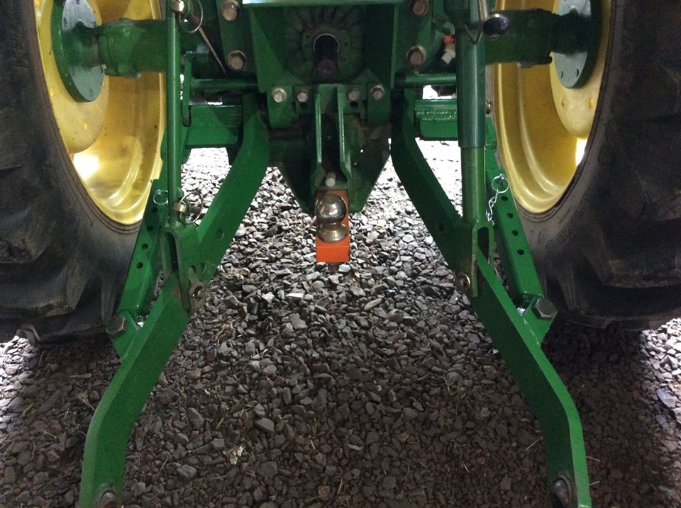

I also have a 2000 790, set up just like yours. If you adjust the turnbuckles to the point where there is very little sway (an 1", to protect the turnbuckles from getting stretched), the lift arms will not interfere with the tires. They get close, but they will clear. As suggested, you can also swap the implement link pins to the inside, which will move the lift arms in quite a bit. From there, you can switch the rims around, or get wheel spacers.
This is an issue with lots of compact and sub compact Deere tractors. I build telescoping stabilizers for a living, and see interference issues often. It is common for a new owner not to know about adjusting the turnbuckles, or that the turnbuckles are damaged or corroded to the point that they can't be adjusted. Their role is to keep the implement stable and to keep the arms away from the tires.
If the turnbuckles won't turn, they can be replaced. New turnbuckles are inexpensive, and adaptable. On my tractor, I built a set of telescoping stabilizers. However, they aren't a bolt on kit- the 790 required some alterations for them to function well.

I would suggest swapping the implement link pins to the inside - as a first choice. I can't tell if your tractor has AG rims on the rear nor if these tires are filled( RimGuard, windshield antifreeze, NaCl, etc). If the rims are AG rims and the tires are NOT filled - it's not that difficult. Jack up one side - move the inner rim hub to a more outward setting. Reattach and do the opposite side.
Just reversing the tire/rim combo won't cut it. It will put the R-1 tire tread pattern in a reverse direction.
