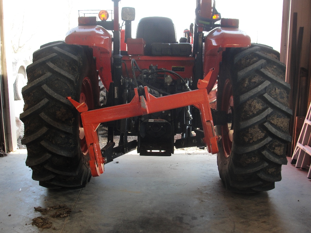

I am considering adding a hydraulic side link to my B3030. A year ago, I added a new control valve and a hydraulic top link and am now looking into completing the full Top-n-Tilt package. I will need another control valve for the side link and will probably go with a valve that has a float function.

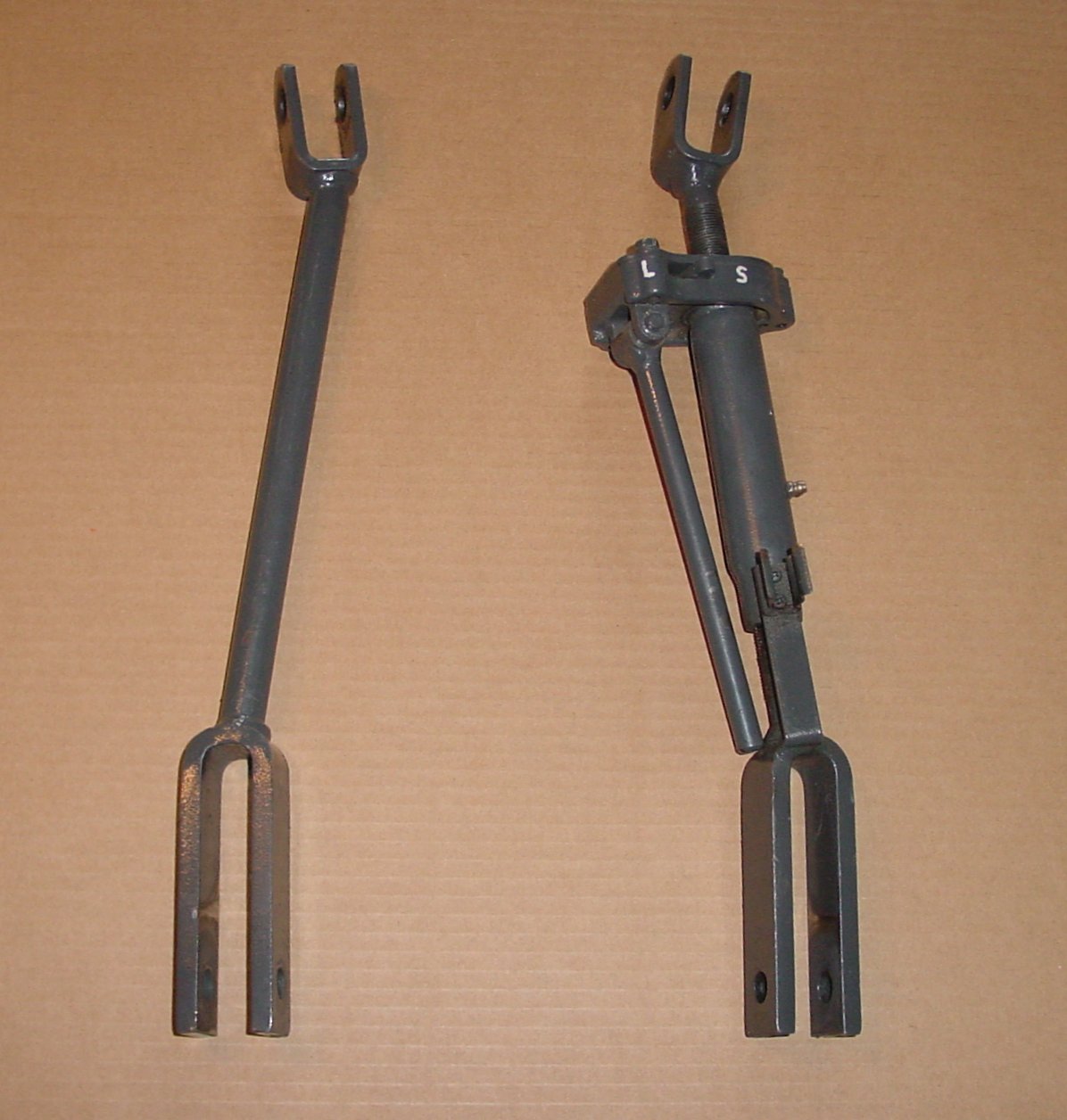

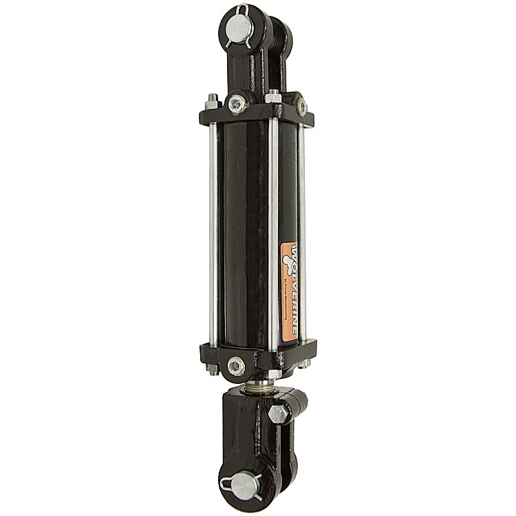

I bought the hydraulic cylinder for the top link from the Surplus Center website and am happy with how it works. For the side link, I need a cylinder that has a clevis pin setup on both ends and Surplus Center has a few different ones to choose from with a 4'' stroke. However, I am afraid that none of these cylinders will fit on my B3030 because the clevis ends do not have the same angle as the manual side link that I am replacing. In other words, the clevis end forks extend straight out from each end of the cylinder whereas the manual side link has the forks welded on at a slight angle. Here is what my current side links look like:
And here is the cylinder I am considering:
I guess my question is am I going to have alignment or binding problems using the new cylinder as it is. I know others have cut off the forks from their existing side link, cut off the forks from a new cylinder, and weld the old ends in place of the new. That is something I do not want to do.
Has anyone encountered this situation in the past and, if so, what was your remedy/solution. Any suggestions or advice is appreciated. Thanks

Using the original ends (of the side link) are the way to go...They are made that way for a reason and changing one side is likely to damage other parts of the 3PH...
You don't say why you don't want to do this but it's the only way to do it right IMO...
There is no need to destroy the existing (manual adjustable) side link...you can use the solid link (or buy one) and use those ends...moving the manual adjustable link to the left side will give you even more tilt if needed...

I bought cylinders, modified the ends and made my own. I saved considerable cost. But I had an equipped shop and the minimum skills that it required to complete it. You have to make the ends of your tilt cylinder match the technical shape/design of the factory system. Although you might think it just looks weird, it's shaped that way for a purpose. I also moved my factory adjustable link to the left side, this adds even more adjustment.

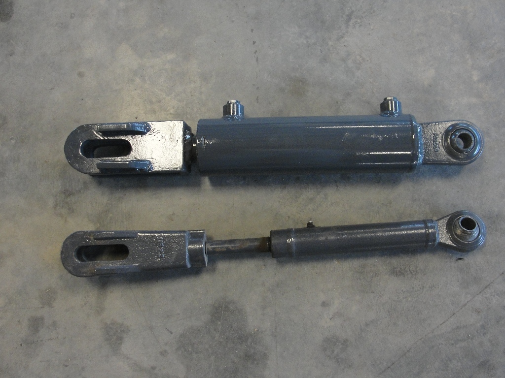

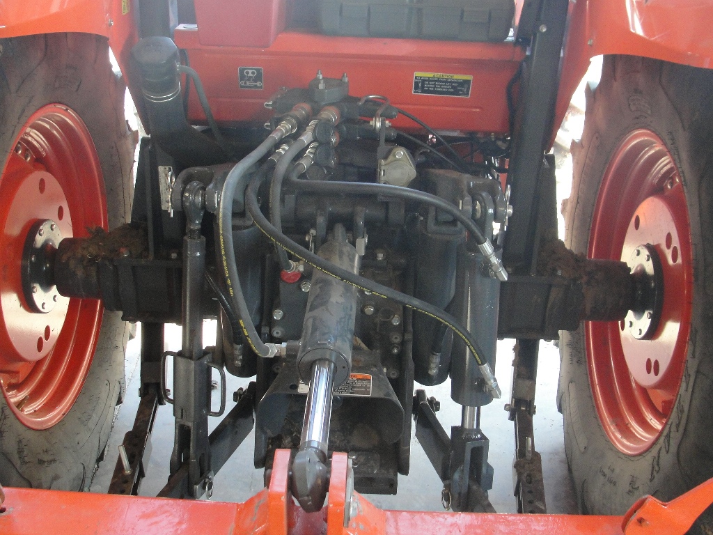

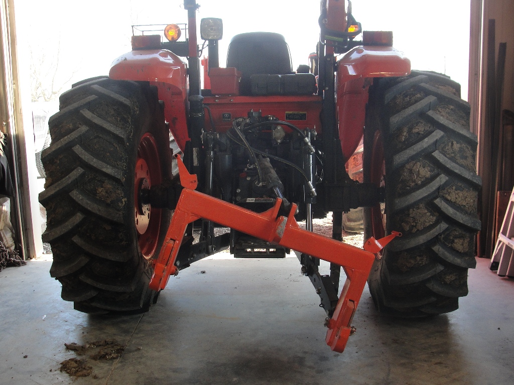

I'll add some pics, and as Larry said, if they are worthless to you, I'll remove the post.
