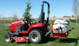

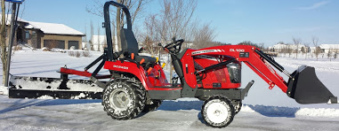

I have a massey gc1710, absolutely love that thing. With the loader and hoe off, it's only slightly bigger than my craftsman. But then on it I have 4wd, power steering, side by side pedals (I love that compared to treadle), and the mower on it is an absolute beast. If I let my lawn/yard get wild, I don't even bother with the craftsman...the massey will chew right through tall grass where my craftsman would get bogged down.
Happy with my 2011 MF GC2400!

I have a MF GC2310 . Great to mow with the loader and back hoe off. Belly mower works great and I tow a 60" finish mower . ROPS folds down to seat height so you can cut around trees. Wonderful machine. p.s. I prefer the treadle .

Thanks for all the replies. In terms of some of the questions. Yes, I make sure to have the loader removed when she mows with it. In talking to her it's the ROPS that her main concern as we have a lot of trees and obstacles to drive around.
Obvious question - since you said her main concern is the ROPS, has she tried using it in the lowered position? If she's not using the FEL or mowing in areas with tip possibilities, she should be ok with it dropped.

Have you considered MF GC1723E? Easy to take off loader (or maybe leave it off and just put on when you need it).
