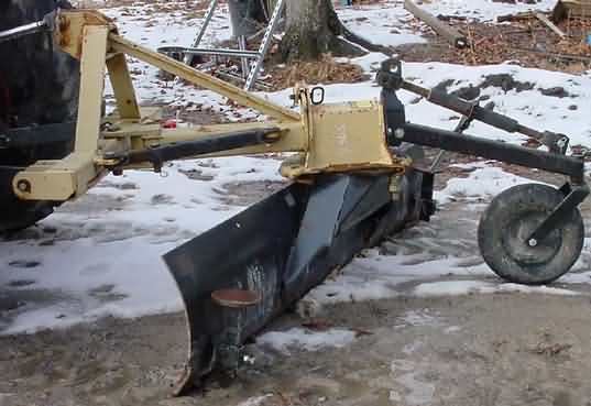

It takes time to get the hang of it. I've got the exact same blade as you. I really good investment is a reargauge wheel or skidshoes so the blade doesn't dig in to much. I've attached a picture of my blade showing the rear gauge wheel. In the pic's the skidshoes are on their mounts but upside down of course.
I'm gunna have a blast with this new camera.
Gordon

Well we finally got some more snow so I got to try some of the advice out. The ground here in Western Michigan is not even close to being frozen so it was a true test.
I first tried shortening up the toplink to make the blade less aggressive. That didn't seem to help a whole lot because the toplink was already set pretty short.
Then I tried rotating the blade around so that the convex side was to the front. This helped a lot but was still not the best method due to my driveway configuration. I have to pull the snow away from my garage and then push it into my turnaround which is 90 degrees from my main drive. When I would try to pull the snow with the blade convex, my tractor would run over the piles of snow that I pulled away from the garage and everytime the tractor tilted a little to one side or the other the rear blade would dig into the ground.
Then I rotated the blade again to its original position with the concave side toward the tractor. I swiveled my seat to one side and pushed all the snow while driving backwards. This way the convex side of the blade was still pushing the snow and the tractor would never tilt because the ground was cleaned up by the blade before the tractor traveled over it.
I knew that the swivel seat would come in handy for something. The Kubota that I was considering (L3010) had armrests but no swivel seat. The NH TC33D that I ended up with had no armrests but the swivel seat. At least I can add the armrests later if I want to.
Thanks Again,
Spence
