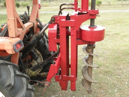

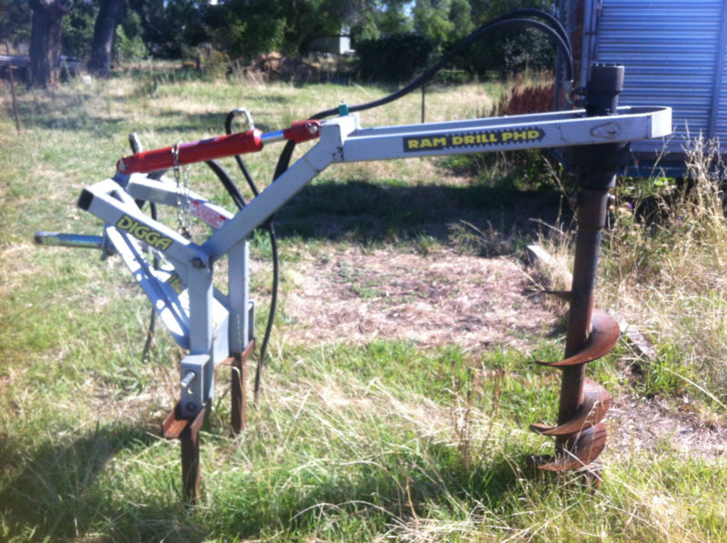

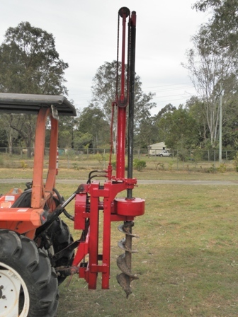

Our preference is for using post drivers where practical, but regularly drill holes mechanically at acute angles,using either PHD as pictured (depending on how many holes you're digging you may wish to upgrade to something similar):
- A (red) Proline PHD - a mechanical PTO PHD where the angles are only limited by the top link/linkage adjustment as the PTO shaft remains virtually straight at all times transfering drive through a chain to the elevated gearbox (yes, you can add as many drill/auger extension rods through the gearbox to go as deep as you want asthe tractor/PHD will power)
- A (silver) Digga Hydraulic PHD - the red ram in the frame provides downforce, a ram mounted in the frame connects to the drive box & alters/controls the auger motor drive angle & combined with a hyd top link/linkage adjustment you can quickly set a hole at any angle you want & being hydraulic driven the auger can be reversed (the drive box also disconnects & mounts on a FEL in a few minutes)

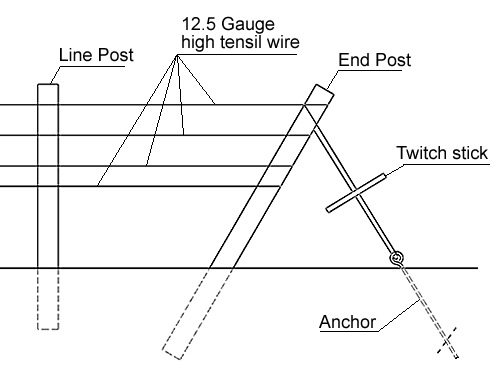

Hoping I do this with the auger I have. Trying to do something similar to this illustration:
How is that better than a vertical post with the same diagonal bracing? If the anchor doesn't move, the post won't move.

A Google image search shows many vineyards with vertical, near vertical, and H end posts, as well as angled end posts.
