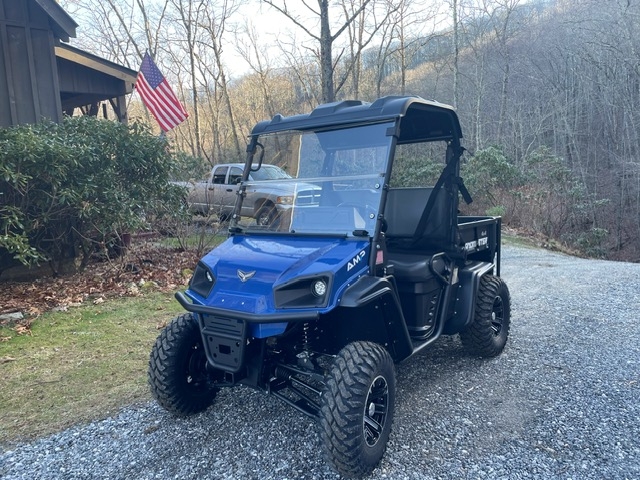

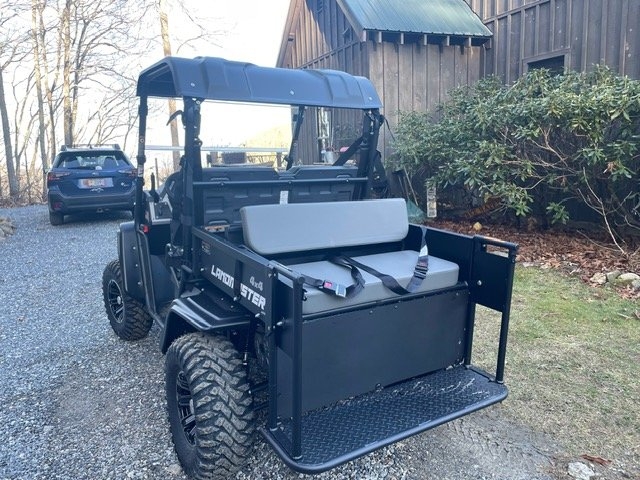

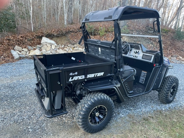

I have a battery powered side by side (UTV). It is a Landmaster “AMP”. It has a lithium ion battery, and has worked well for us. I live in a mountainous community with steep gravel roads. We used to get around on an old Club Car electric golf cart. I feel like the UTV is much safer.
We bought the Landmaster because it is made in the US and was available with a steel bed that converts to a back seat.
All of our friends in our community that have UTVs have gas ones. Kawasaki, John Deere, Honda, and Can Am. We bought electric because of the noise factor. When riding in our friends’ UTVs, you have to shout to talk to each other. I don’t care for the exhaust smell either.

View attachment 1583454View attachment 1583455
Very interesting. Is it 4wd? That's a must for where we are.
   / Adult battery powered ATV anyone have one #9
It is 4WD (selectable); and you can lock the rear differential.
Chris - We do get cold weather here in the mountains of Western North Carolina. The manufacturer recommends not using the UTV below 0; and not charging below freezing. Colder weather does affect performance and range. For my use, I have not found it to be a problem. My elevation is 4400’. It can get down to 0 in the winter; but extreme cold is not typical. Performance on hills is good. Downhill braking is helped my regenerative braking. It has 4 wheel disc brakes.
Stated range is 40 miles. The terrain where I use the UTV is extremely steep, and accordingly the range is less.
Jack
