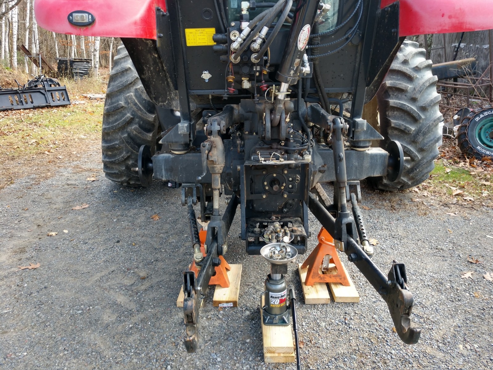

I'd like to adjust my wheel width a little wider on my YT359 just for stability on my hilly property. I can figure out the wheel adjustment, but how do you folks mount/unmount a rear wheel filled with ballast? I've got a 2 post lift, just not sure how I'd get a 600+ lb tire back on the tractor.

As long as you keep them mostly upright and carefully roll them around it's not an issue. I've moved many around just have plenty of room to work and go slow, if it starts to go you'll have to let it go. Once your going back on I'll usually use a bar on the wheel studs to line up the wheel and just slowly walk it on using the jack to adjust the tractors height to the wheel.

Jack the tractor up just far enough to get the tire off the ground a hair. Slow and steady and don't let the tire fall over.

Yep, also the same when removing it. After removing the lug bolts/nuts just push and pull it to walk it off the studs and out to where you can lean it up to continue the work. I use the front wheel to hold the rears when I'm doing so.
Here is my Branson 8050 with both rears and the center sections off in preparation to swap the centers in from being in the outer position. Both of the rear tires are leaning up against the front tires.
