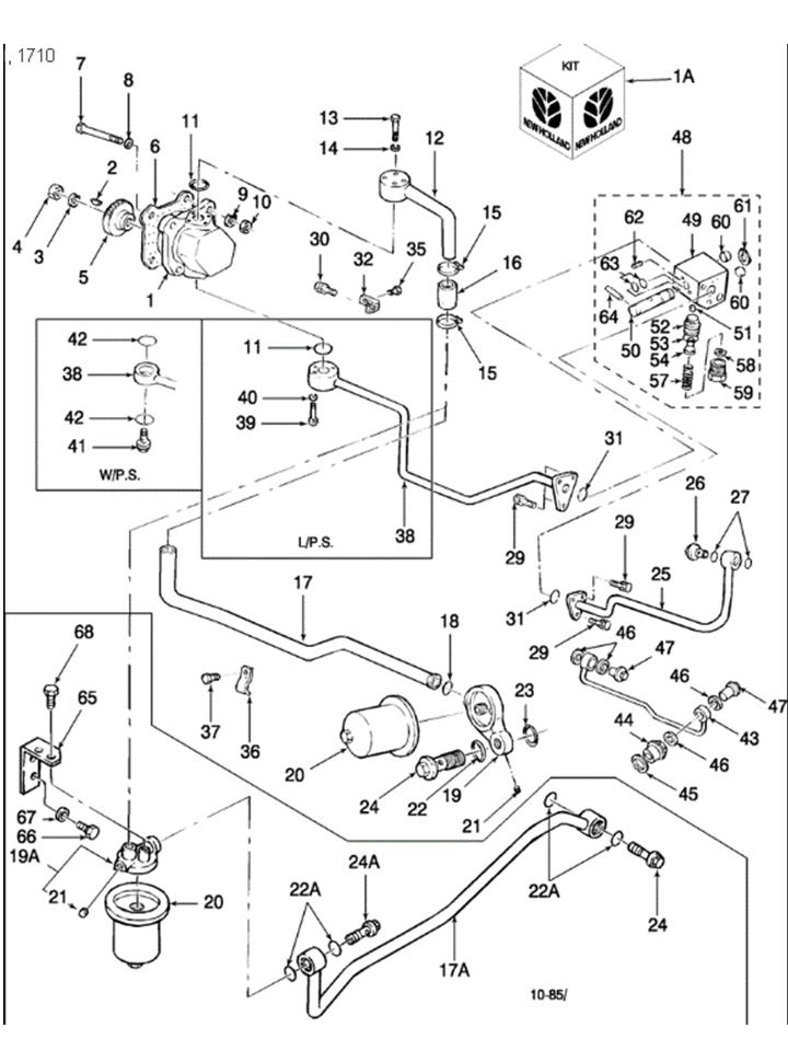

Yes JC, the 1710 models after 1983 had the pressure relief block (diverter valve actually). Once that pressure is set, any additional pressure relief can only adjust the pressure lower. Here is a hydraulic diagram of the 1710 with item 48 being the diverter block. The pressure adjusting shim kit is item #58.
