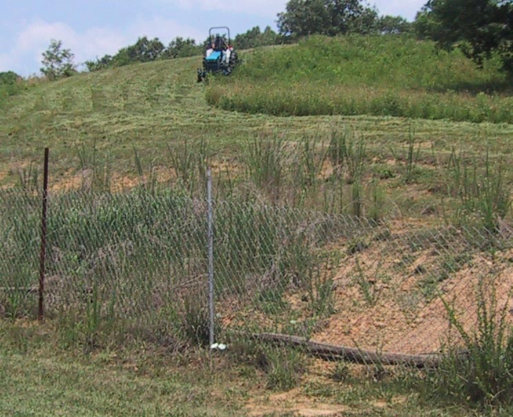

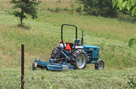

I have a 5' Kingkutter when I set it up on tractor I try to have level all way around about 4" to 5" off ground . I would neaver set front lower than rear.you want to cut level. if you are having trouble going through dips I use chains in place of struts on mower. see picture.
