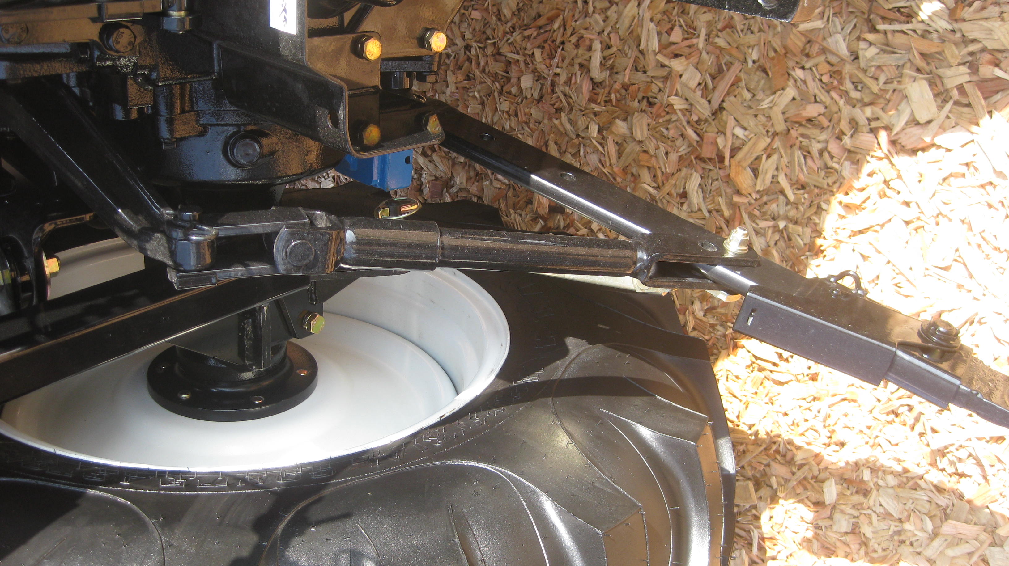

Can anyone think of any cons to having adjustable lift arms on both sides (left and right)
   / Adjustable Rod Assy lift arm #2
As in top 'n tilt? That's what I have, hydraulic one side, crank on other. No negatives I can think of.
   / Adjustable Rod Assy lift arm #3
Cost is the only one I can think of.

$168 , Cost not bad , can't get angle I need on box blade tilting left without adjusting end bolts ,plenty of tilt to the right unless the bolts were adjusted for left tilt.

No cons that I'm aware of ---- I have adjustable lift rods on both sides. I found the second one on E-Bay.
   / Adjustable Rod Assy lift arm #6
If I was going to do it, I would probably buy a hydraulic tilt cylinder for the right side and move the factory manual leveling box to the left. That way you would only have to manually adjust the left ever so often but have on the fly adjustment on the other side.

Thinking the hydraulic is the way to to go , upon closer inspection replacing the fixed rod with a leveling would do very little to help , when extended its the same leanth as the fixed rod is now... , would someone please list what I need to convert to hydraulic cylinder ...(cylinder size , hoses , coupling
And are flow restrictors needed

Something sounds VERY wrong. The adjustable side link should be half way extended to be the same length as the fixed link. Collapse it to tilt down to the left, extend it to tilt down to the right. Are the pins in the same hole location in the lower clevis? Either both in the top or both in the bottom pin location?
Sorry for the side ways picture.
Your picture is not sideways when you click on it.
