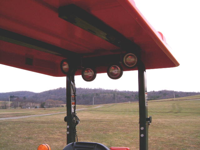

George,
This is a picture of the lights I added to my machine.
Truck/tractor lights from Wal-Mart. Around $12 each if I remember correctly and they work quite well.

/ Additional lights. #7
DK35vince,
nice light set up I not bashing you, but don't they kind of 'blind' when you look to the left or right? can the lower ones be aimed at the 3-point?
My thought and I could be totally wrong, wouldn't they be better suited in front of your head. Then I suppose the back of the light may create blind spots also.
In either case how did you wire them things up?
steve

</font><font color="blue" class="small">( Cool. How did you wire them in? )</font>
Sorry, I was out of town a couple days and just got back..
I had a wiring/trailer type plug in the back of my tractor near my 3 point hitch that had power when the headlights are turned on. My middle 2 lights are wired to it (they come on with the headlights).
The outside 2 lights have a seperate switch and I got power from the factory rear work light wiring.
/ Additional lights. #14
</font><font color="blue" class="small">( nice light set up I not bashing you, but don't they kind of 'blind' when you look to the left or right? can the lower ones be aimed at the 3-point? )</font>
My middle 2 ROPS lights aim straight ahead, the outside 2 lights are aimed to the side so I can see left and right.
I also have a rear work light just behind my seat to see out the back and the 3 point.
/ Additional lights. #15
</font><font color="blue" class="small">( My thought and I could be totally wrong, wouldn't they be better suited in front of your head. Then I suppose the back of the light may create blind spots also.)</font>
Steve,
The lights being behind my head do leave a slight/mild shaddow.
I would have liked the lights on the top/front of my canopy but I'm sure I would tear them off with tree branch's Etc.
I was concerned moving the lights farther forward under the canopy would have been a head banger getting on and off the machine.
