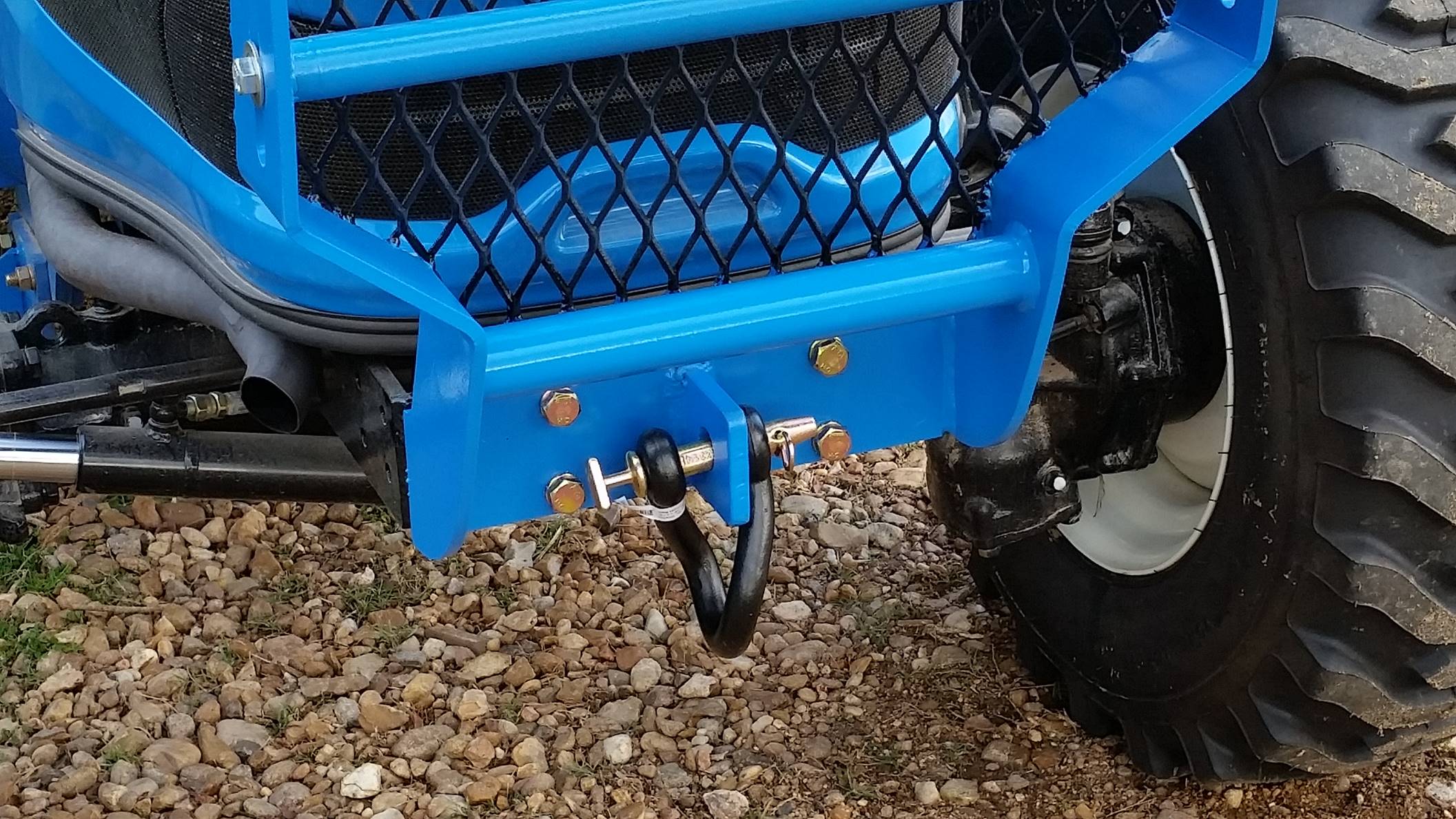

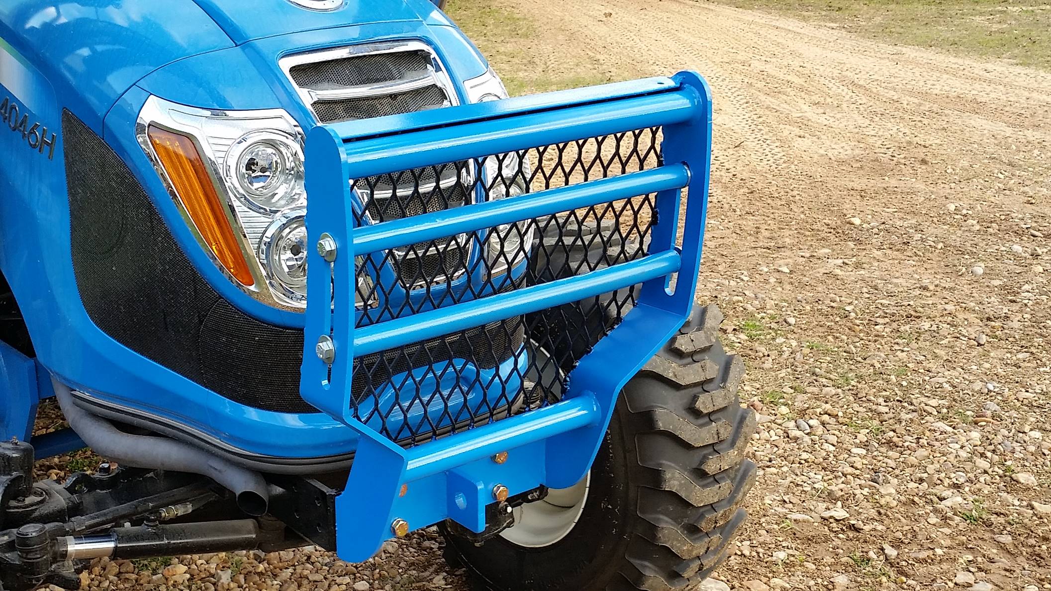

When I modified the grill guard on my LS XR4046HC I added a simple padeye. When transporting I install a Clevis to run chain thru. BA35596E-0ABA-479E-A560-67E218696803.jpeg3B271F70-D533-424B-9C56-AD9B929BC37A.jpeg
Just moved grill guard to my new LS XR4155HC yesterday for Trip to Ranch.

When I modified the grill guard on my LS XR4046HC I added a simple padeye. When transporting I install a Clevis to run chain thru.View attachment 530277View attachment 530278
That looks great! I plan to beef up my brush guard on my NH Workmaster here soon and been thinking of how I wanted it. I like how you put the expanded metal on the back, gives it a cleaner look.
   / Adding tie down points to front of tractor #18
I just traded in that tractor for a new LS XR4155HC last week but, kept my grill guard. It worked great to secure new tractor for Trip Home from Austin. Kept my bucket as well because I already has 3 bucket hooks and Piranha Tooth Bar.
