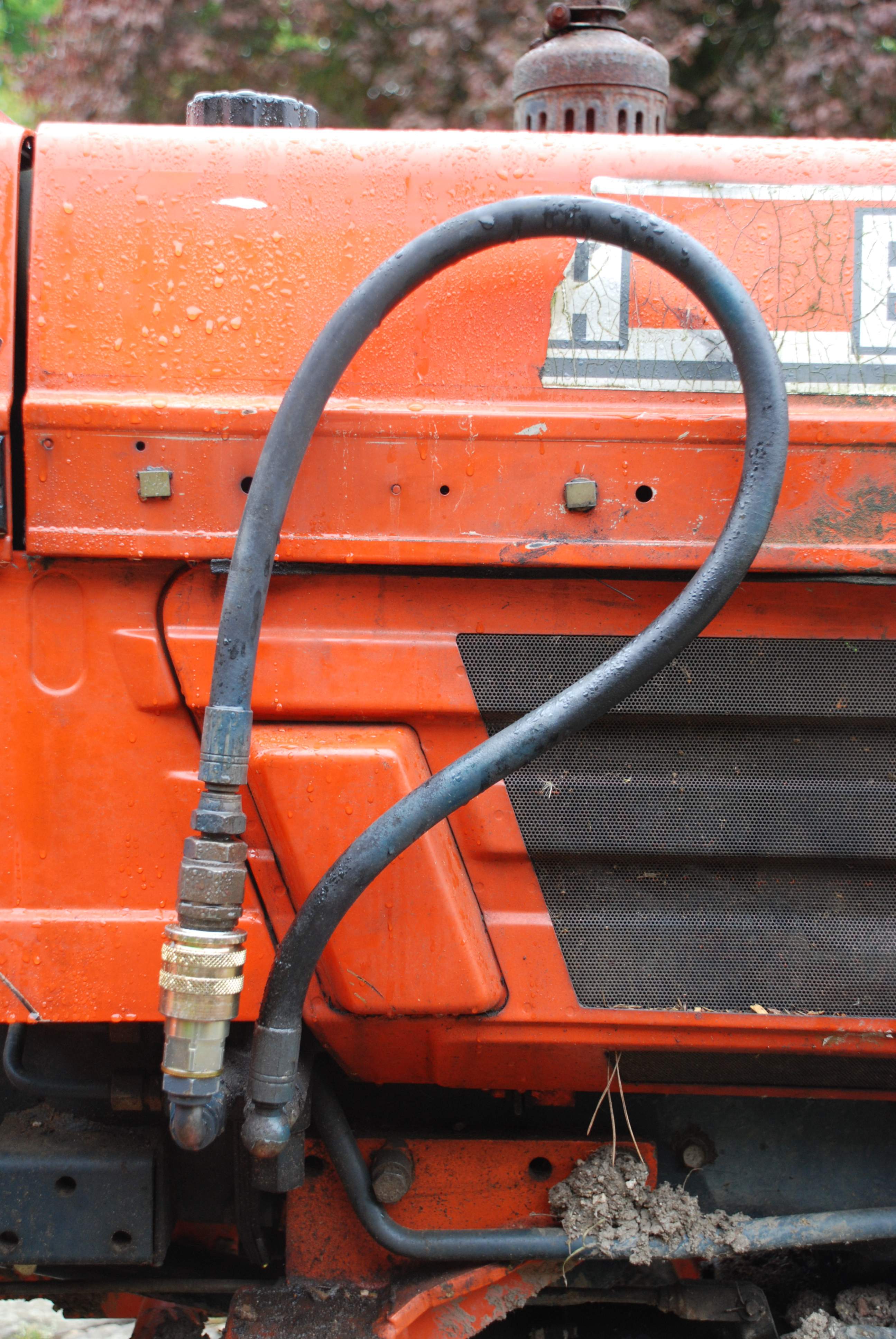

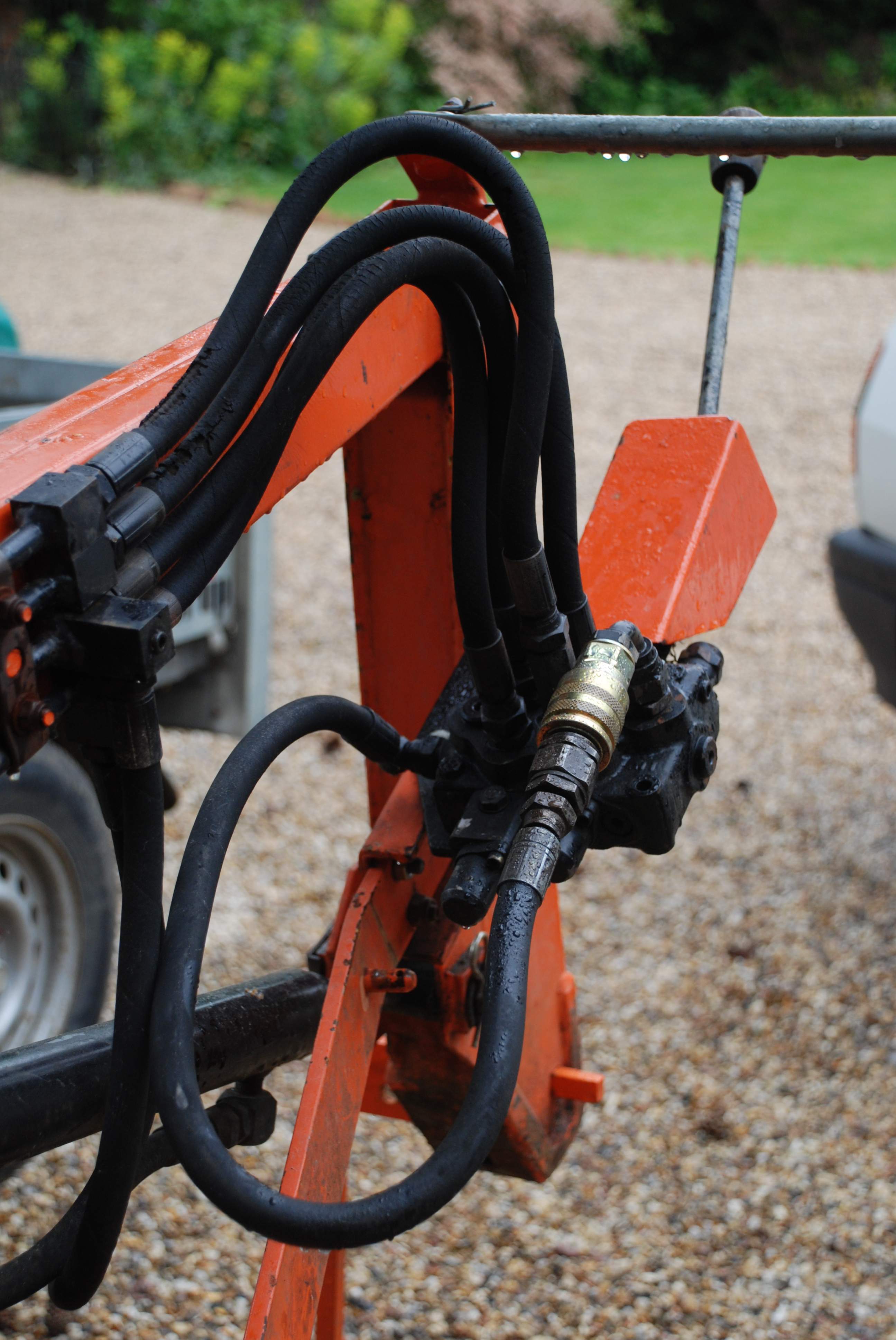

There is nothing visibly labeled PB - just in and out on the loader valve block. The loader valve block remains on the loader when detatched.
I have taken a couple of pictures - the loader is off today for mowing if the rain stops!.
On the tractor and the loader there are two new (shiney) female quick fits on the 'out' side of things. In the photos, the 'in' pipe and 'out' port are looped together on both the tractor and the loader.
When loader is fitted, the pipes currently looped into the female 'out' ports are swapped over - so the pipe on the loader connects to the female port on the tractor and vice versa.
I had assumed that the 'out' pressure from the loader was still high and that it was not some form of low pressure return. This would suggest I need to go for option 2 and get the rear valve block with PB to go on to supply the loader and find way to connect the third (low pressure return) from the rear valve block into the gearbox sump - or could/should it be Tee'd into the existing low pressure return?

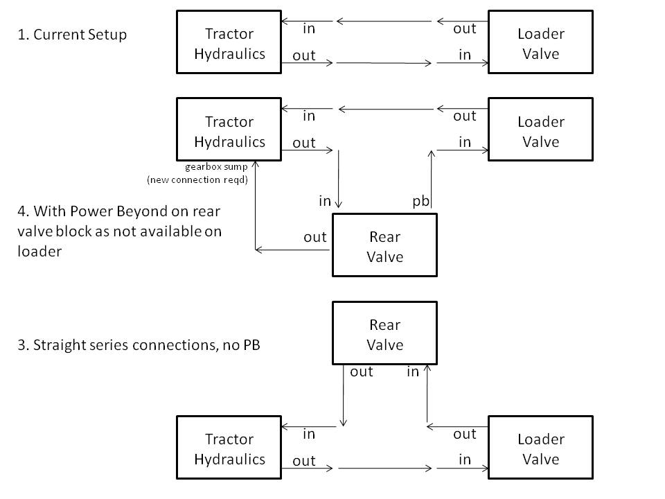

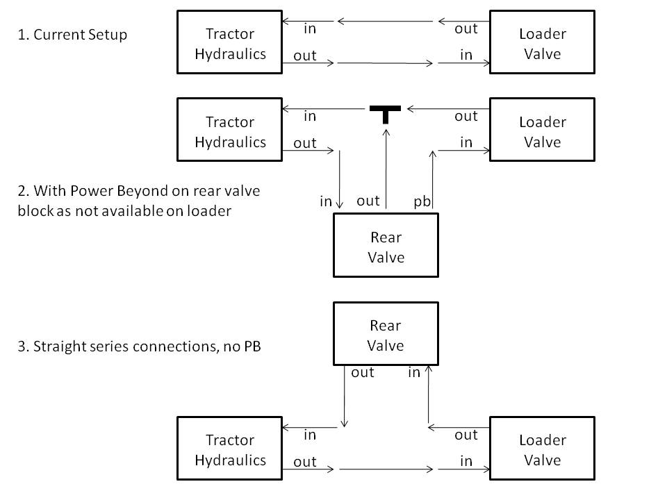

I have tried to put the two designs above into a picture - sorry, I am not very good at Powerpoint.
Is it a case that either will work? Will the T in no 2 be an issue?

You CANNOT Tee into high pressure lines. ALL valves MUST be added in series. If you Tee into the lines, the fluid will "take the path of least resistance" and you will not get any usable flow at either valve.
So your drawing #2 will nor work. To add a PB valve, you still plumb in series...but the PB (BYD) port goes to the next valve in the chain, and the T (or OUT) port goes to the tank to take care of the waste oil from the work ports.
Clear as mud;)

Thanks for the advice - diagram 2 was based on the premise that output from loader valve was low pressure.
Diagram 4, I think, reflects Kenny's latest advice.
Diagram 3 looks like becoming my favourite.
J
J
Yes, now you got it;)
