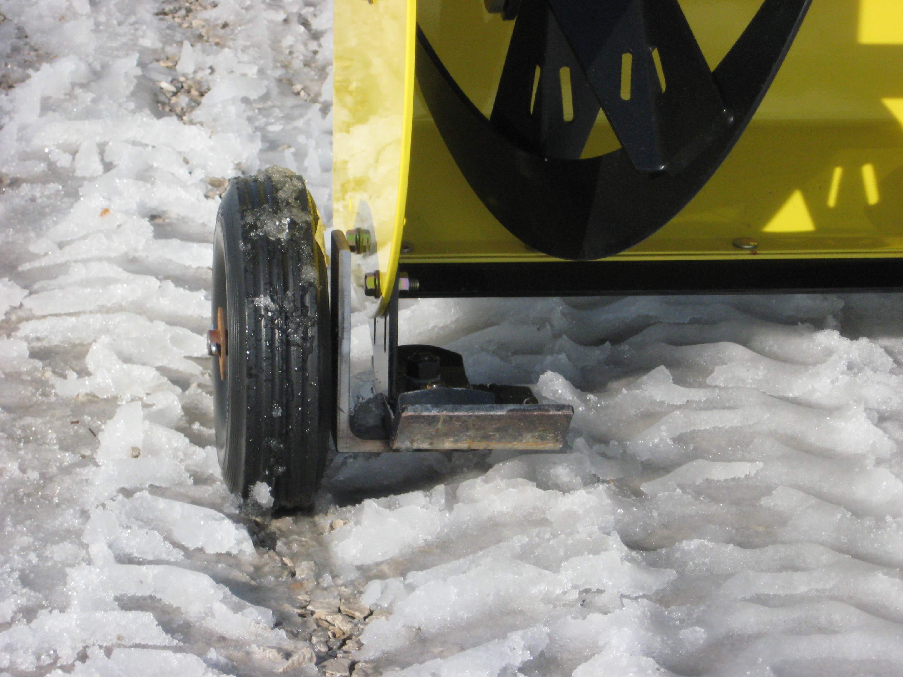

I made up some gauge wheels for my blower that mount to the skid shoes. I think it rides on the gravel better than the skid shoes, but haven't actually tried it out in snow conditions yet. I'll have to report back later.

Might work for an itsy-bitsy light weight blower but my Lucknow weighs 1500 pounds. Round tires, as a rule, don't roll well on snow. They slide.:D

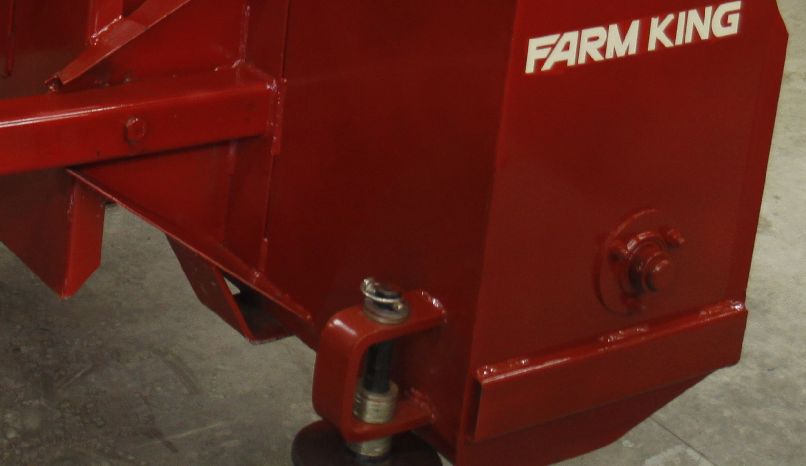

Most john deere dealers also sell a weld on adjustable hardened skid shoe kit. Ive seen them at several dealerships and put a set on my old farmking blower. Was real easy to weld on.

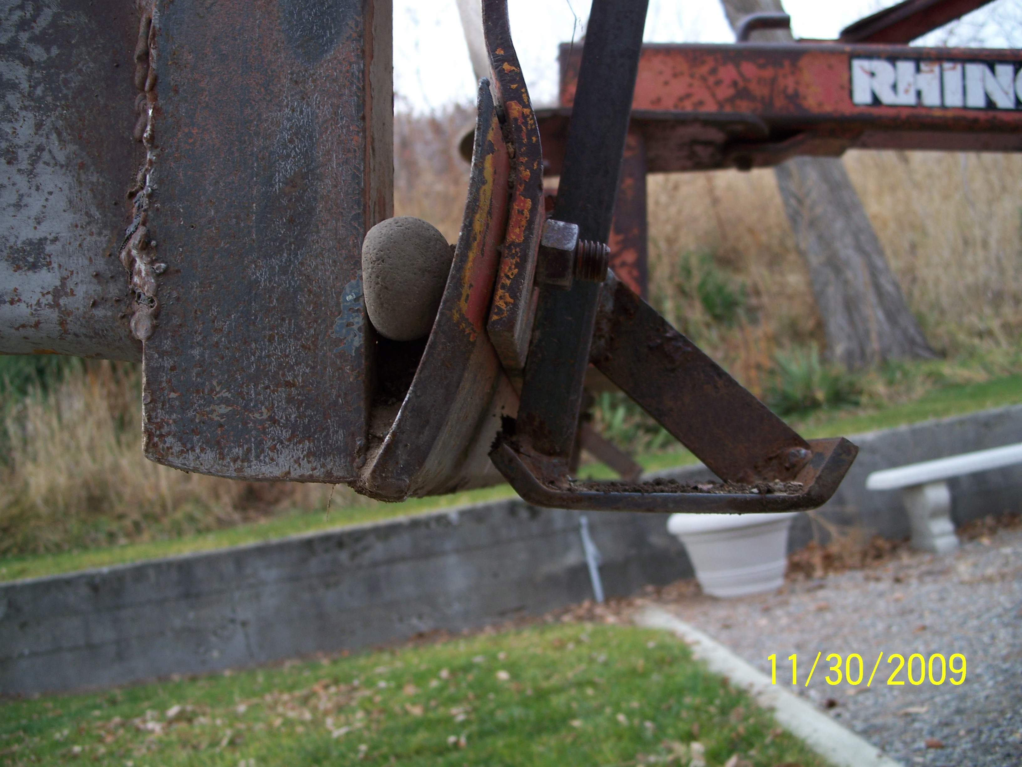

I had the local machine shop bend some shoes for me... Welded them to brackets that are adjustable and attach to bolts on my blade.. Maybe something like this will work for you... Dave

I've been using this snow blade for twenty years. The same skid shoes have been on the front for that long. I added the rear ones when I converted the blade to my tractor. Seeing I do pictures here are a few. The skid shoes cost me $23. each including the shoe,pin and washers.

Those won't work at all in deep wet snow on gravel because they load up and slide. You'll never find any kind of wheels on any commercial plow for a good reason.
Why try to re-invent something that works well, is basically maintenance free and is cheap (skid shoes).
The exact same design I have on my Lucknow. Those are (I believe) Meyers style skid shoes. I achieve my spacing by adding flat washers between the pad and the mount. Mine are going on 5 years of road work (I blow off the road between the farm and the paved road, about 1.5 miles) regularly.
Commercial plows tend to run Meyers style as well.
