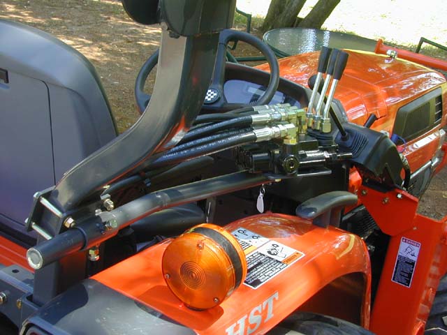

I have had a number of folks asking about my tractors remote/valve/TnT setup. I have one more picture of it but have not had time to take anymore but will. It may well be of a very dirty tractor as it has been getting a bit of a workout after our first rain of the season moistened the soil up beautifully. I have a Dinoil valve body. The TnT cylinders are made by Gannon. Your dealer can give you the exact lengths, its in the Gearmore or Gannon book. All the quick connect couplings are Pioneer. The valve holding bracket is homemade and built of simple 1" tube steel and 3/16" plate. I'll try to get some measurements of it for those interested. I understand the curiosity here, having TnT and one other remote is really what makes my tractor "sing". I cannot imagine my tractor without it. That includes the tilt feature. Mark "Rat"
