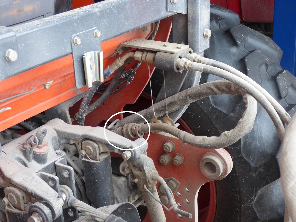

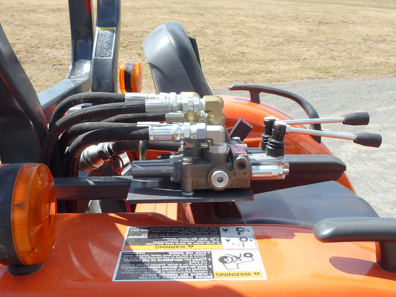

I used that same Prince 2 spool valve when adding 2 rear remotes to my old L3430 HST. I made a simple bracket bolted to the ROPS which held the valve just above the right fender. The Prince valve works well since the spool control arms can be mounted horizontally as well as vertically.

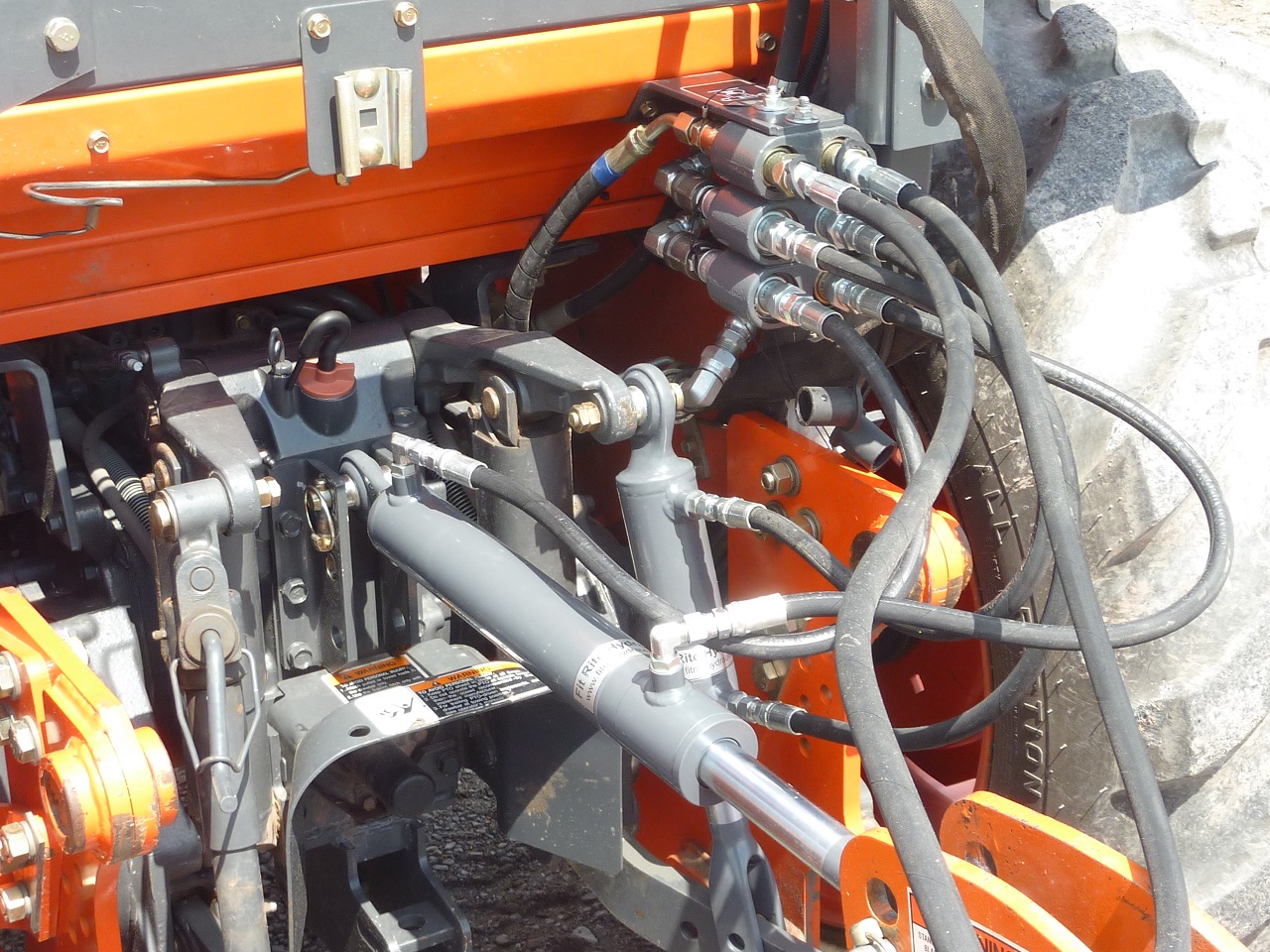

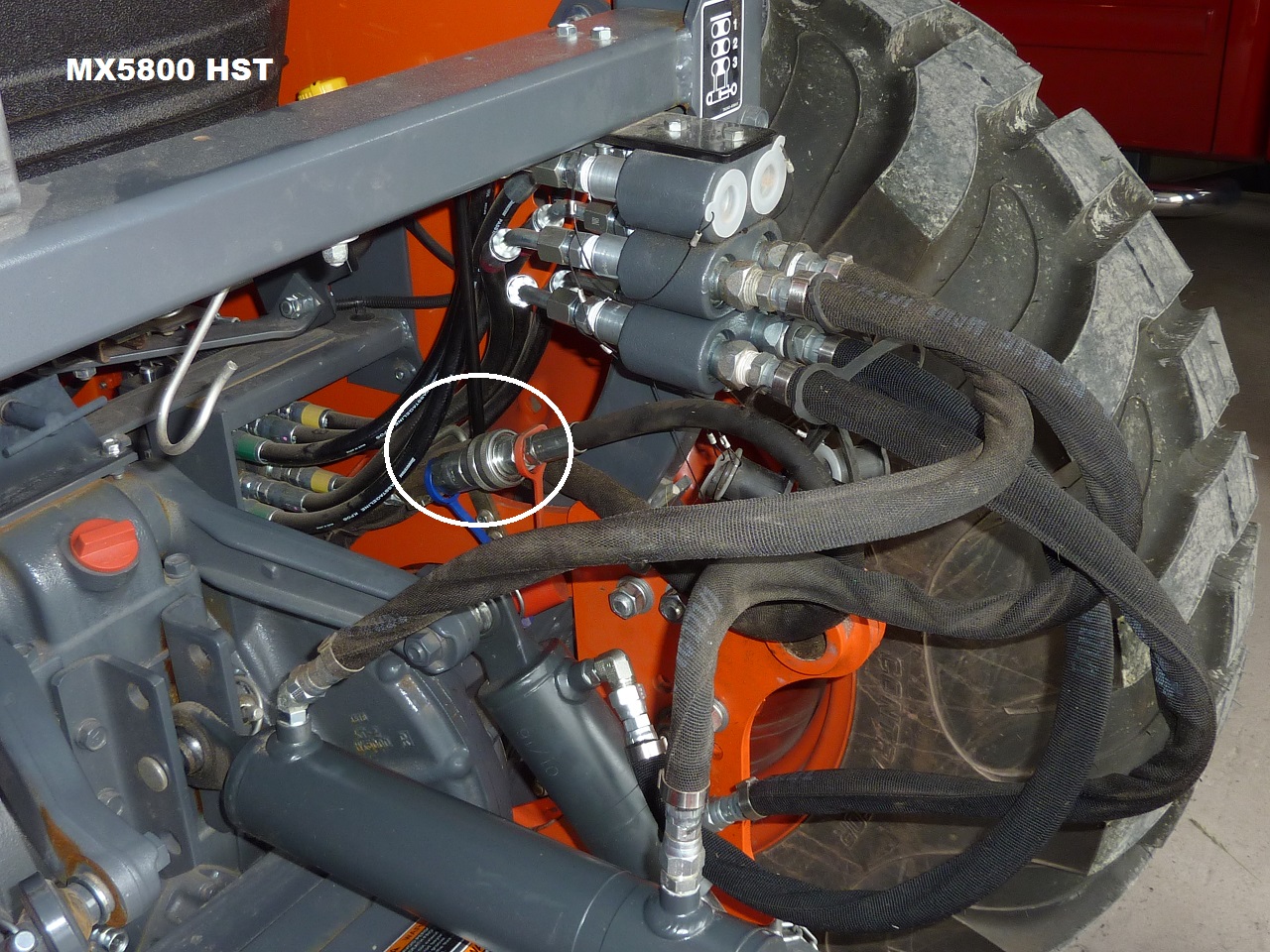

The L3430 was already equipped with a single rear remote so I used the prince valve to add 2 more. I found the extra cost of adding two rather than just one wasn't much more. I use an 8' York rake which in addition to the TNT kit, requires a third remote for the power angle cylinder. I found the three remotes to be handy enough to justify spending the $$ to have 3 OEM remotes installed on the new MX5800.
Your hydraulic circuit diagram looks like it should work but use caution when making the physical connections to avoid damage. Since I have a BH, I tapped into the hoe hydraulics to power the Prince valve. The BH hydraulic circuit is the same on the MX series as it is on the L3xxx. If you have a BH on your MX, it is easier to power the valve from there rather than go to the manifold.
