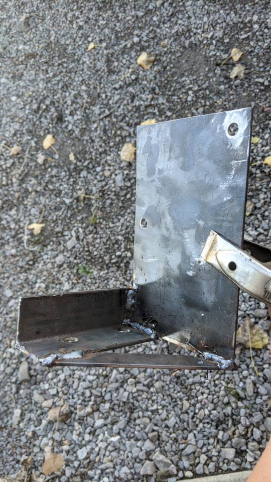

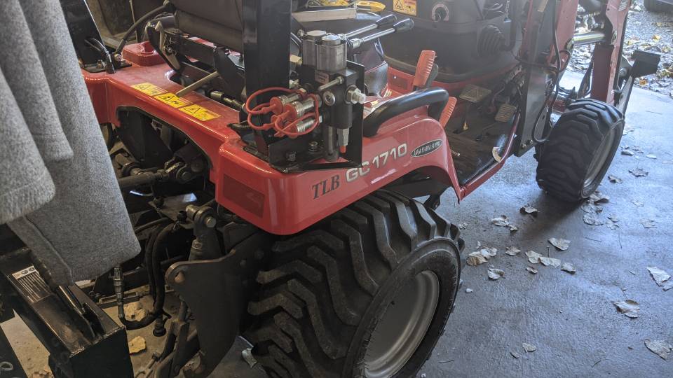

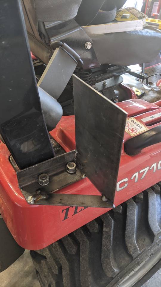

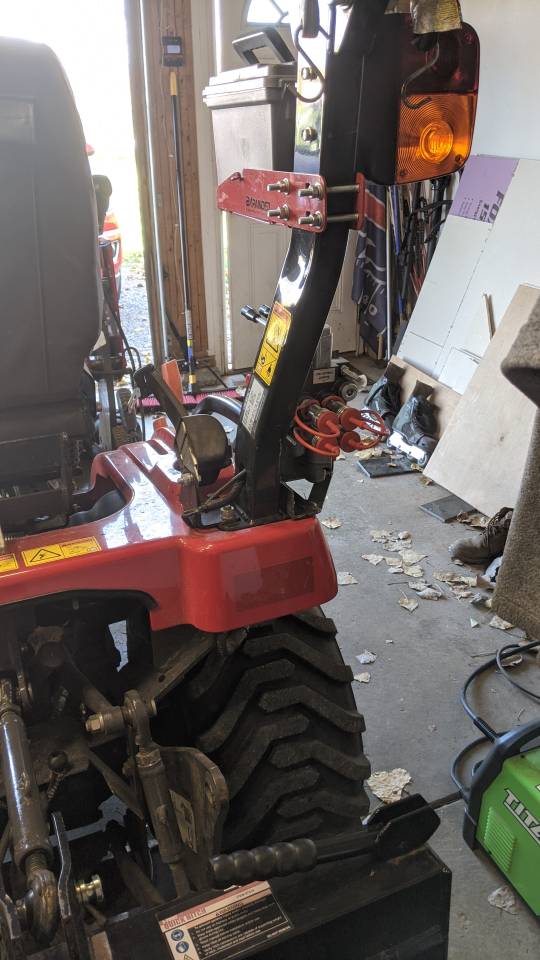

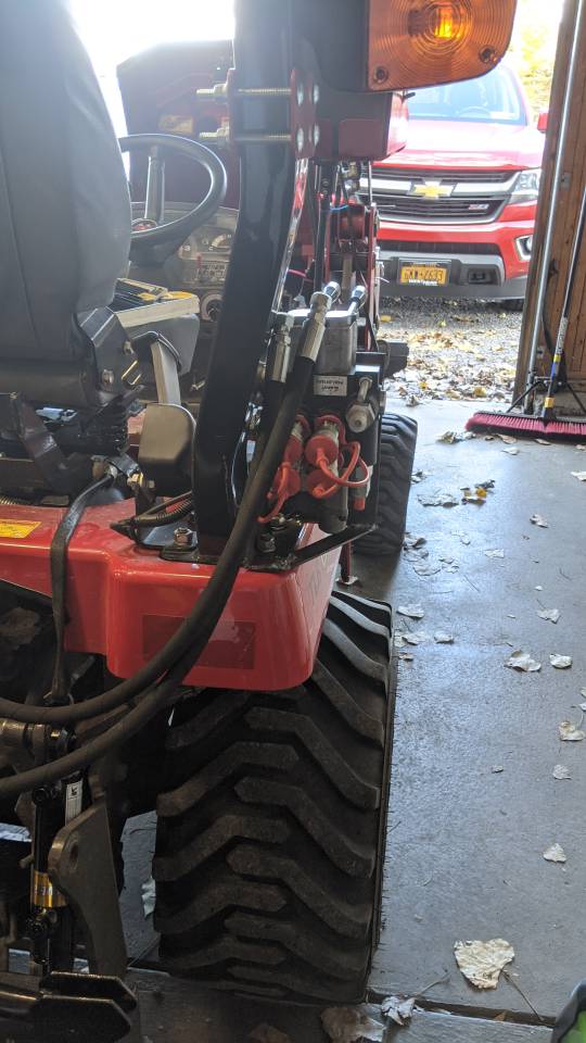

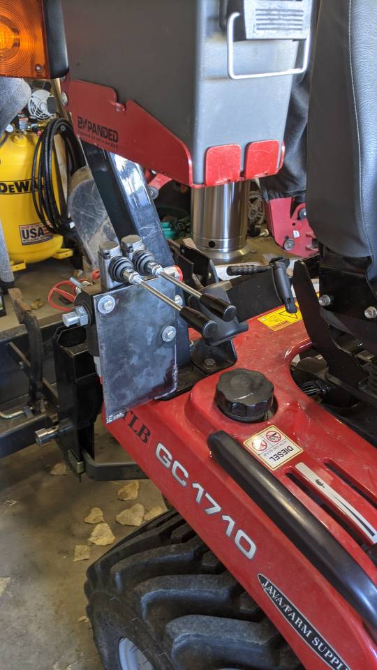

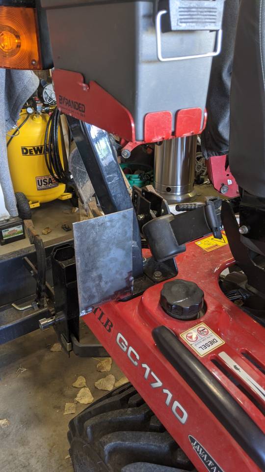

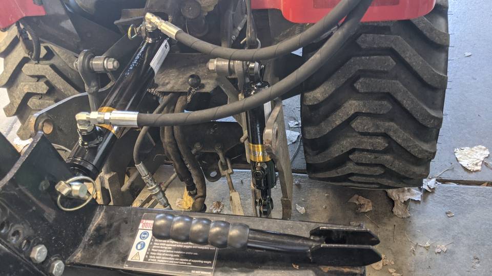

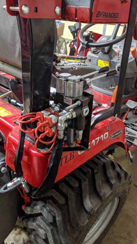

So my valve, 2 hoses, fittings, and cylinders all arrived. After moving around the valve and considering the backhoe as well as operability from the driver's seat this is what I came up with. I can roll my hand back and control the levers while driving if need be.
For the mounting plate I uses a series of 12gauge steel and 1/8" angle/bar I had around to craft it. I wanted my legs free and comfortable while operating the backhoe as well access for fuel and keeping the valve active when plugging in the backhoe. (In case I want to make my thumb hydraulic on the backhoe I could simply use this valve which is also accessible from the seat when spun).
The valve is a summit hydraulics 2 spool, 1 with float, unit. It's an open center unit with power beyond which will allow me to keep it active regardless of what's attached
The cylinders are wolverine by prince. The one for the sidelink will need to be modified to put tangs on it to operate the tilt function. All in all everything looks great for tolerances/clearances.
Now ...to order the rest of the fittings to reconfigure the plumbing and get it all working.... PXL_20201023_173225389.jpgPXL_20201023_173231856.jpgPXL_20201023_175855609.jpgPXL_20201023_181948858.jpgPXL_20201023_182006838.jpgPXL_20201023_182014843.jpgPXL_20201023_184811563.jpgPXL_20201023_184815921.jpg

Tilt was a wolverine by prince 1.5X4X1 with a retracted Length of 11.25 with swivel eyes. I feel confident that by the time I cut off the swivel eye and weld on tangs Ill be right on. Only way to know for sure is to do the work which I may get to this weekend.
At first I was concerned with how narrow a cylinder this is but after mocking it up today it's tight and I'm not sure. I could comfortably use a thicker cylinder if I wanted to.
