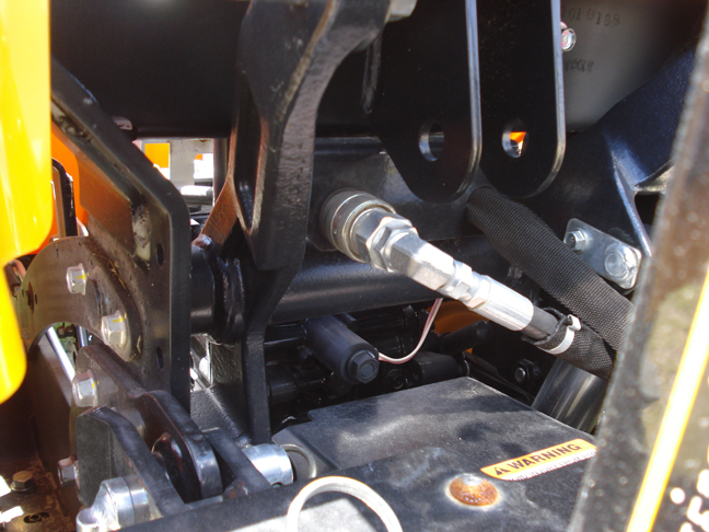

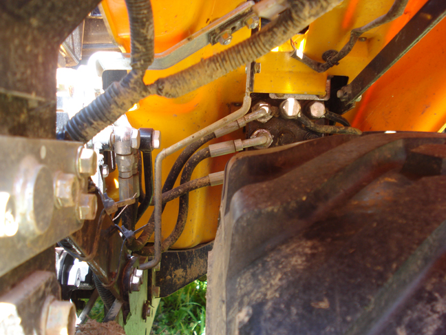

I stopped by the dealer today to look over the connections on the Sc2450 to start my rear remote project. After looking it over and taking some pictures to compare to my Sc2400 when I got home, this addition seems pretty simple. Much easier then when I first looked at adding remotes.
Looking at the loader valve, the top left port is the power beyond port.
Currently on the Sc2400 this line runs to the rear port on the control valve, the one under the seat which controls the 3-point.
On the Sc2450, this line goes to the backhoe coupler bracket under the seat that holds the coupler for the backhoe, which then is connected to the "IN Port" on the backhoe valve. This is Line 5 in the picture on page 126. The return line from the backhoe valve then connects to the rear port on the control valve. This would be the equivalent to line 7 in the picture on page 126. Since the parts manual doesn't show the lines from the backhoe in picture 126, line 7 completes the circuit. The backhoe valve is located in another section in the parts manual.
My intention is run both lines to the backhoe coupler bracket. Then from there run a line to the 3 or 4 spool valve, I'm still deciding on which to get, and back to the coupler bracket. I feel this would be the easiest way to allow me to unhook the remote valve if I decide to remove it from the tractor at some point instead of running lines directly to the remote valve.
I have to call the dealer back on Monday and have him order some differernt parts as some of the stuff I ordered I don't need now that I know how things are routed/connected. I told the parts guy I would probably need to order some other parts so he wasn't going to place the order yet. It looks to be around $100 or so for the hoses, coupler bracket, and other items. Then depending on which valve I get along with all of the couplers needed, it will probably be another $200 to $300. I picked up a JD rear remote kit for $75 off of ebay so I can use the hoses and couplers in it to hook up to the valve. Otherwise it would probably be another $300 to $400.
The picture of the valves is from the Sc2400. The other picture is the backhoe coupler bracket which is about $12 from the dealer.
