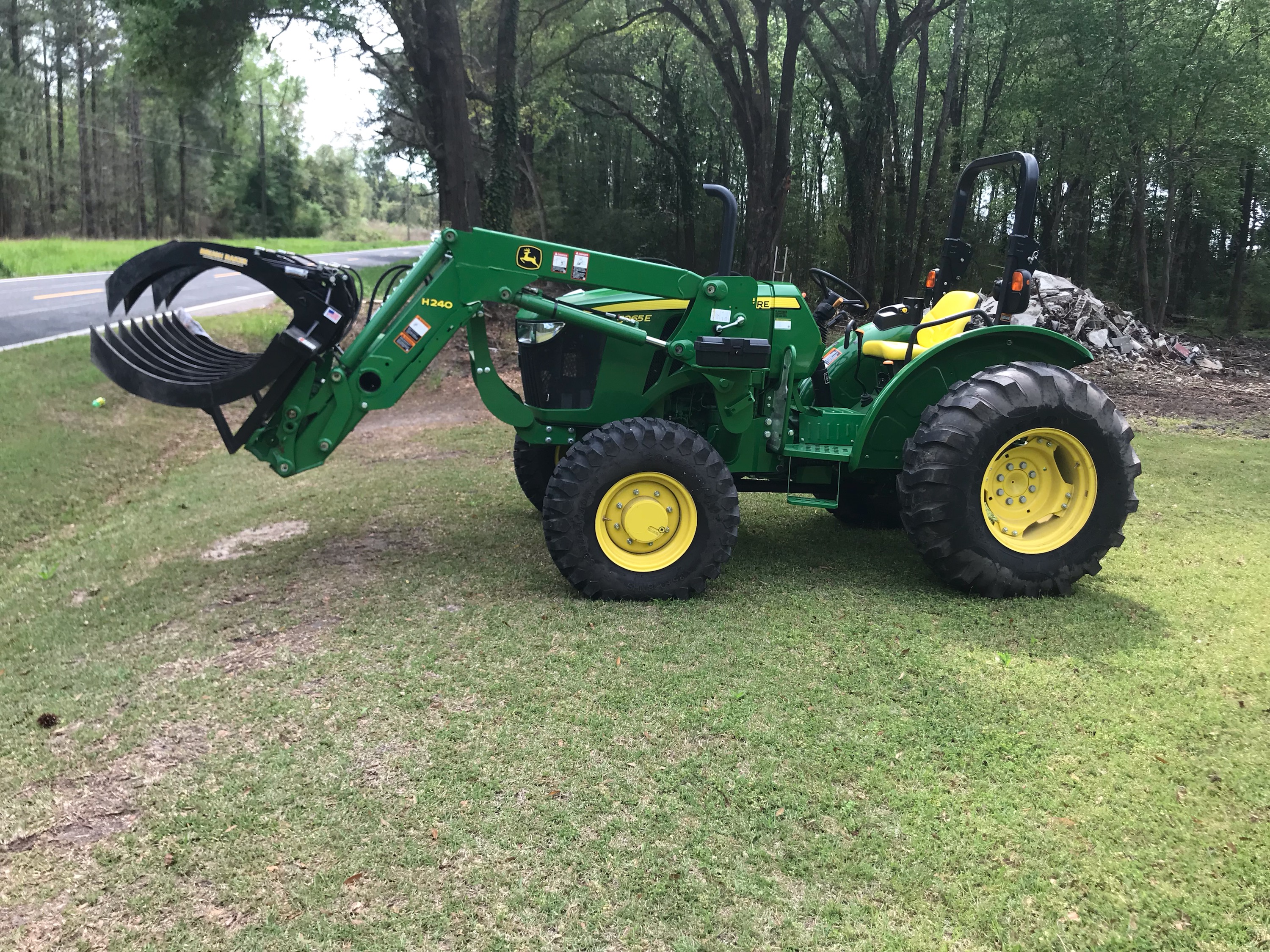

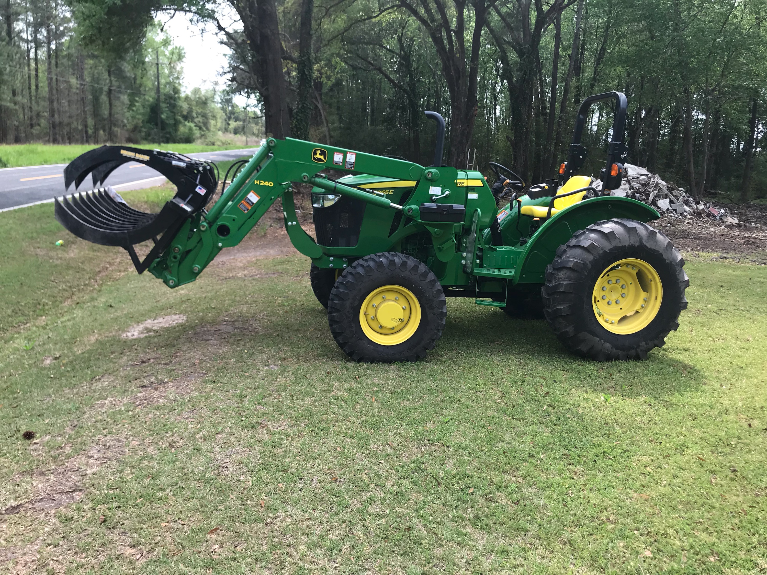

Well, the buddy that we were going to buy the tractor from just bought a 5115 (I think) and is selling us his 2017 5065e with grapple and 8' disk for $22k. Not sure of hours, but I'd imagine it is around 100 or so. Too good of a deal to pass up. Hope to get it delivered from his farm to ours this week and put it to use next weekend. Going to be a step up from our Massey 1533...lol

Our current tractor has R4 tires and I thought this one had R1, but shouldn't be an issue. Have never had an issue with the MF in our sandy soil other than going back in woods where I shouldn't have been after a good rain and the bushhog caught on a root and I got the tractor stuck. R1s would have probably made it out, IMO, but we did sink down to the chassis after trying to get out under tractor's own power. Here's a pic of the tractor...not sure if we will be able to get it to our place this week, though.
