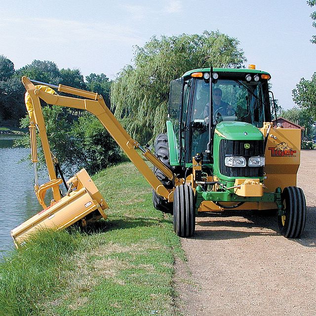

We always enjoy spending other peoples money so my entry is a boom mower. :)
