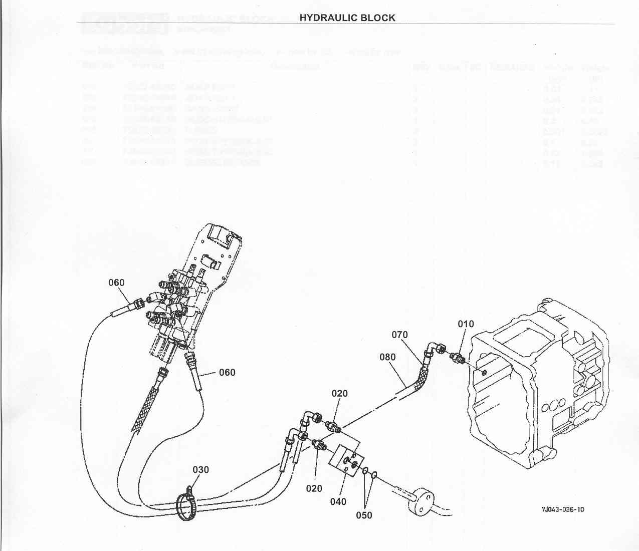

My B2910 with the FEL, also has the "quick Attach" set up for the snow blower (up and down) and the dozer blade (up, down, left, and right) that operates off the FEL valve.
It is a royal pain in the butt to drop the FEL when I want to use the blower or the dozer blade!!!!!
I have been thinking about adding another FEL valve.
Can I tap off the hyd. block (#040 on drawing) with a "T" instead of 2 adapters (#020 on drawing) and also "T" off the relief(?) (#010 on drawing) to get the valve to work?!!!!
If I do this, Will the FEL work the same, or will it be hampered by the additional valve?
Comments please!

You cannot "T" anything on the pressure side of the system. That is what the PowerBeyond is for, to plumb through another valve.

Don't have to remove the FEL to mount the snow blower or dozer blade.
The kubota quick attachment is a frame mounted to the tractor frame. Lift bucket, drive up and attach implement. It only uses the loader valve for the hydraulics. Once attached with to the loader hydraulics the loader will not lift.
I want to use the FEL to move gravel, then be able to use the blade to grade it out, But I have to keep changing the hydraulic hoses.
Rick
/ Adding Hydraulics to L3010 #24
As mentioned in a prior post, you cannot Tee of the pressure circuit. All valves must be in series. To accomplish what you want to do you need to install a diverter valve similar to what is used to run a grapple. By pressing a button on the FEL joystick you can divert the flow for a function to a different set of cylinders. If all you need is one function then this is easiest way to go.
If you need 2 functions then you might want to investigate the cost difference between 2 diverters and a seperate 2 spool valve.
BTW, the B2910 post should have been placed in it's own thread instead of hyjacking the L3010 thread.

Your dealer should be able to supply you with the Kubota part numbers for the aux valves (the post I mentioned earlier had those numbers). The 3010 has an aux hydraulic outlet that is seperate from the loader outlet and is designed for the remote valves that Kubota sells as an option. There is no adapter block available.
However, at least one person here on TBN has made his own adapter block for a Grand L series Kubota. The machining methods would be similar if you wanted to make one for the 3010. There was a post on this about a year or so ago.
If you don't want to spend big bucks for a Kubota valve that bolts right to the tractor then you can simply connect to the loader's power beyond. It's done all the time by people who don't want, for whatever reason, to purchase the Kubota valve kit.
