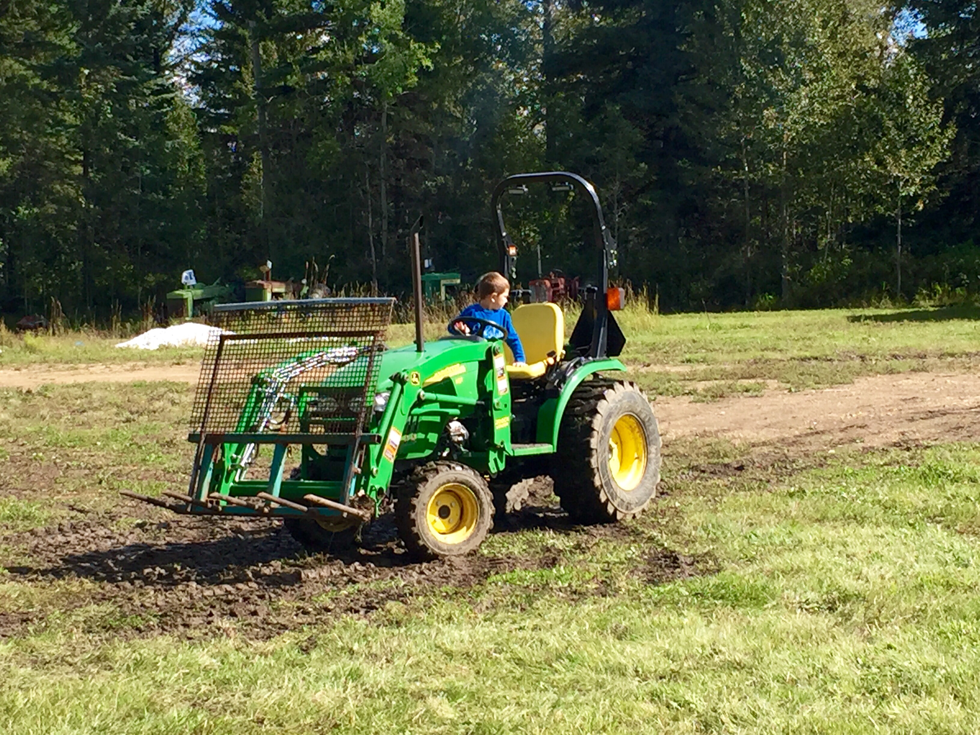

When I first bought my tractor the ROPS was so tall it was always hitting branches and wouldn't fit under the storage roof at the house. After folding up and down for awhile i realized it was more down than up. Then the 3ph top link hit it a time or two. I figured if I'm going to have something it may as well be used or just take it off. I cut it off right above the hinge, cut out 8", sleeved it and welded it back together. I think I may have only had to fold it a few times in the years since and I have never once worried about it. To the OP I wouldn't hesitate to cut and put in a hinge if your decent with a welder or know someone that is. Try to keep the hinge as high as possible so even folded it still provides some protection, and so when you fold it the top portion doesn't interfere with any rear implements. As far as capping I don't think it matters either way as long as the water can drain out the bottom. I 100% believe in safety but common sense and practicality need to be used as well. Moderation in EVERYTHING is the key. IMG_3397.JPGIMG_0123.JPG
