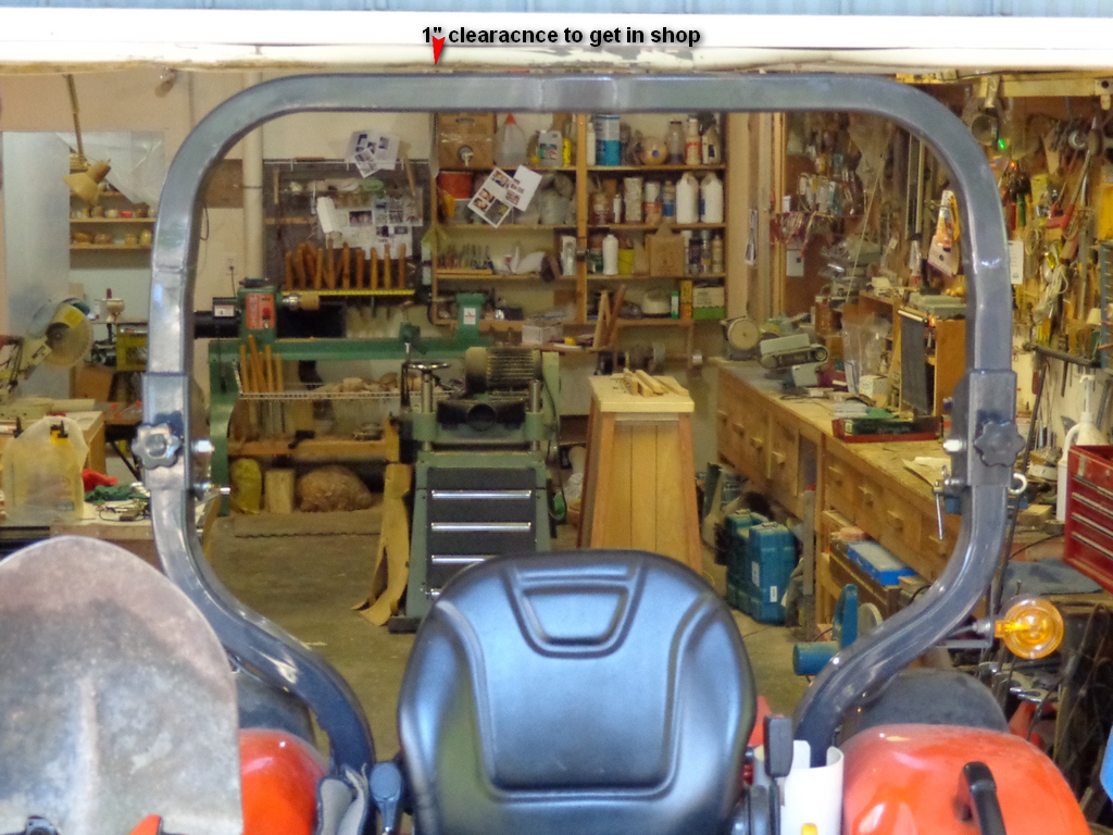

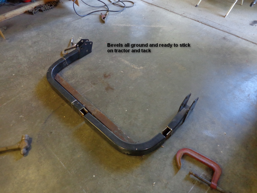

To the OP: I shortened my foldable ROPS many years ago so I could park inside my workshop which only has
an 8-foot door. My general rule is to use steel that is as thick or thicker than the original ROPS bar. This is not
an airplane, so you ARE allowed to change things. Or even buy a tractor with no ROPS at all.
