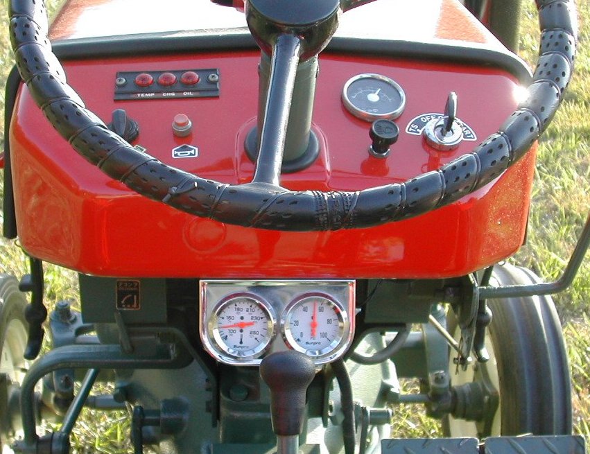

I installed them in the "front of the dash", but turned a few of the gauges so I could read them from the seat. If anyone would like to see pics, I'll try to remember to post some tonight.

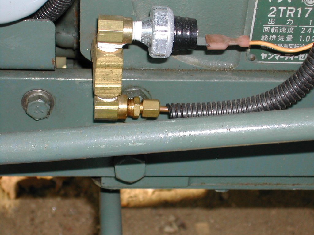

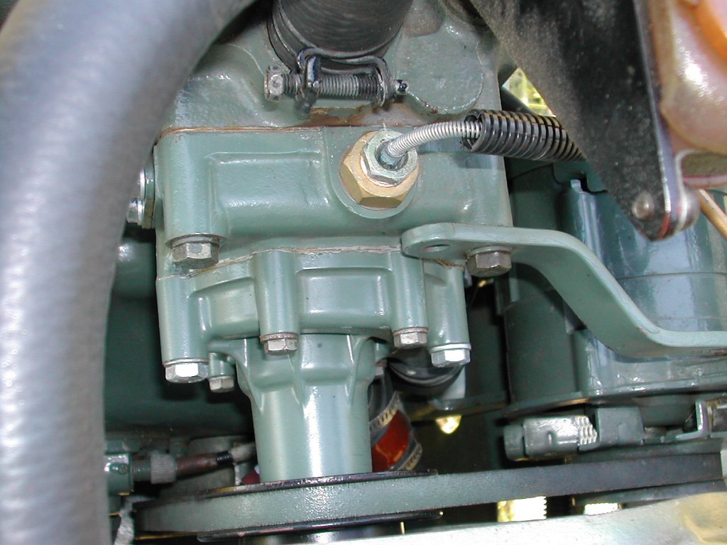

While there are many methods and gauges that will work, here are the parts that I used to install oil pressure and water temperature gauges on a YM1700.
Water Temperature Gauge: Sunpro CP8207. Requires metric adapter (16mm x 1.5mm), which is included in Sunpro kit CP7574.
Oil Pressure Gauge: Used Sunpro oil pressure gauge. Requires 1/8-28 (BSP) to 1/8-27 (NPT) adapter, which was included with the gauge kit. This adapter is also included with Sunpro kit CP7573.
If you decide to install a "T" fitting for the oil pressure gauge, you will need a 1/8" NPT "T" fitting, 1"x1/8 NPT close nipple, and a new Oil Pressure Switch with 1/8" NPT threads. I used a Sorenson OPS7, 3-9 psi, available at Advance Auto.
I chose to install the gauges under the dash primarily because it was easy. While most of these parts were available at Advance Auto, I did have to order the metric adapters online at www.sunpro.com. However, I have since seen the metric adapters at various auto parts stores.
Will post pictures tonight.

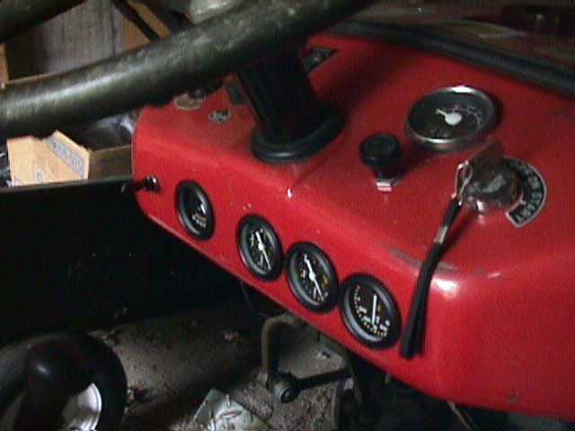

Here are the pics of the gauges I used. Bought an inexpensive set at Wal-Mart and threw the mounting bezel away. They are the smaller 1 1/2" set. Cut holes in the dash with knock-out cutters that electricians use. The set had only 3 gauges, so I called the manufacturer and bought the 4th one through their service department.

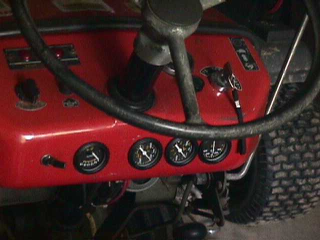

   / Adding Guages To your Yanmar #6
I too had to get a metric fitting from Sunpro to make one of them fit, think it was the oil pressure line.

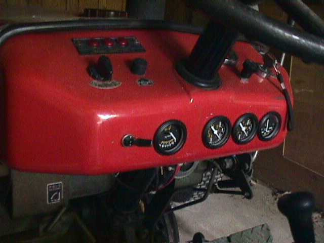

   / Adding Guages To your Yanmar #7
Since I am a little tall, I had trouble seeing the needles when they moved into the operating range, so I twisted them around like Nascar drivers do /w3tcompact/icons/laugh.gif, so I can see where the needles are.

   / Adding Guages To your Yanmar #9
Here is the water sensor with metric adapter.
   / Adding Guages To your Yanmar #10
....and last, the oil pressure Tee fitting.
