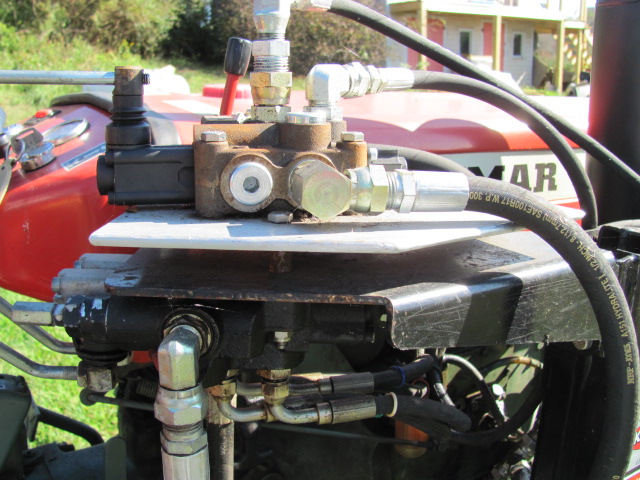

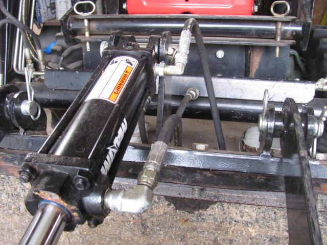

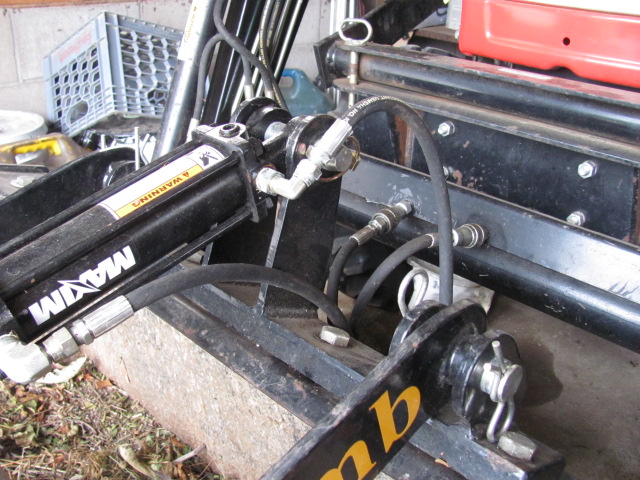

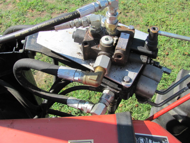

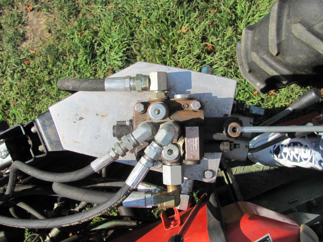

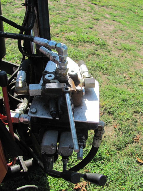

All right, I'm gonna weigh in here. I must confess though, all the three point talk and parallel whatevers? They have me lost!!! The reason I haven't thrown in my two cents is that it sounded like your system was different from mine.
I can tell you what I did. I contacted Koyker, where they were nice enough to sell me a power beyond plug. Once I understood the basic mechanics of it (which took me WEEKS) it was easy. (thanks J.J.:)
The supply to the grapple valve comes from the power beyond plug from the loader valve. The operating lines go from the grapple valve to the grapple, and back to the grapple valve. The used hydraulic fluid goes from the "out" plug in the grapple valve, and tees into the hydraulic return line. It's that simple.
In the photos, you can see how I made an aluminum plate to fit over the existing loader valve, and you can see the "feed" line going from the power beyond plug in the loader valve to the grapple valve (which is the upper of the two).
So....the grapple valve is being fed from the loader valve on the left side in the photos, and the "used" hydraulic fluid exits the grapple valve from the right side of the valve, where it "tees" into the return line from the loader valve.......
All the plugs, lines, grapple, and grapple valve cost around $1,000 (!!!!!!)

thanks for the pics.. nice work :thumbsup:.Your loader valve is a dual stick. mine has single but, should be ok. I'm in at $580.00 with valve & grapple.

The lines and fittings add up QUICK!!!!!! It was very difficult finding all the right fittings.....I had to go to a local place to find a couple, and they weren't quite as cheap as Surplus Center!!!! While I did have a problem or two w/Surplus Center, they stood behind their name when the chips were down, and did the right thing. Good outfit.
Are you going to be plumbing yours the way I did mine? With a power beyond plug?

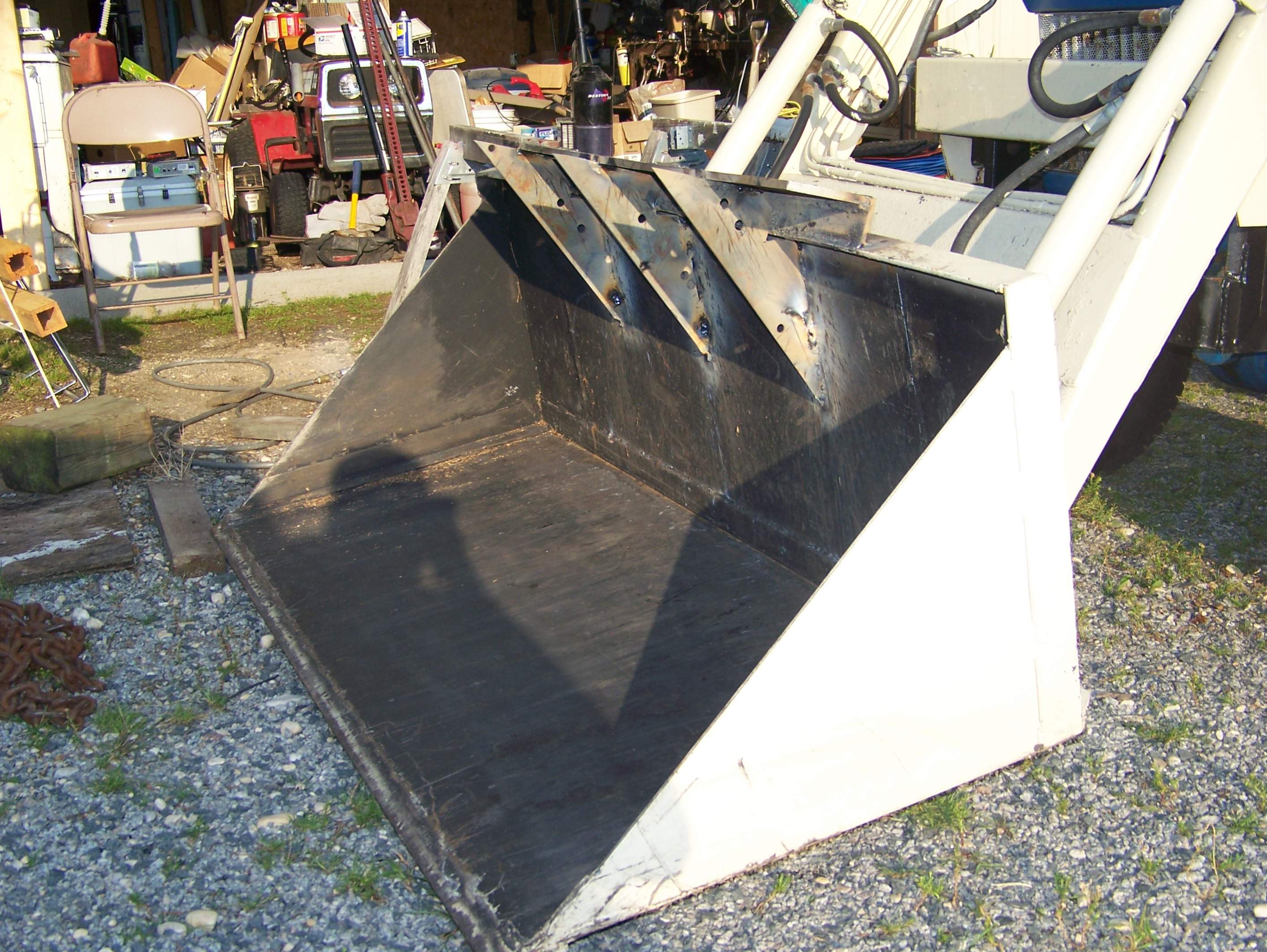

BTW, get a really strong piece of iron to bolt onto the top of your loader bucket along with the grapple. If you don't, the top of the bucket will bend like a pretzel, no matter how strong you think it looks:eek::eek::eek::eek::eek::eek::eek::eek::eek::eek::eek::eek::eek::eek:

I'm going to weld 3 -4 gussets inside the bucket to support the top.I hope this will be enough. PB will supply the new valve. The PB from the new valve will supply the 3 PT. I have made seprate return to sump line so, both outlets can return to sump

Ok, here's the other photo you requested:
Like this? :thumbsup:
Joe
